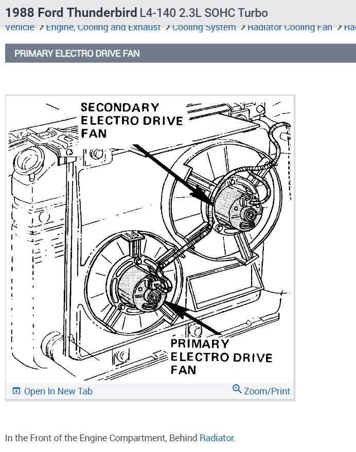

I have replaced the water pump and thermostat. Changed all fluid. Car is still over heating, and both fans work. The hose coming from the thermostat does not have much pressure. What is left?

It sounds like the radiator is clogged but to be sure please go over this guide and let me know what you find. Also how long does it take to overheat?
