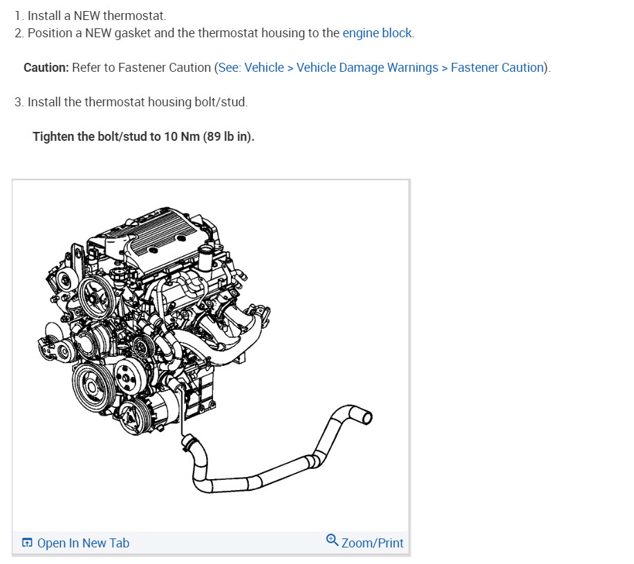

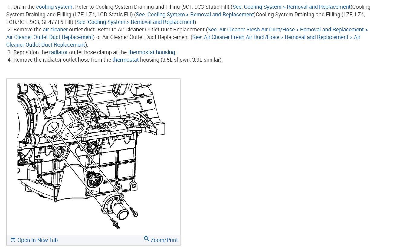

The car is overheating and the fans are not working. Replaced temp sensor and fan relays. Could it be bad thermostat?
Aug 12, 2022 at 1:02 PM
  • 55,691 POSTS

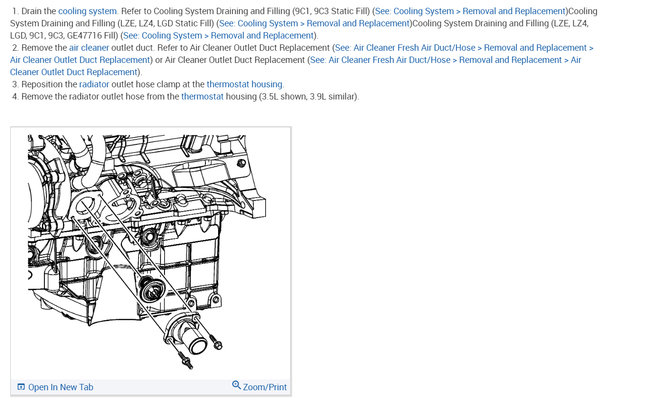

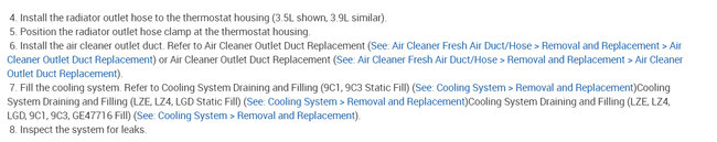

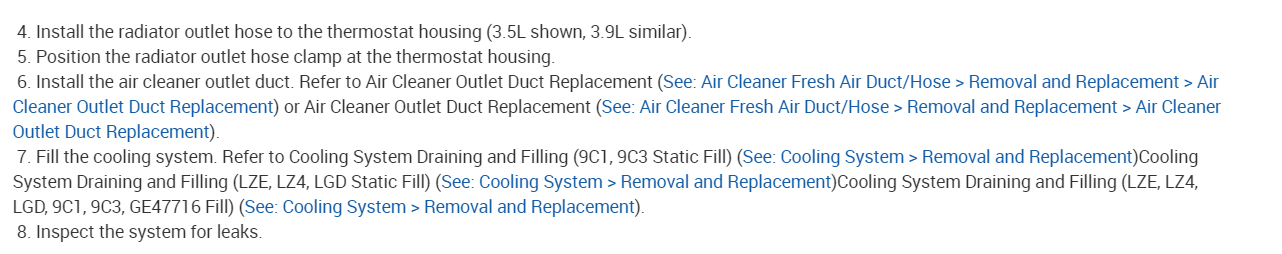

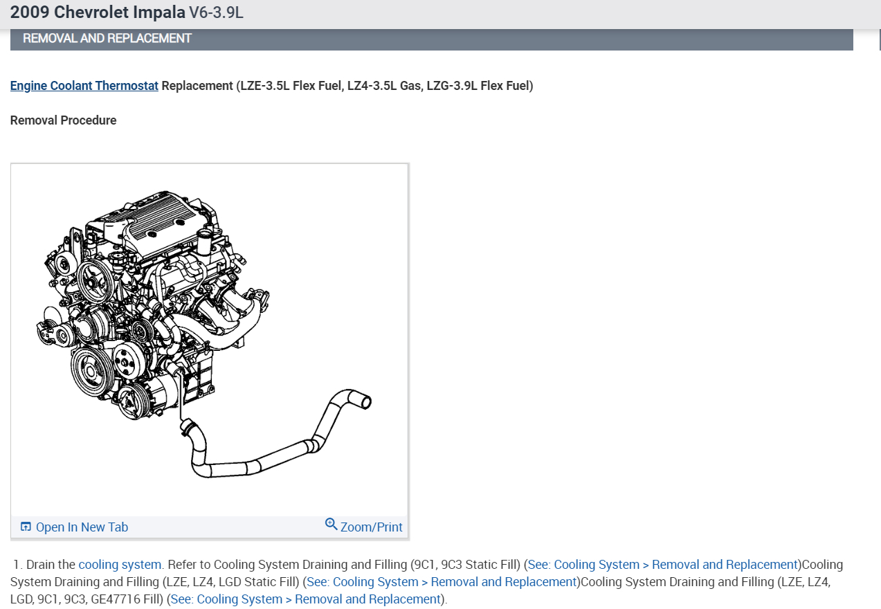

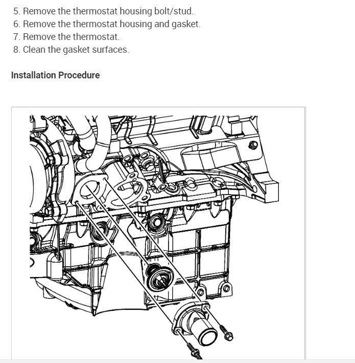

Yes, it could when the engine is overheating do you hear a thumping noise? This is a sure sign the thermostat is stuck closed. Here are two generic guides to help with the thermostat location and how to change it out in the diagrams below:
