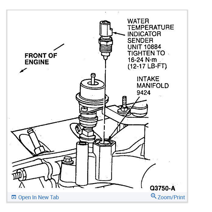

My car decides to overheat when i am on the pedal, as soon as i let go of the gas it lowers back down to normal. I have changed the radiator, the water pump, and thermostat, and bled the coolant system. do you thing a bad engine coolant temperature sensor would make this problem happen?

I have seen a bad connection at the engine coolant sensor cause this problem. here is the location so you can check it out. If the connection is good replace the sensor. Check out the diagrams (below). Please let us know what happens.

The sensor was bad. but once i drove it, it drove fine but after a while it started overheating again.

I bad fan clutch can cause this as well. here is a guide that will walk you through the replacement:
