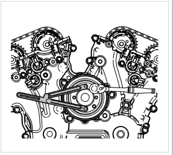

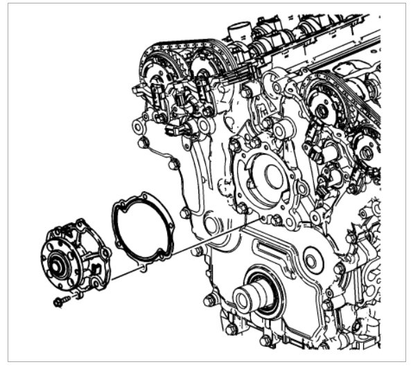

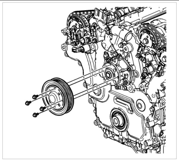

My vehicle blows lukewarm air at idle but heats up nicely when revved or driving. Then I noticed the temperature gauge heats up to the red area after idling and drops down when I give it gas. The fans are working fine, and I flushed the heater core with no change. Fine while revving/driving. No cabin heat at idle.
Feb 2, 2018 at 9:57 AM
  • 55,548 POSTS
This sounds like you have a coolant pump impeller that has fallen apart not circulating engine coolant like it should. Here is a guide to help you see what you are in for when changing the pump out:
https://www.2carpros.com/articles/water-pump-replacement
Here is how it will be for your car (below).
Check out the diagrams.
