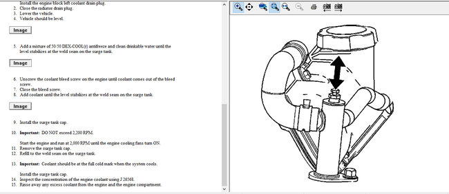

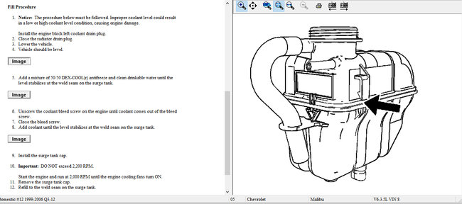

I have the car listed above Maxx with a 3.5L and I noticed I kept smelling coolant burning, after replacing hoses it came out to be the water pump. Once the pump was replaced it was fine for 30 minutes before it started to struggle, when I looked at the temperature needle it was all the way in the red. It wasn't doing this before the pump was replaced and it will overheat while idling. I'm not sure what could have caused the sudden change in the temperature after getting a new water pump.

It sounds like air trapped inside the cooling system, you must bleed the coolant after pump replacement.
check the procedure and the bleed screw location at below attachments.

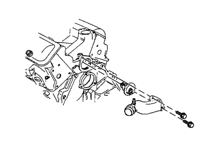

I would replace the thermostat to start. It may be stuck closed.

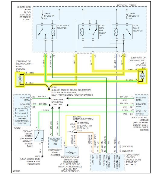

The fan not working may be causing it to overheat at idle. Can you see the fan come on?
https://www.2carpros.com/articles/how-an-electric-cooling-fan-works
It almost sounds like air in the system. I would remove the cap and run the motor at 1,200 RPMs. Watch the coolant level and add as needed. When you get heat in the car, the air is gone.

I attached a wiring diagram of the cooling fans for you in case they are not working.
1. Drain the cooling system.
2. Remove the air cleaner outlet duct.
3. Disconnect the surge tank hose from the coolant outlet.
4. Remove the thermostat housing to intake manifold bolts.
5. Remove the thermostat housing outlet and thermostat.
