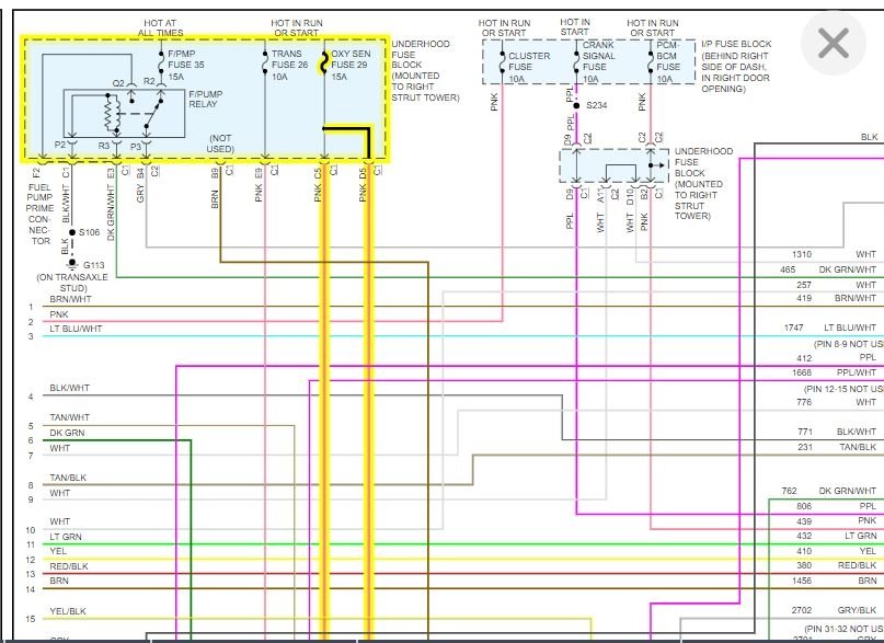

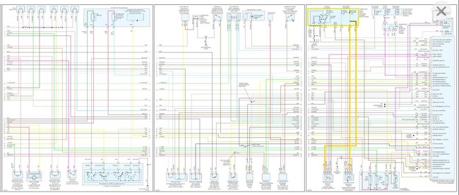

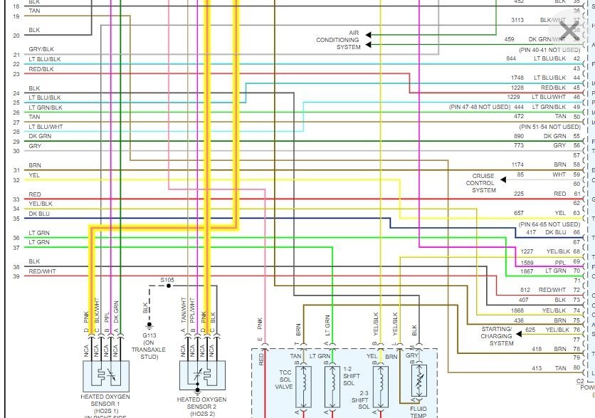

134,135 are for the heated O2 sensors. This could be a wiring issue to the sensors. Check the diagram I attached.
Check the fuse listed for the O2 heaters.

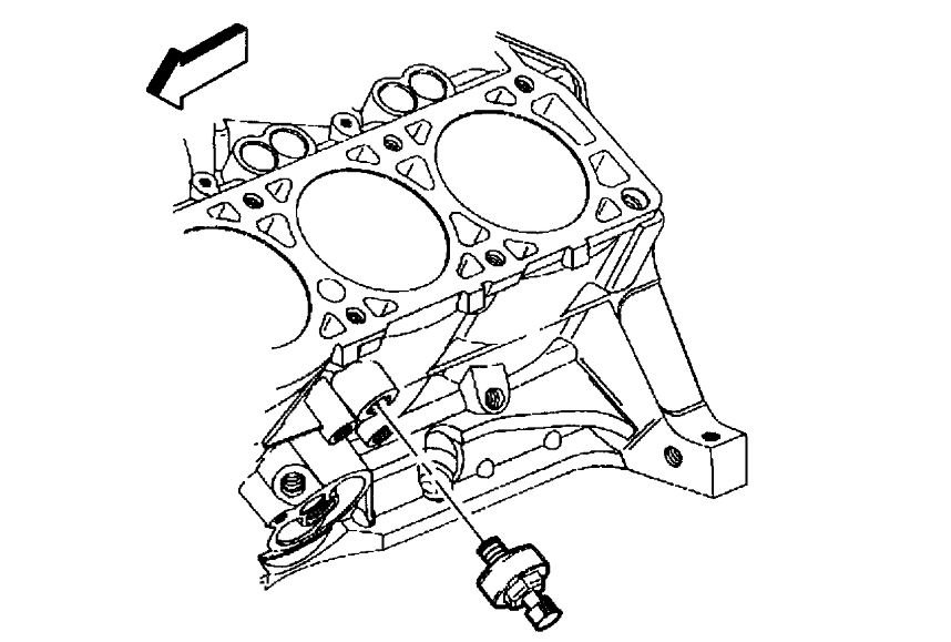

I attached a location of the knock sensor.
327 is for the knock sensor.
