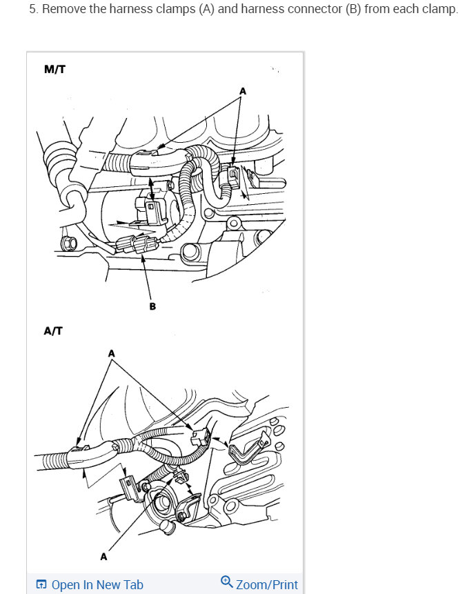

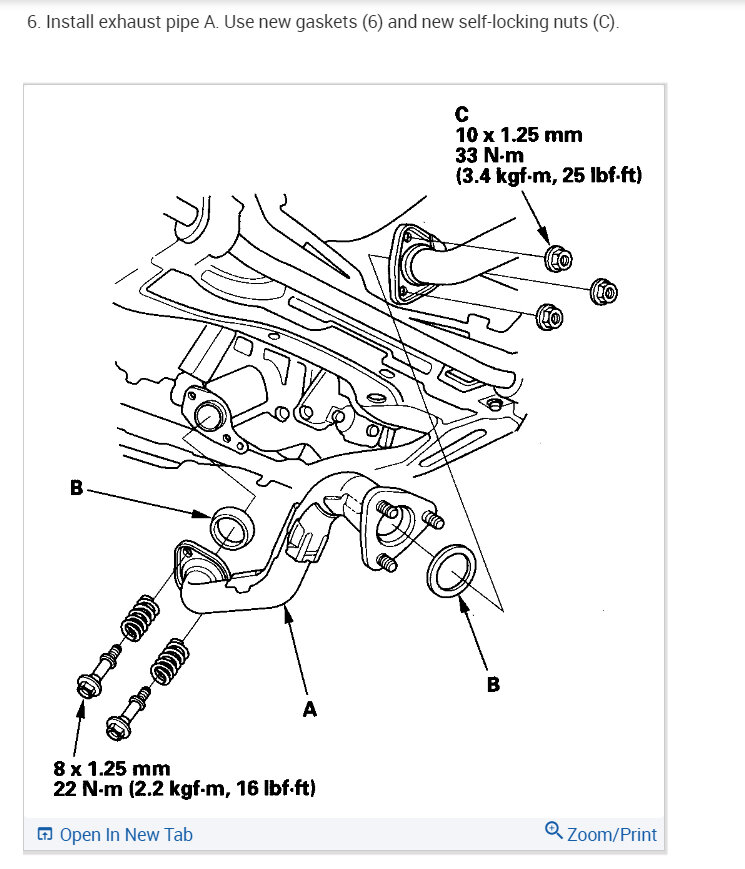

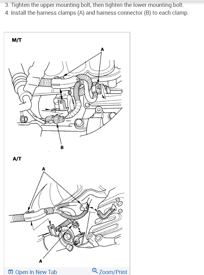

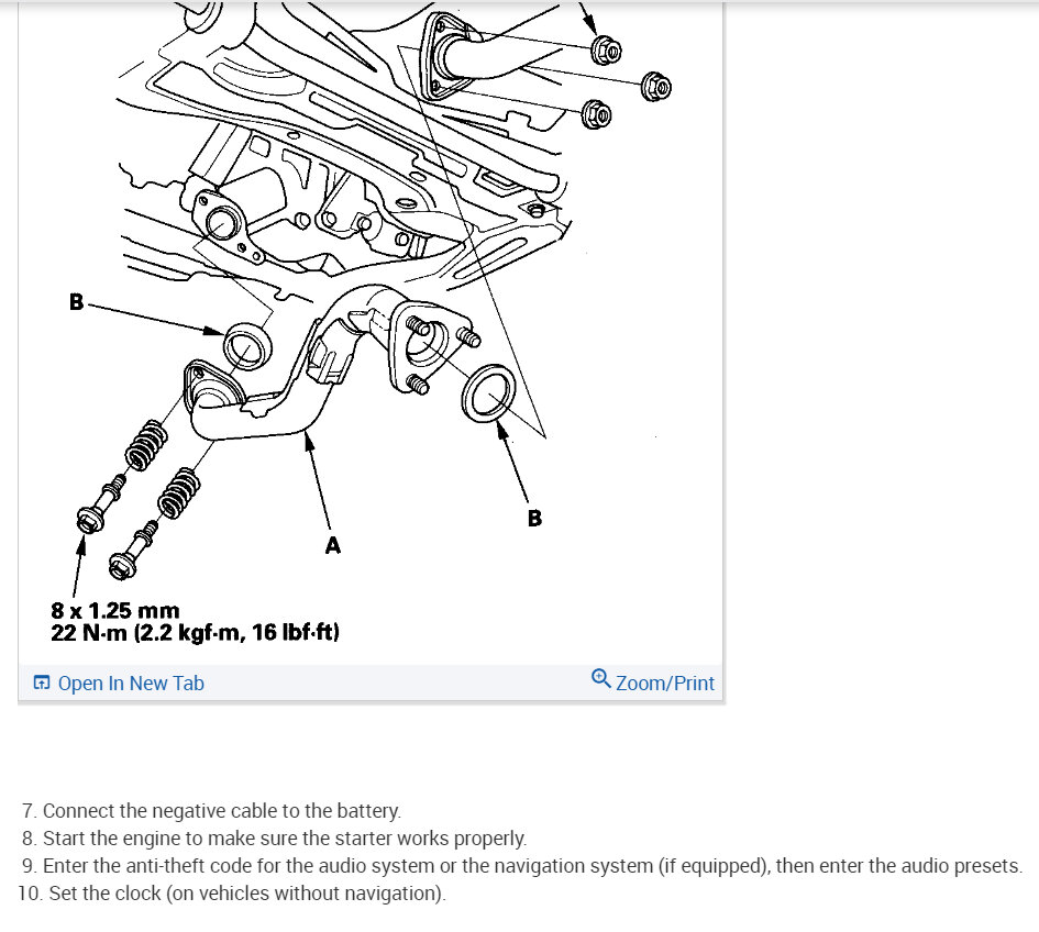

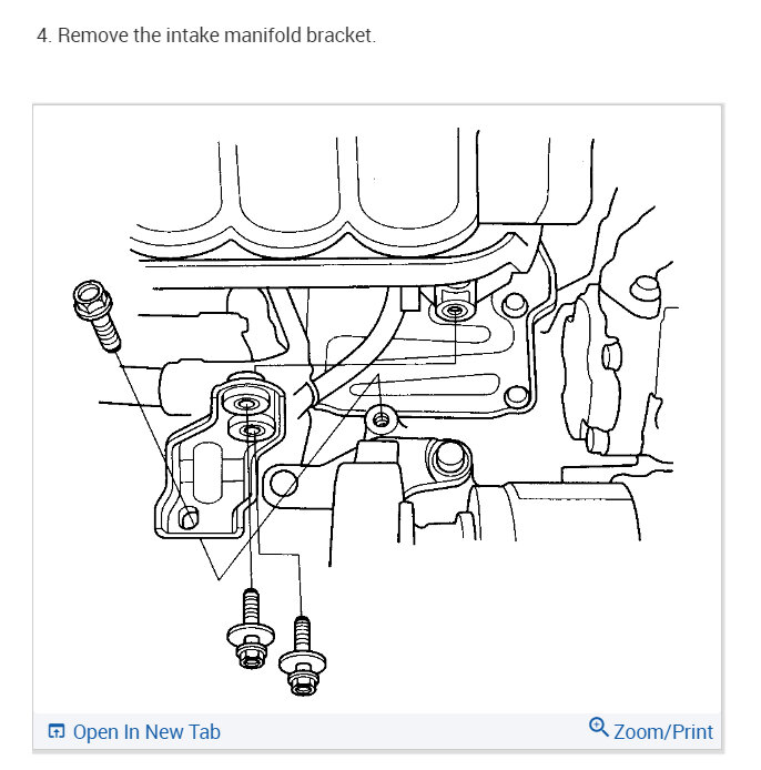

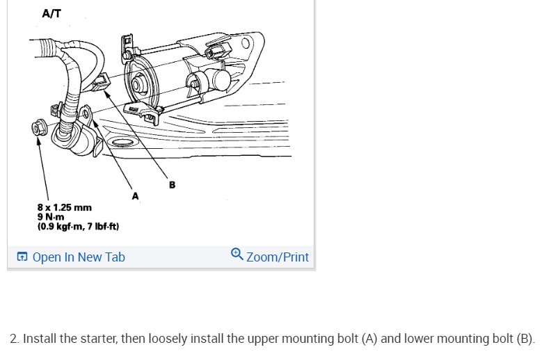

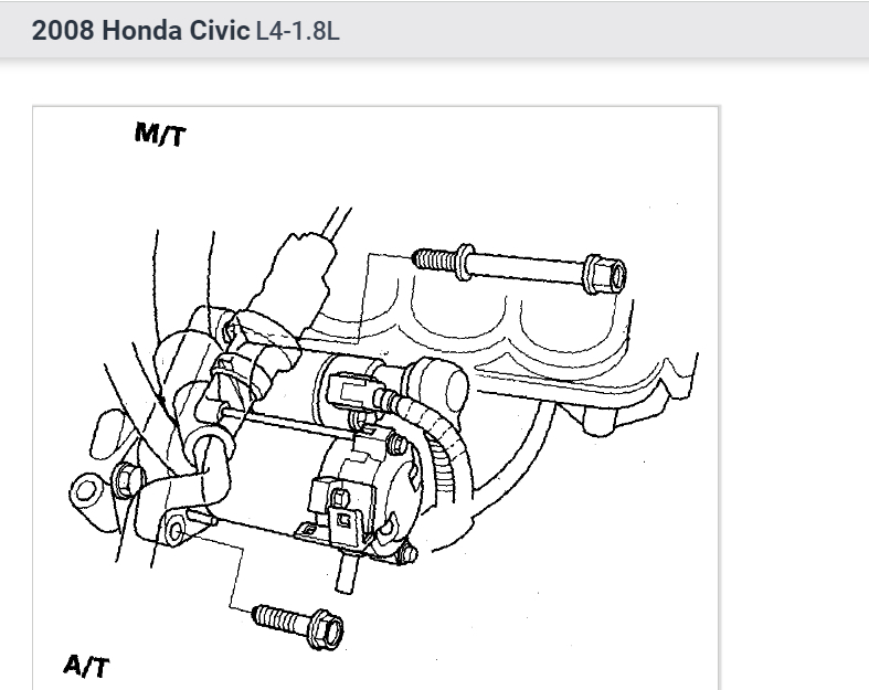

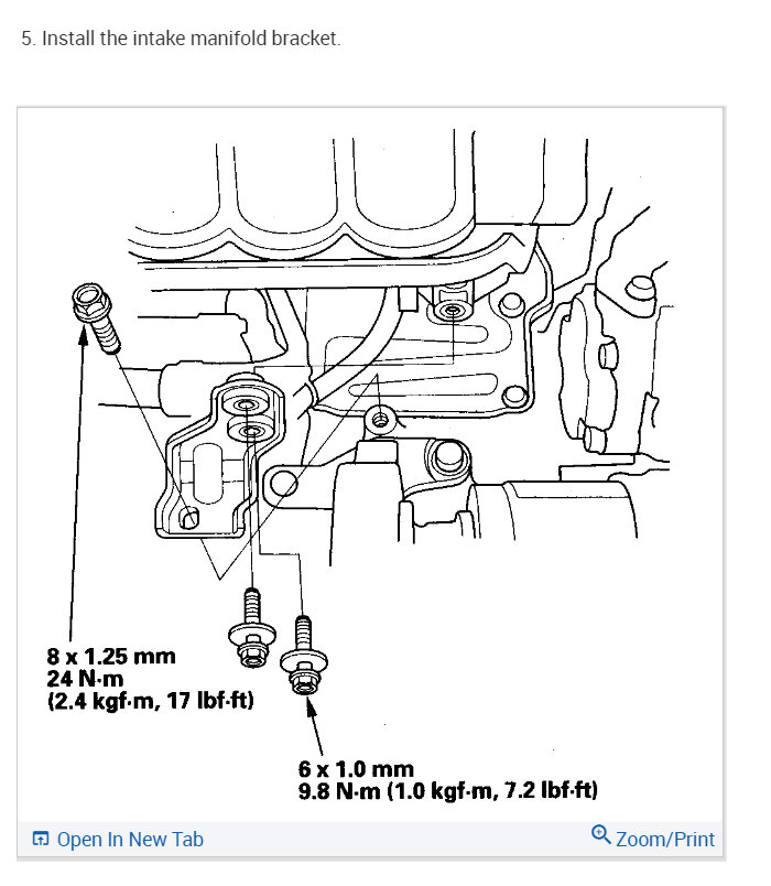

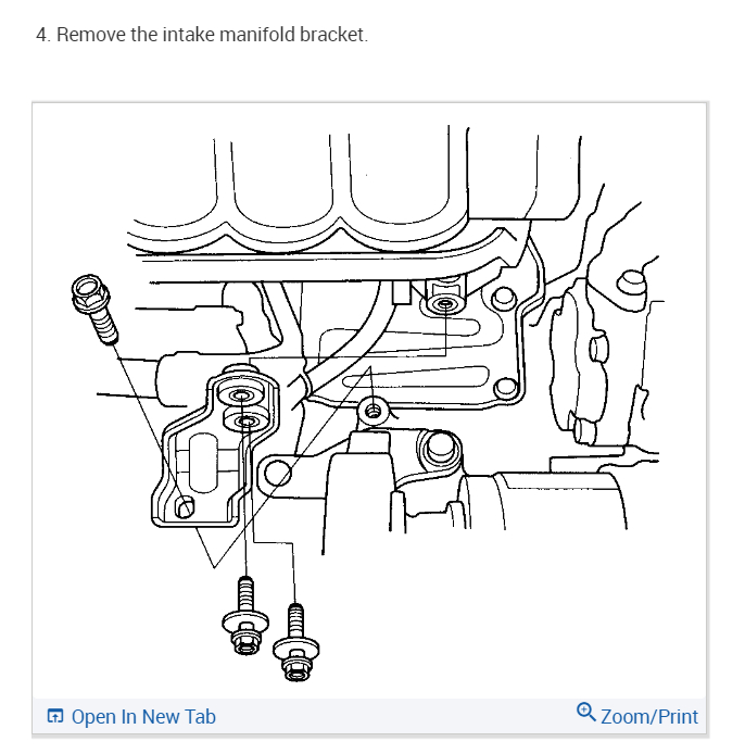

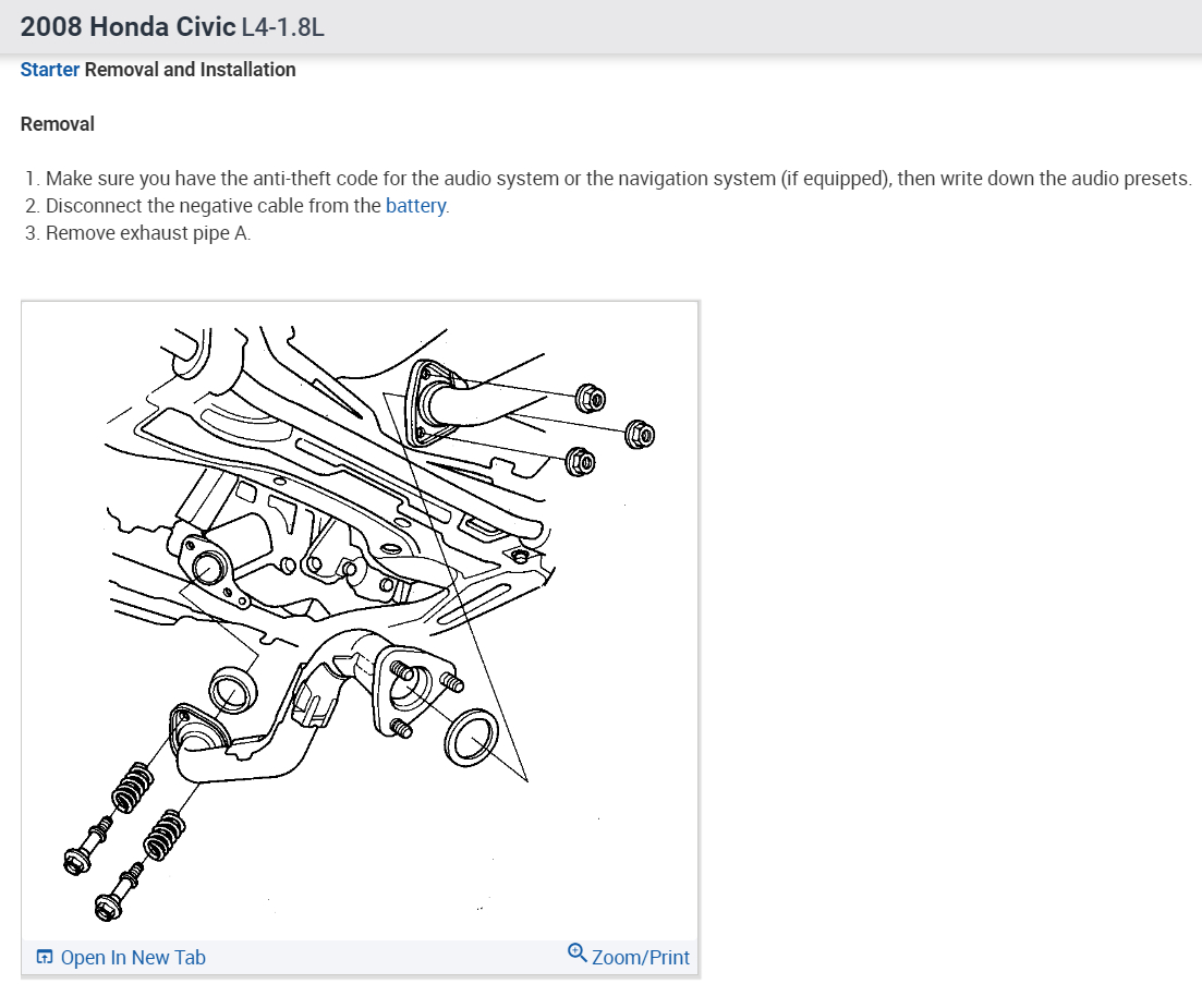

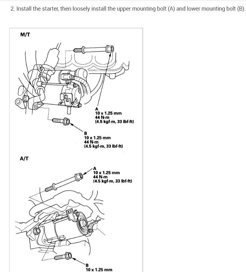

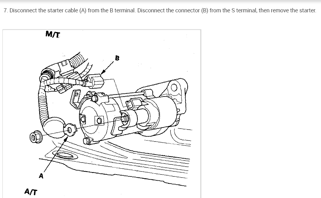

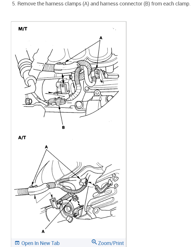

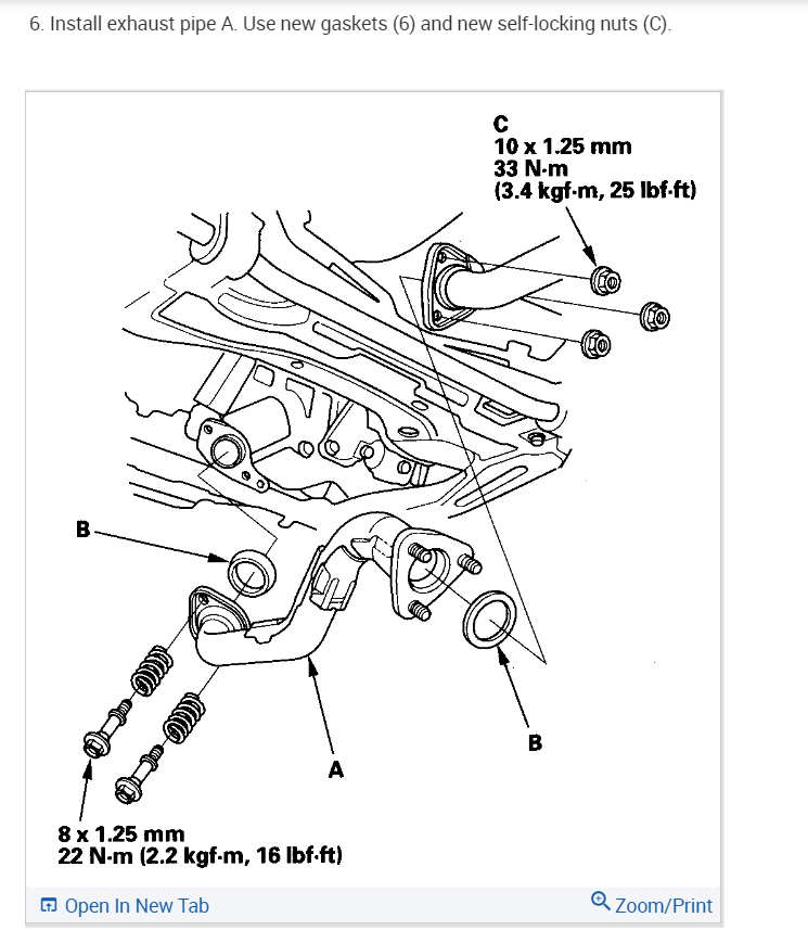

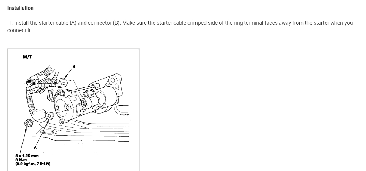

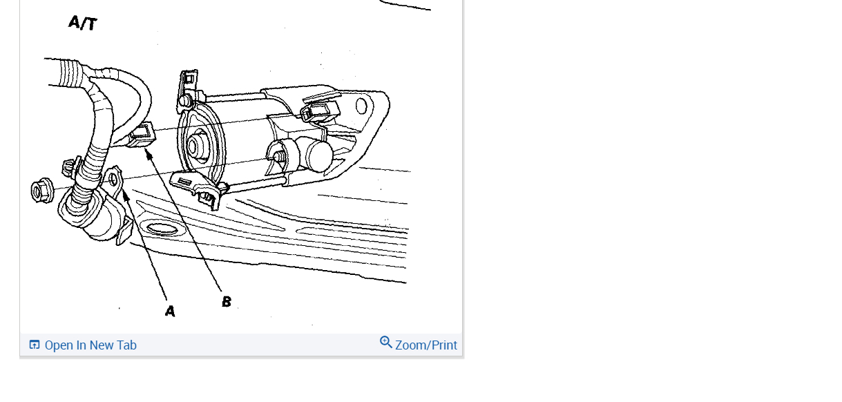

Yep, starter failures are common, to be sure let's see if you get power at the trigger wire for the starter, this guide can help us:
Here is how to change the starter out in case you need it. If the trigger wire is getting power in the crank position the starter is bad and needs to be replaced.
This guide can help walk you through the steps of the starter replacement and I have included instructions for your car in the images below:
Check out the images (below). Please let us know how it goes

Hi Ken, forgot to update you, it was the starter, I was able to check it one of the times it didn't start by hitting it with a hammer a couple of times then it started up, since it is hard to reach the terminal to check for voltage. I replaced the starter, and it started right up so it's good now. Replacing the starter didn't take too long but the bolts are hard to get at and you need a combination of u-joints and extensions. Thank you.
