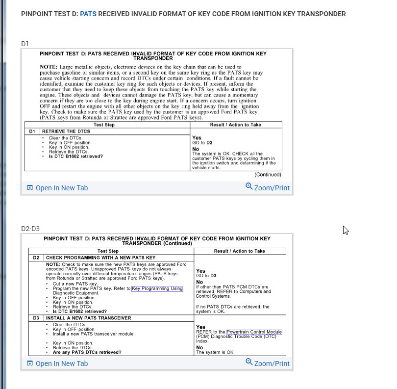

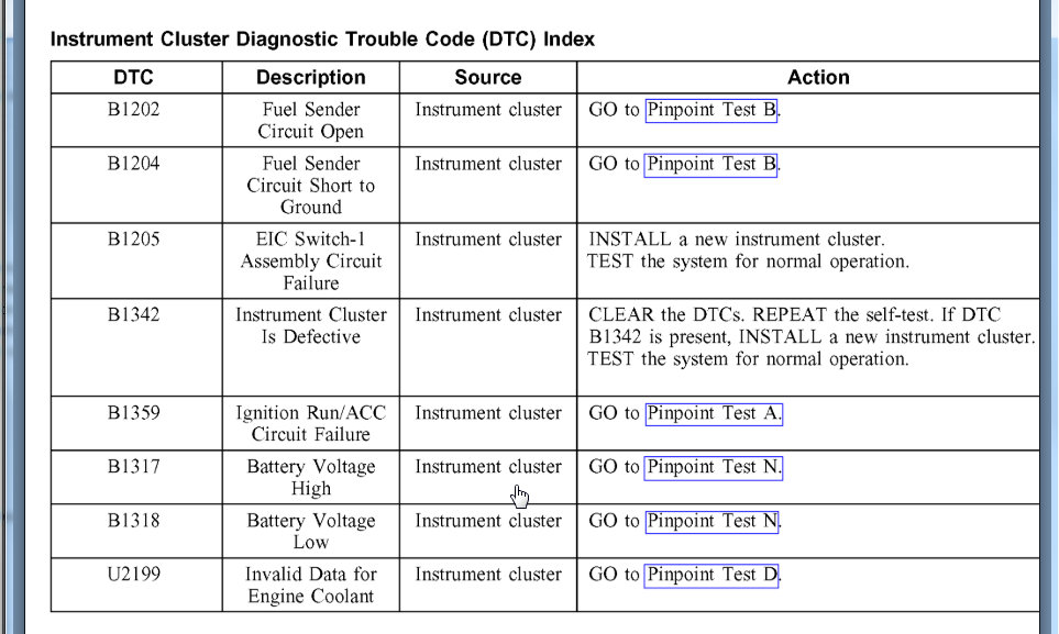

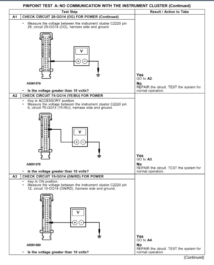

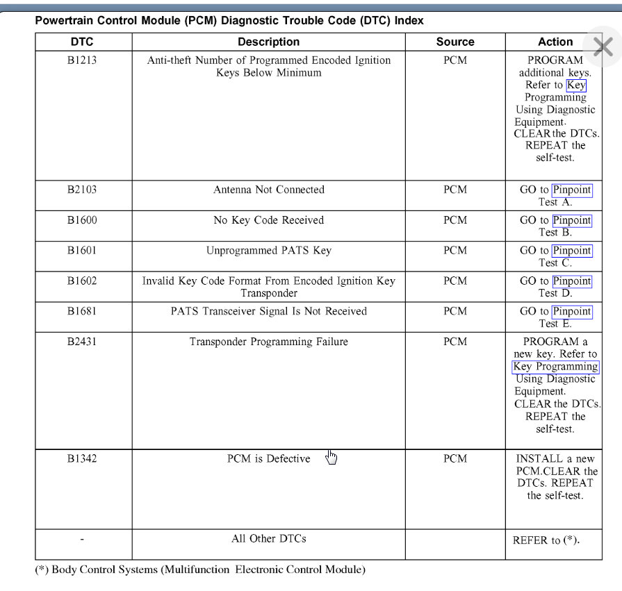

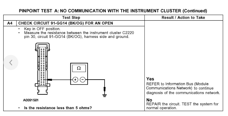

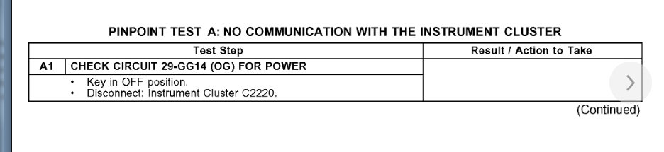

Hi Guys,

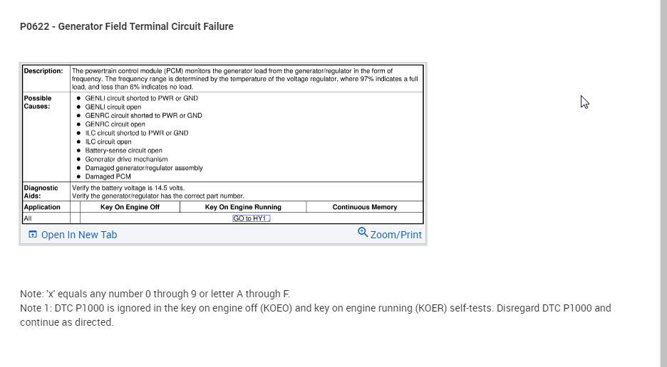

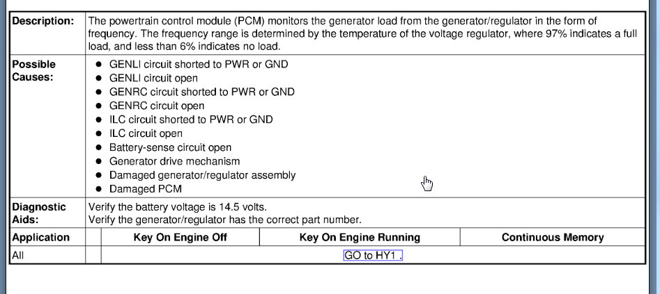

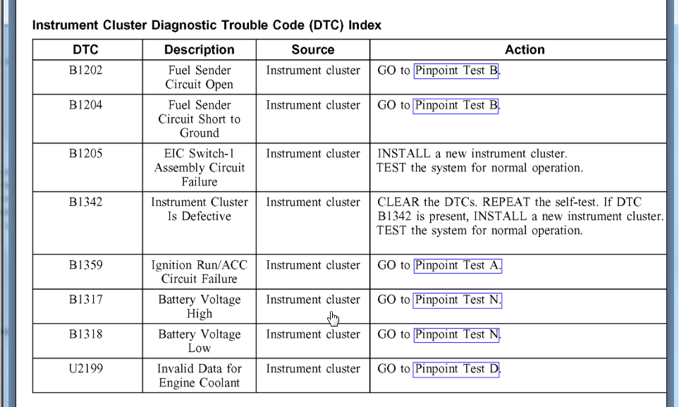

Me again. so, I put the key in, turn, every thing lights up on dash. I can see the odometer as well, and there are no dashes. The anti-theft isn't lighting up when I turn the key either. It sounds like a fan is blowing in the engine when I turn the key, but no turnover. I put my Bluedriver OBD scanner in to see what codes could be the issue, and it gave me the following: B1359 (ignition run/accessory circuit failure), B1601, and P0622. What think ye?
Thanks again!
Jun 15, 2020 at 2:10 AM

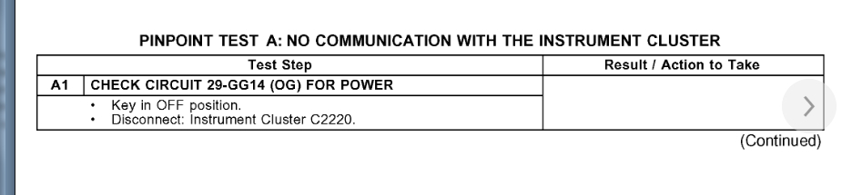

The P0622 is for the generator circuit. This is not the cause of the no start as the B1602 and B1359 are pointing to a key not being programmed and an ignition switch circuit issue which would make more sense as to what you are seeing.
I attached all the info for these codes. Let me know what you find for the B codes and we can go from there.
