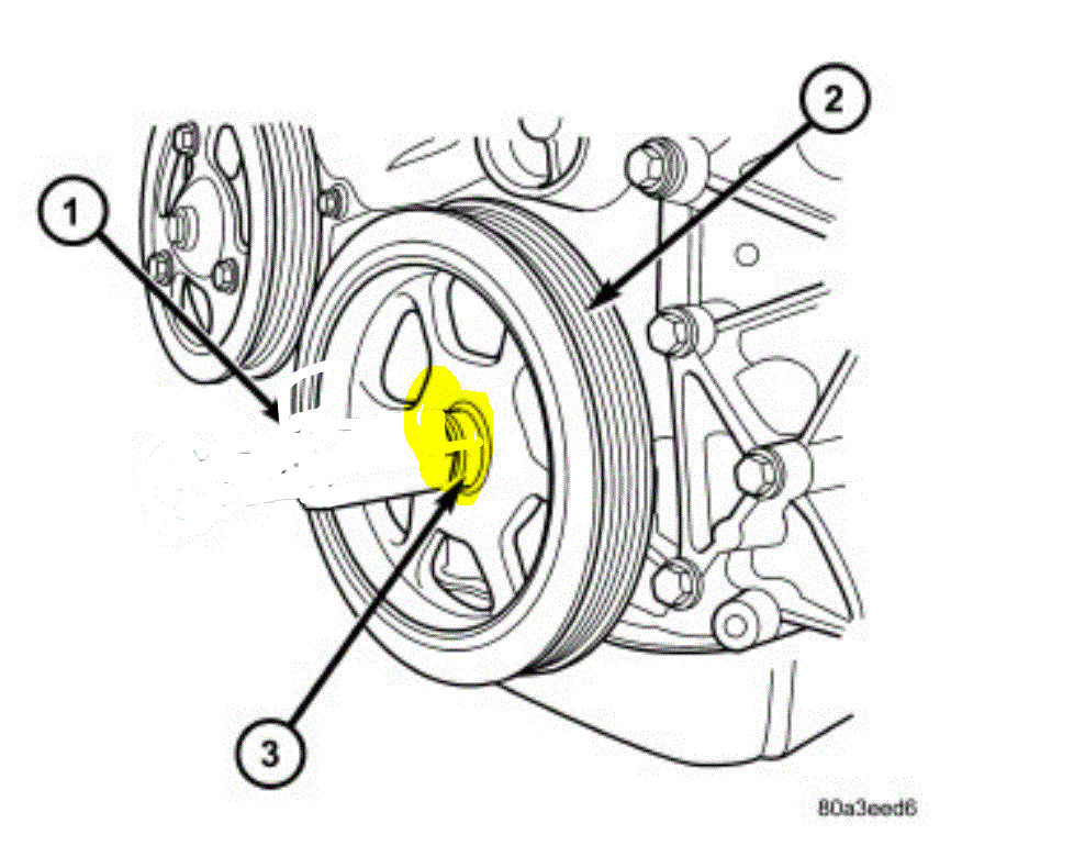

The pink you see could be dried coolant. When you try to start the engine, do you hear a click or anything indicating the starter is trying to turn the engine?
If you do, you can check to see if it's locked up by placing a socket on the crankshaft pulley bolt and seeing if you can turn the engine manually by hand.
If you look below, I attached a pic of the crankshaft pulley and highlighted where the bolt will be. This is the front of the engine at the bottom. The serpentine belt will be on the pulley.
Now, when you say coolant was coming from the spark plug holes, are you sure it wasn't coolant that got sprayed onto them? Additionally, if you remove the radiator cap, is the radiator low on coolant? The overflow reservoir can be full and the radiator/engine be empty. Check the radiator as well if you haven't.

Really do appreciate the help and feedback. A mechanic came by today to take a look and diagnose the problem. While trying to start it, I heard a slight/faint click about once or twice, but the other times were quiet. He reconnected the hose that was disconnected and filled the radiator back up with coolant. He then advised me to get the starter checked because he didn't see anything wrong/damaged with the engine. There is another guy coming to check the starter tomorrow. I will update you with how that goes.

Yes, it was the starter that was the problem. It was completely burned out and had to be replaced, but now the car is running. Thank you again for the great help.
