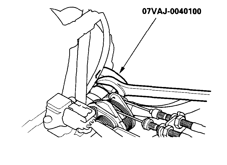

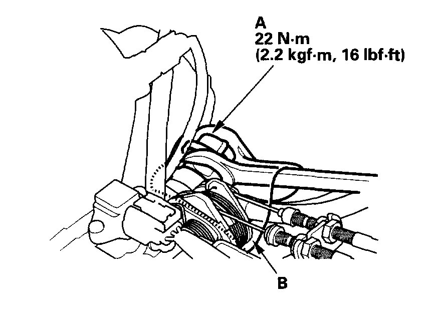

4. Use a wrench on the fuel pulsation damper (A) at the fuel rail.
5. Place a rag or shop towel (B) over the fuel pulsation damper.
6. Slowly loosen the fuel pulsation damper one complete turn.
7. Remove the fuel pulsation damper from its fitting, and attach the fuel pressure gauge attachment.

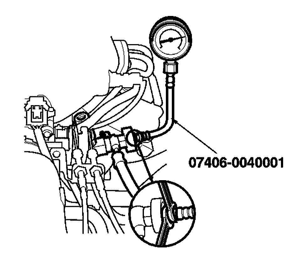

8. Attach the fuel pressure gauge.

11. Read the pressure gauge. The pressure should be: 290 - 330 kPa (2.9 - 3.4 kgf/sq.cm, 42 - 48 psi)
- If the pressure is OK and engine is running, the test is complete. If the engine is not running, repair the cause, then continue this test
- If the pressure is too high, check for a pinched or clogged fuel return hose or line.
- If the pressure is too low, check for a clogged fuel filter and for leaks in the fuel lines.
- If the pressure is out of spec and the fuel lines are OK, replace the pressure regulator.
12. Remove the pressure gauge, and reinstall the fuel pulsation damper with a new washer. Tighten the fuel pulsation damper to 22 N.m (2.2 kgf.m, 16 lbf.ft).
