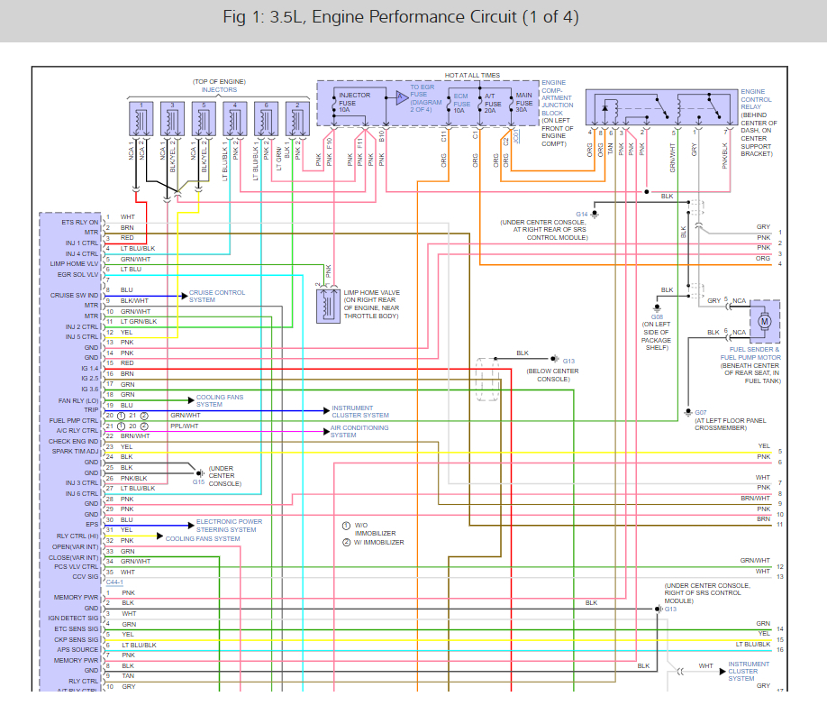

Fuel pump not getting power, it is a brand new pump?
2005 HYUNDAI XG350
122,816 MILES • 3.5L • 6 CYL • 2WD • AUTOMATIC
TYLWARREN
Fuel pump not getting power brand new pump?
Oct 5, 2022 at 9:55 AM
  • 55,399 POSTS

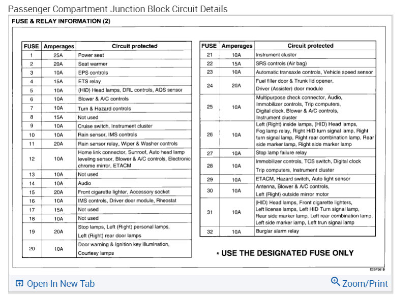

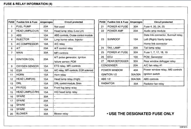

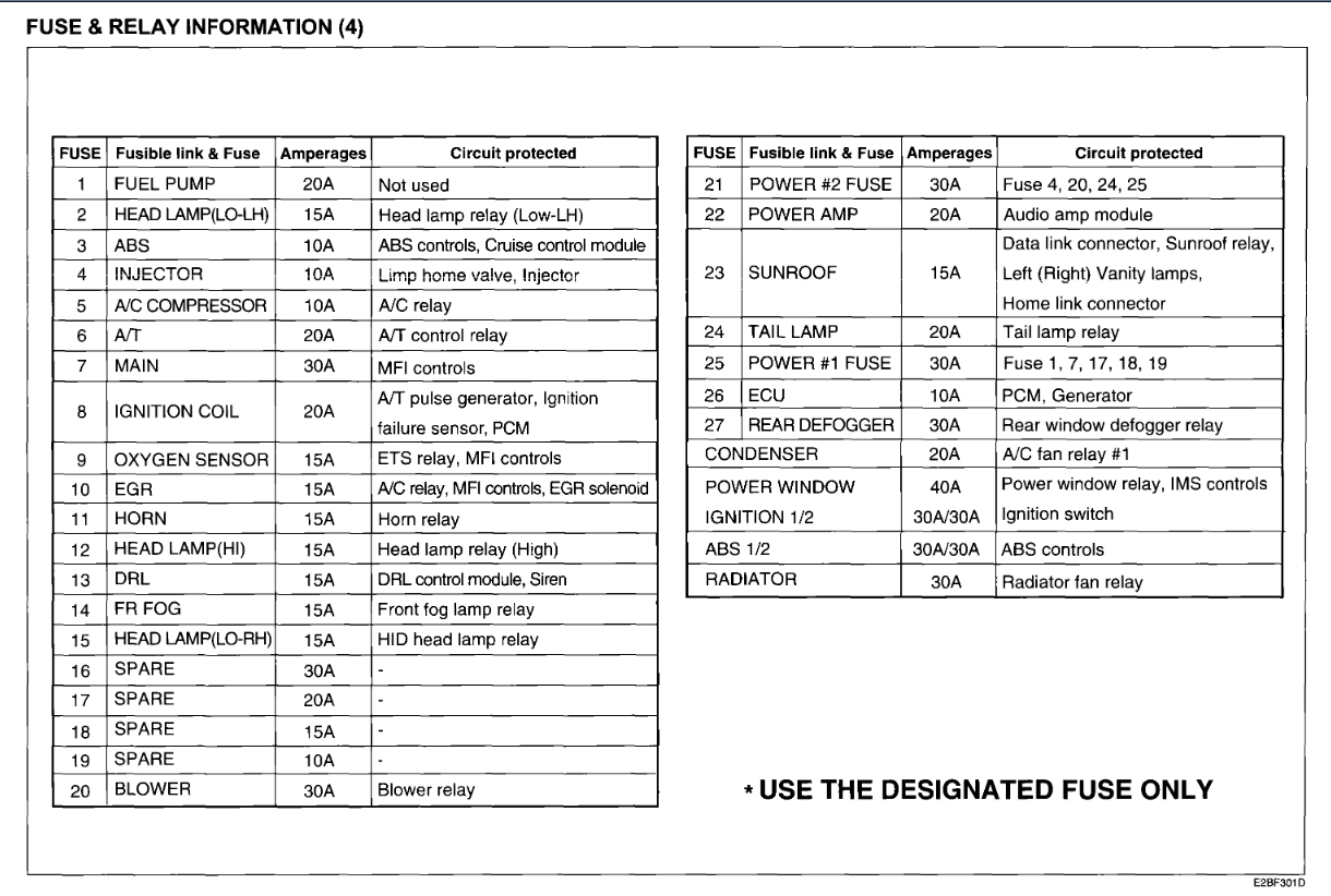

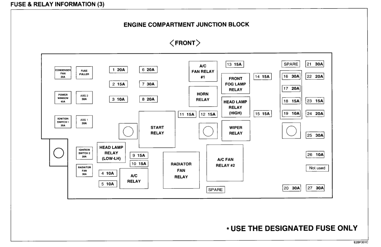

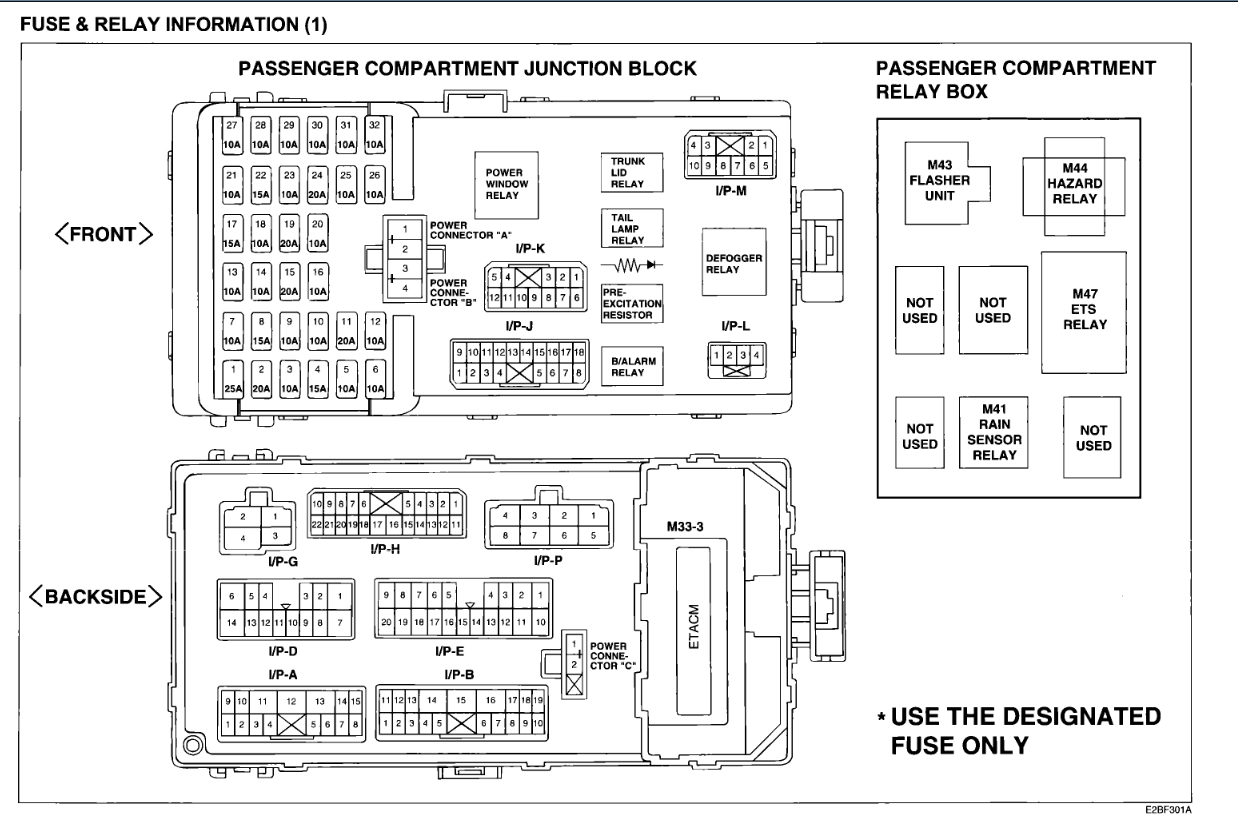

First you must check all fuses.
Here is a guide to help:

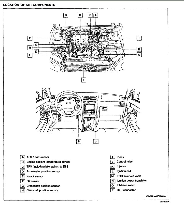

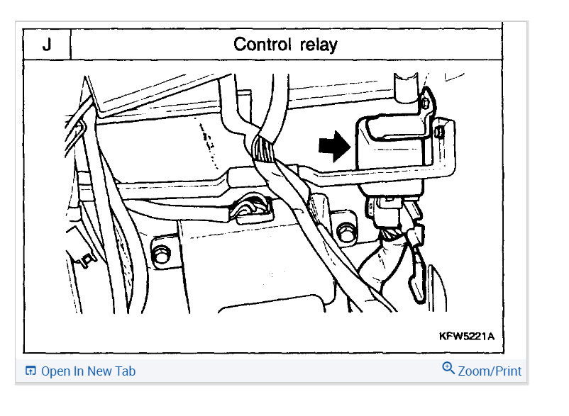

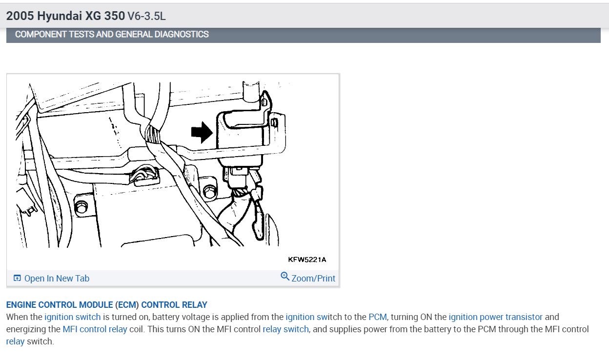

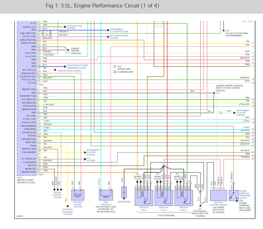

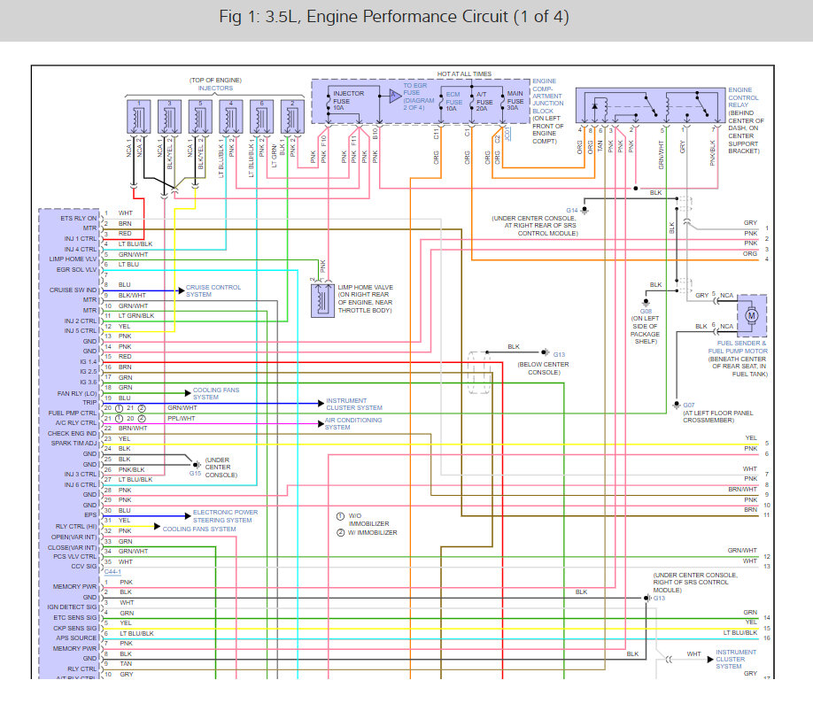

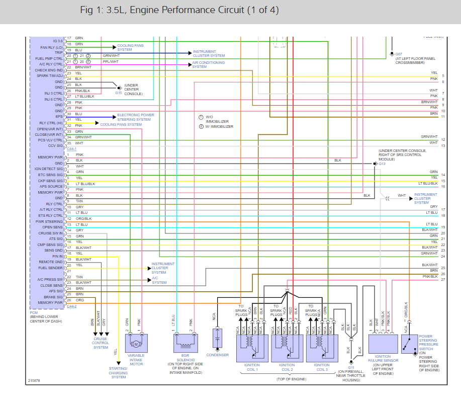

If the uses are good, it sounds like the engine control relay is not working which here is the fuel pump wiring diagrams so you can see how the system works and I have included the location of the relay (J) so you can change it out which should fix the problem. Check out the images (below). Please let us know what you find. We are interested to see what it is.
