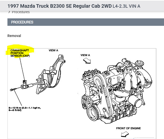

I'm not showing the B2600 for 1997. The only thing I'm finding is the 2300 or 4000. Please confirm for me.
As far as the condition, it sounds like there is an issue with the crankshaft position sensor. If you haven't already, check for spark at the plugs. If there isn't any, suspect the sensor. It may have been left disconnected or damaged by coolant.
I attached a pic below of the 2300 showing the sensor. Take a look at this link. You may find it of interest.

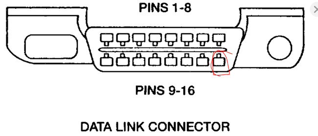

Also, I need you to check connector pin 16 on the data link connector (DLC). That pin should have battery voltage. (See pic below)
I don't have a schematic for the 2600. Based on the schematic for the 2300, power to the DLC comes from the powertrain control module.
See pic below.
