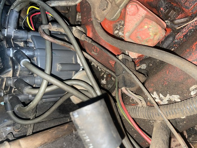

Any suggestions would be helpful, I'd really like to get this truck back on the road. I'll attach some pictures and videos of the work I've done and my problem. Thanks!

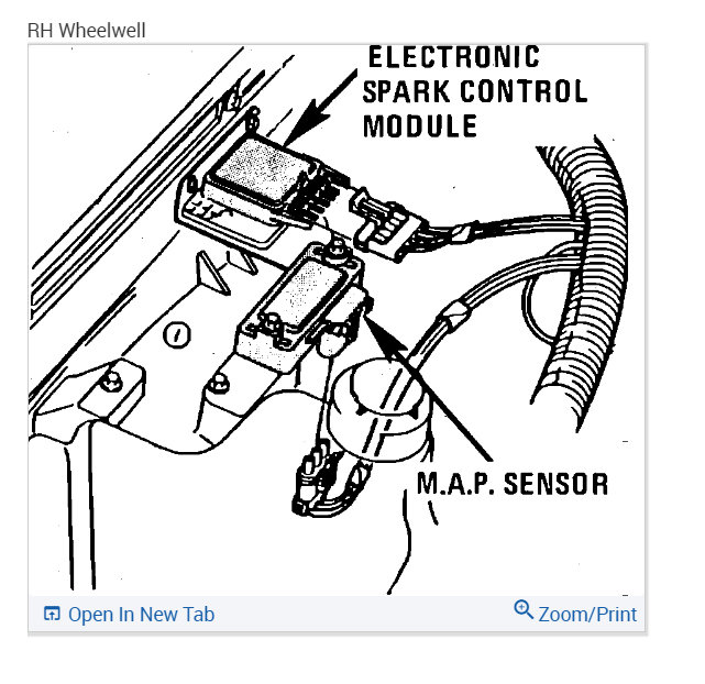

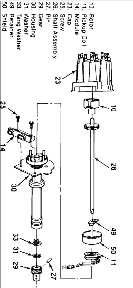

When you turn the key to the on position do you have power at the red wire going into the distributor? This guide can show you how to check for power. Also, there is a ground strap inside the distributor cap that needs to be there, it goes to where the ignition coil is. In the diagrams below it show the spark control module, can you please confirm this is the part you replaced?

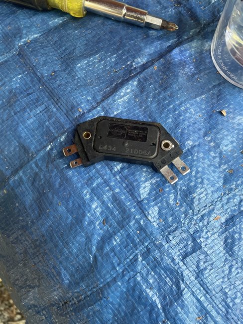

I will attach a picture of the Ignition control module i replaced. It doesn’t look like the diagram I see there, but I could be wrong.

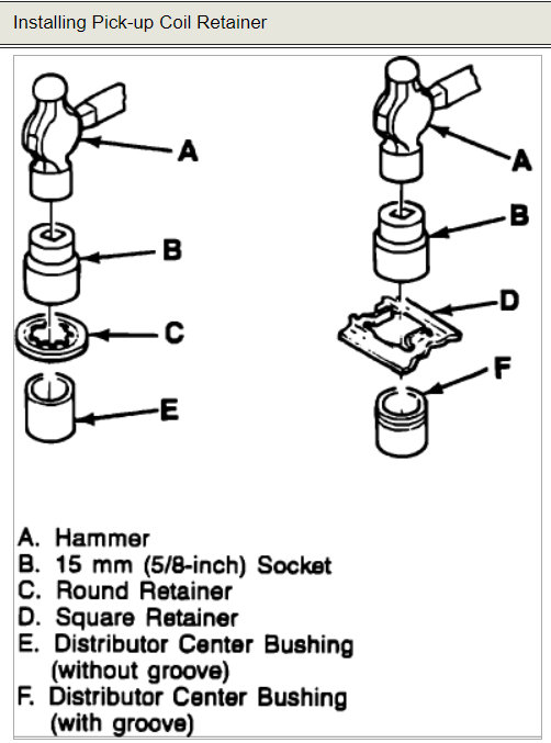

The distributor is rotated mechanically by the camshaft, but it does hurt to have a helper crank the engine over to make sure it turns. Also have you replaced the pickup coil? Here is how.

I have not replaced the distributor pickup, but that was going to be my next step once i confirmed I have power to the distributor.

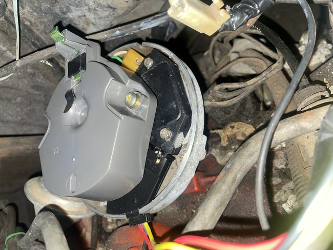

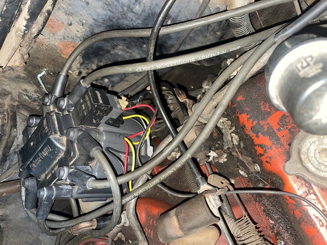

When it comes to testing power, I’m not sure which red wire leading into the distributor you are talking about. I will attach some pictures of the distributor so that maybe you can point me in the right direction.
