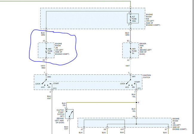

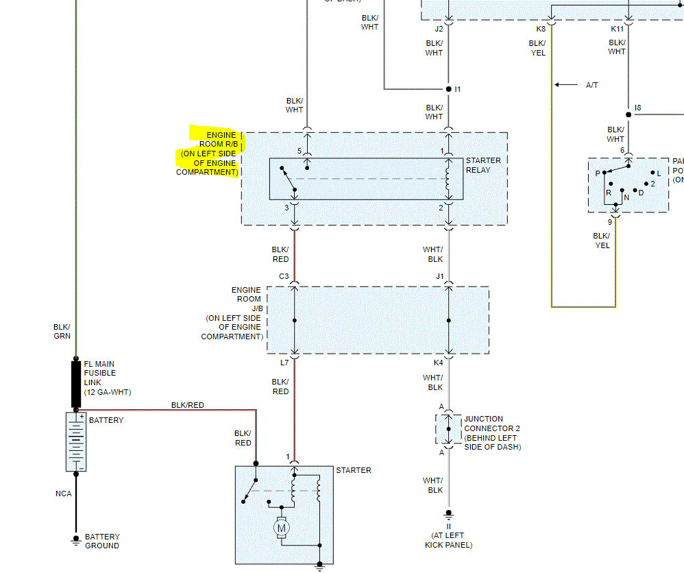

My car won’t start and all of the gauges went up but not back down. I just put in a new starter alternator and battery.

What was happening which caused you to replace the components you listed? Also, is it possible for you to record what is happening and upload it for me to see? This sounds like the starter is having problems or the battery needs to be load tested these guides can help us fix it.
and
As far as the no start, I am thinking the starter isn't engaging simply because of the work that was done.

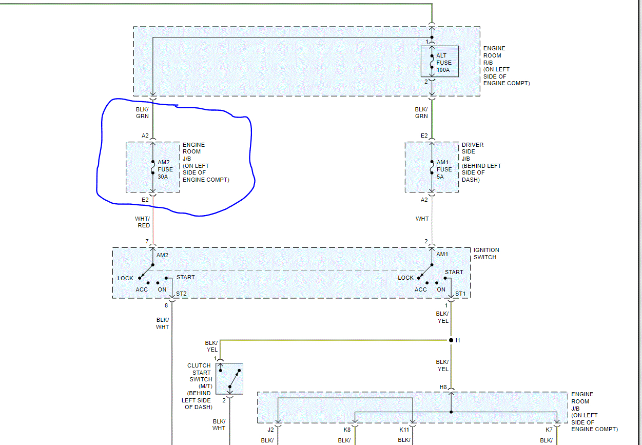

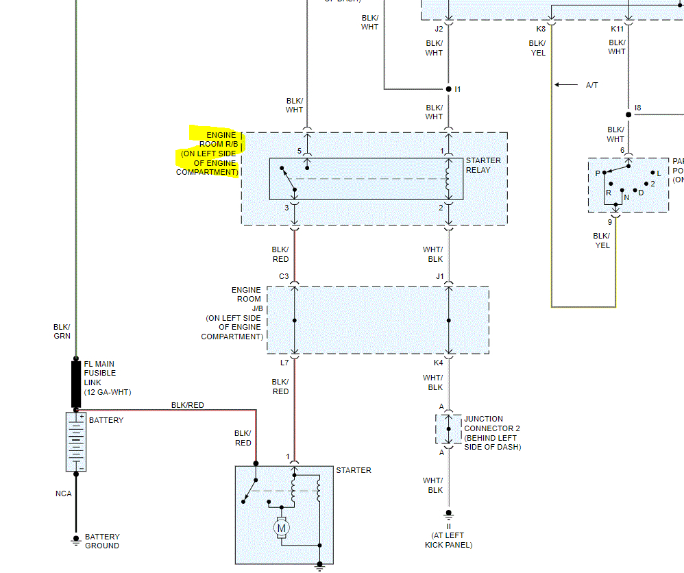

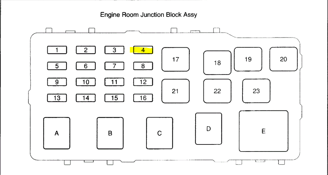

Let's start simple. If you look at the first attached pic, it shows a fuse (AM2) and pic 2 shows a relay I need you to check.
In addition to checking the fuse, confirm there is power to and from it. Here is a link you may find helpful:
As far as the relay, switch it with a different relay in the vehicle that has the same part number. If there isn't one, here is a link that explains how to check a relay:
Check out the diagrams (Below). Let us know what happens and please upload pictures or videos of the problem.
