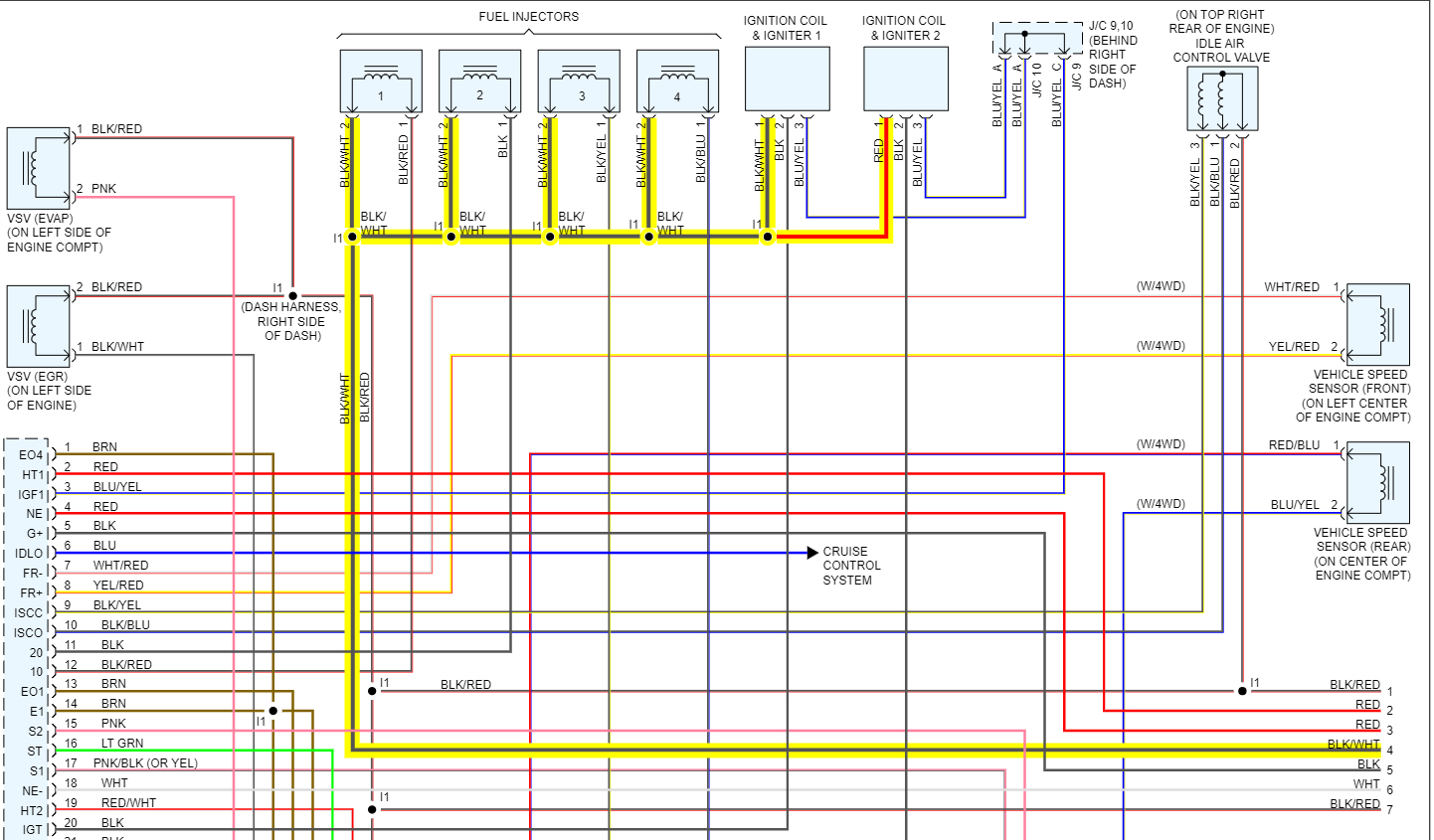

The mechanics were doing head gasket overhaul after replacing it, the car is just cranking, but not starting. i found out that the injectors had no power.
Sep 13, 2022 at 5:40 AM
AL514
  • 5,676 POSTS

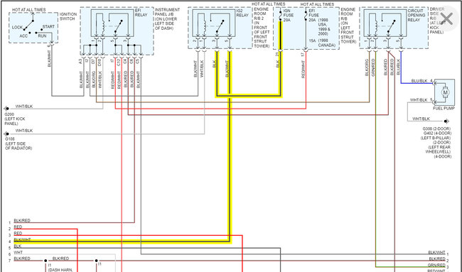

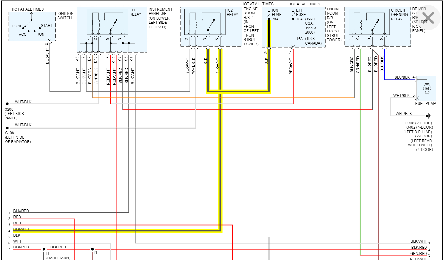

Hello, did it start after they did the head gasket? Or did you have to pick it up like this? The Ign Fuse 20amp powers the fuel injectors and the ignition coils. From the fuse power goes through the Ig2 Relay. Both are in the Engine compartment fuse panel on the passenger side. I'll pull up the diagrams for both.
