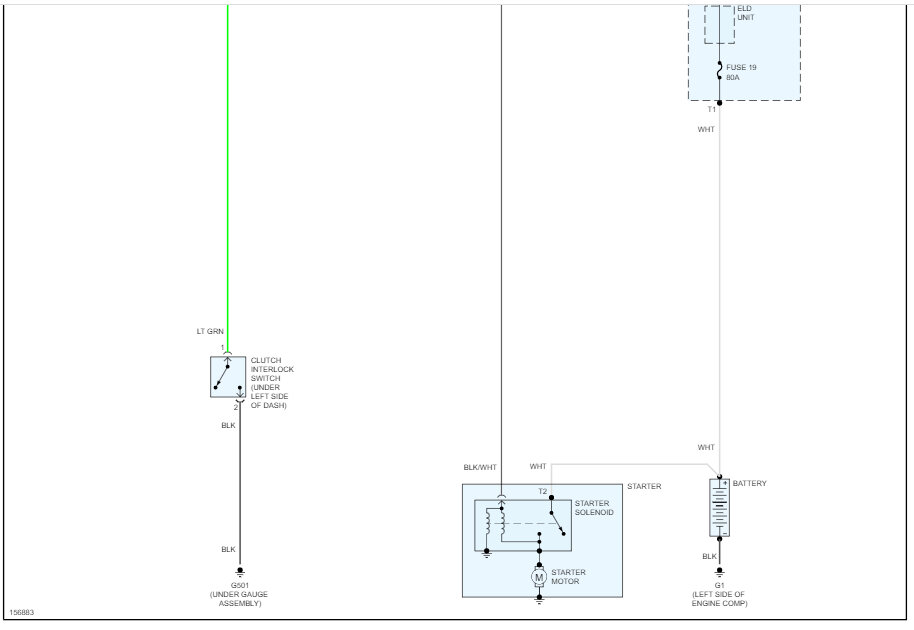

I had a weird situation going about my day, I went to cut my car off and it started screeching when I did. Now it won’t start anymore… I need help y’all!

It’s not like it just doesn’t start, it doesn’t even try to turn over, let alone run.

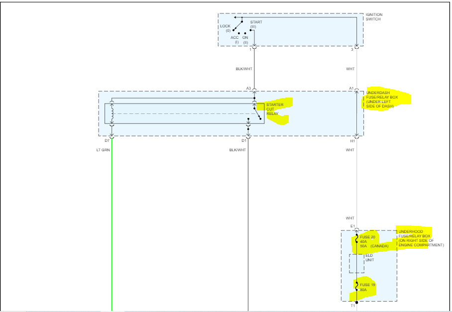

When you try starting it, do you hear a click from the starter or anything? The screeching is odd. Did it sound like a belt? I've seen belt-driven accessories lock and the starter couldn't turn the engine.
I attached the wiring schematic for the starter circuit below so that you have a reference. Check the fuses indicated. In addition, make sure there is power to and from the fuse.
Let me know if you hear anything when you try starting it. If you don't, try starting it in neutral to see if that makes a change.

What would explain the screeching after the engine was turned off?

That's a tough question to answer since I didn't hear it, but could it have been a belt or was it more of a metal-to-metal sound? Can you turn the engine by hand? If you remove the belts, can you turn all belt-driven accessories?
Also, do you hear anything when you turn the key to the start position? For example, do you hear a click?
