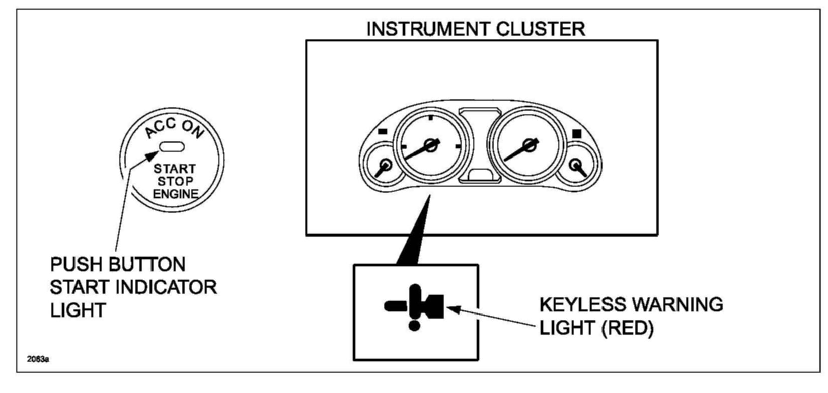

pic 1
NOTE:
If the vehicle goes into fail-safe mode, the red keyless warning light and the red push button start indicator light come on together. For more details of fail-safe mode, refer to Service Bulletin 09-006/09 "FAIL-SAFE MODE FOR KEYLESS CONTROL MODULE AND STEERING LOCK UNIT".

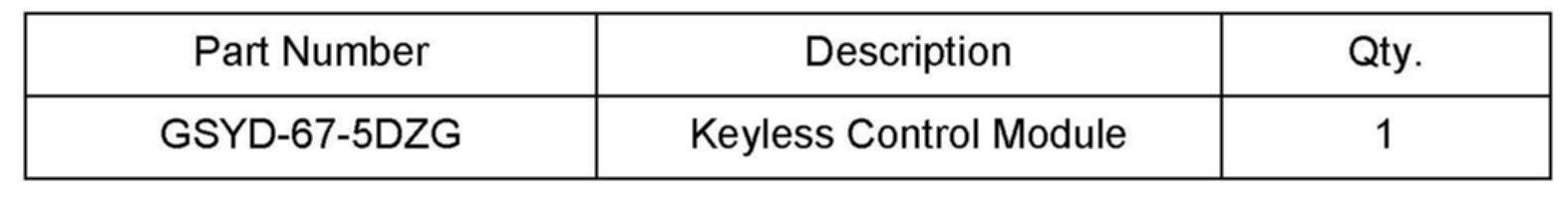

pic 2
PART(S) INFORMATION

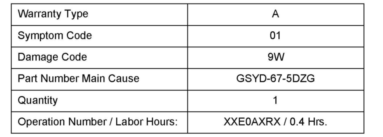

pic 3
WARRANTY INFORMATION
NOTE:
^ This warranty information applies only to verified customer complaints on vehicles eligible for warranty repair.
^ This repair will be covered under Mazda's New Vehicle Limited Warranty term.
^ Additional diagnostic time cannot be claimed for this repair.
