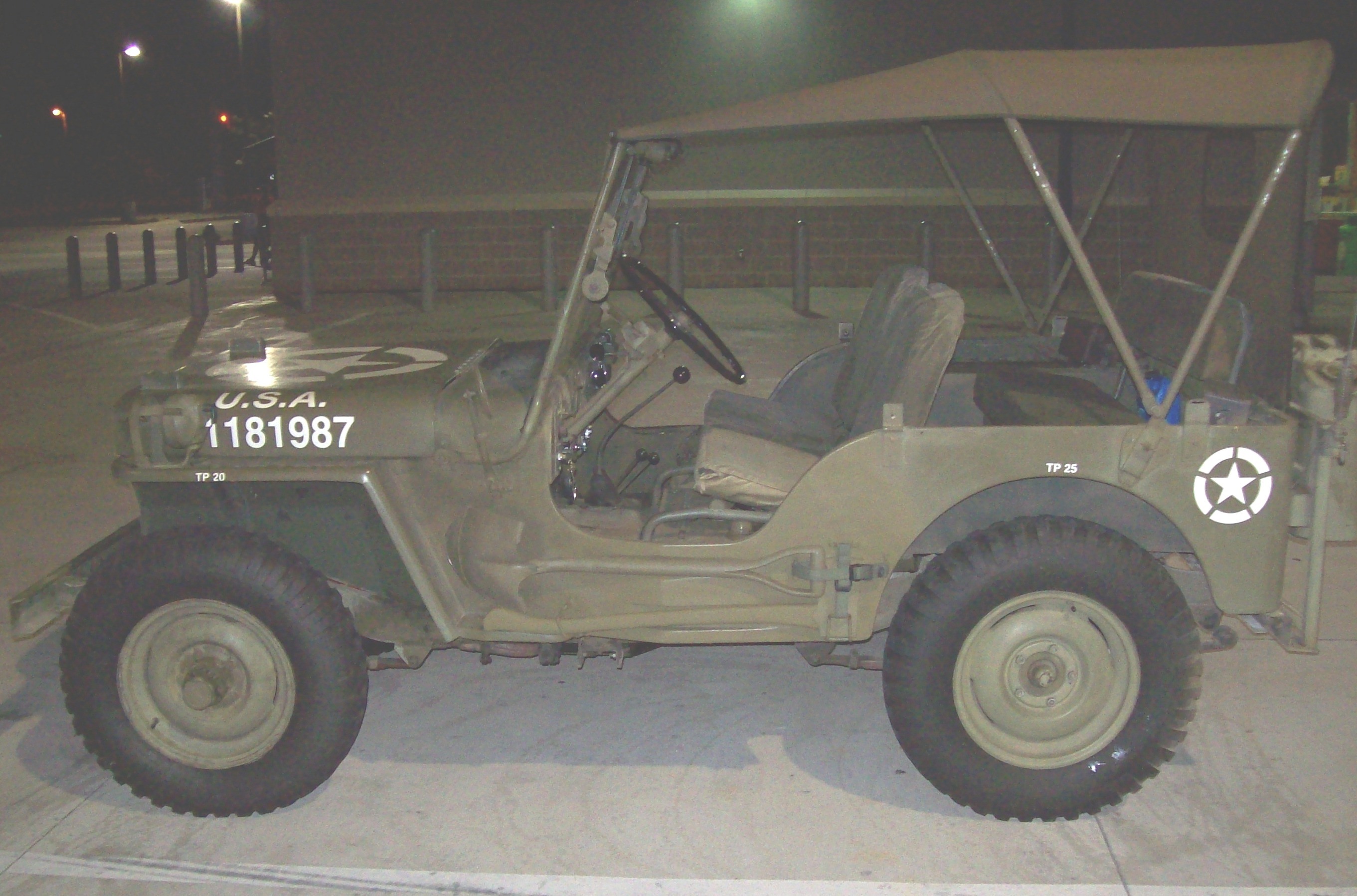

IT DON'T HURT TO BABY YOUR BABY.....MY TWO ARE 36 AND 67 YEARS YOUNG....BOTH ARE DAILY DRIVERS......I USE REPAIR MANUAL MAINTENANCE SCHEDULES AS A GUIDELINE, NORMALLY I DO THE SUGGESTIONS WELL BEFORE THE BOOKS RECOMMEND......I JUST DON'T SEE ME GETTING ANOTHER JEEP, WHEN MINE STILL WORK SO WELL
