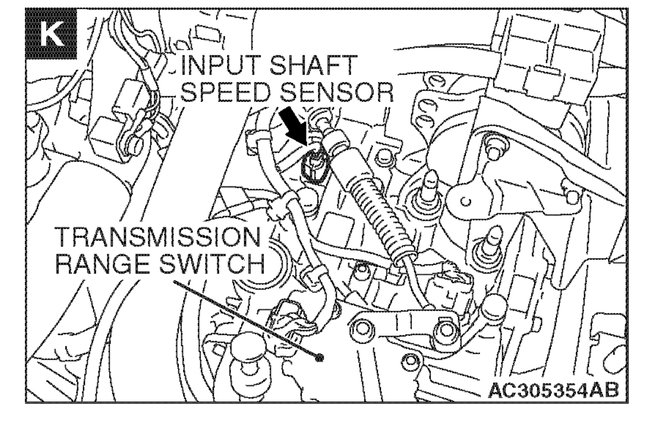

Transmission gets stuck in third gear
19,000 MILES • 2.4L • 4 CYL • 2WD • AUTOMATIC
DUSTIN AURORA ADKINS
At first my car would hesitate to shift from reverse to drive then I lost a lot of power. When you first start my car it drives fine from first to second then gets stuck in third and stays there. I can't up shift or downshift.when I turn car off it repeats everything again but cannot get car out of third.
Sep 26, 2019 at 5:32 AM
  • 55,770 POSTS
It sounds like you have an input shaft speed sensor that is not working correctly. To be sure lets run the codes. here is a guide and I found the sensor location in the diagrams below:
