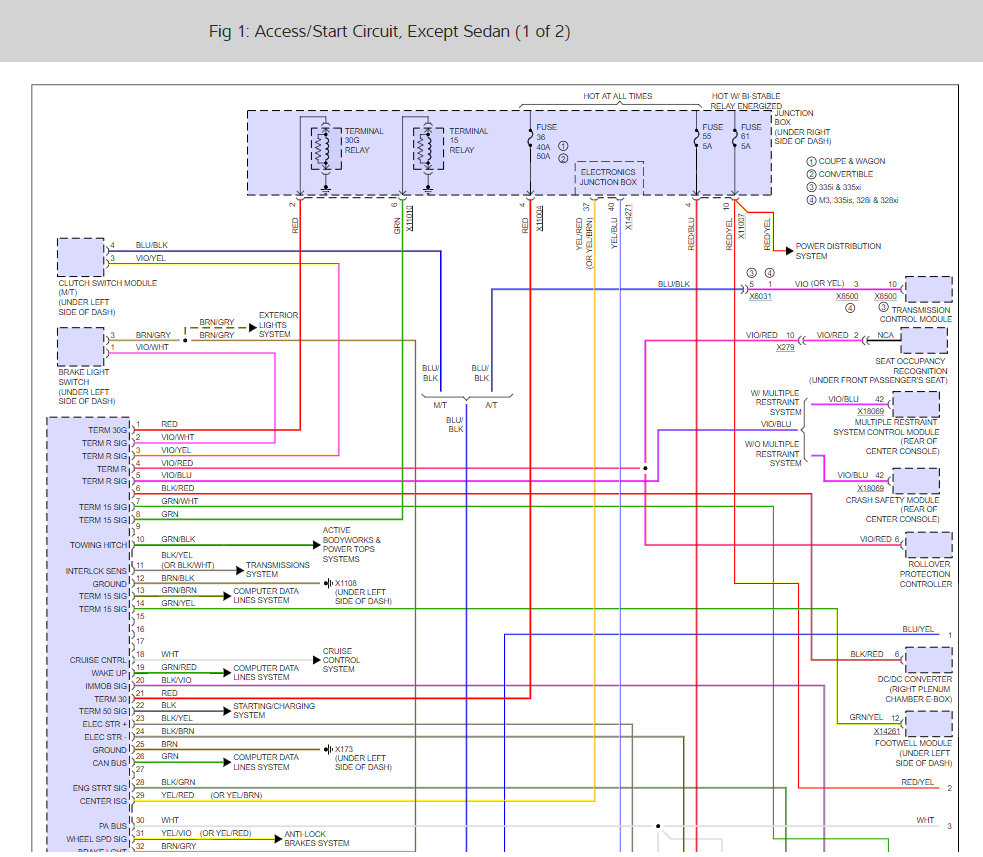

Hi, I have had intermittent faults for past few months. Some examples, first time, opened the car did not enter for five to ten minutes then when I did the car did not recognize I was in the car with the key and would not start and nothing on dashboard. Second time, car had been running, I stopped at a shop for couple of minutes and when I got back into the car I had the same issue. Third time, opened the boot, loaded some stuff, left for ten minutes and when I got back into the car had the same issue. After each occasion the car starts every time I leave it for an hour and try it again. Had into BMW and no faults are bring recorded as if the car never even recognized I was in, and once it "powers down" I have no issue. Any ideas as it is driving me crazy?

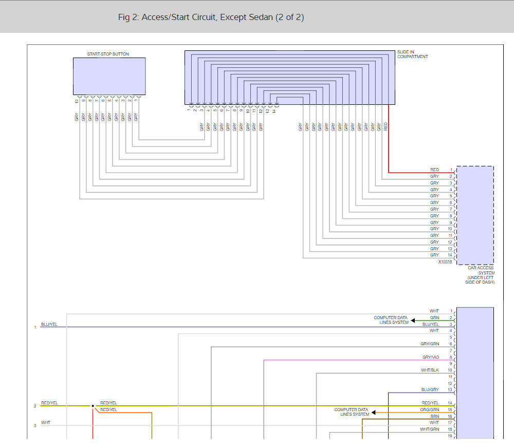

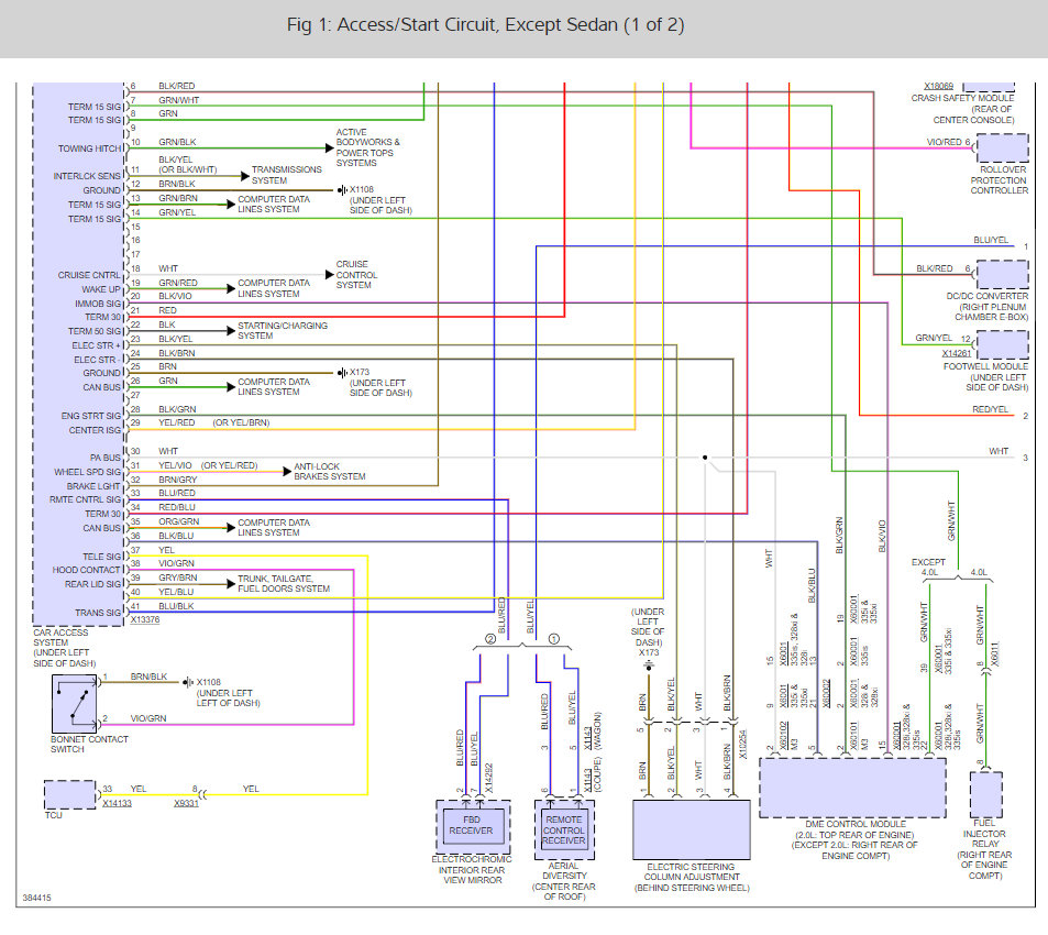

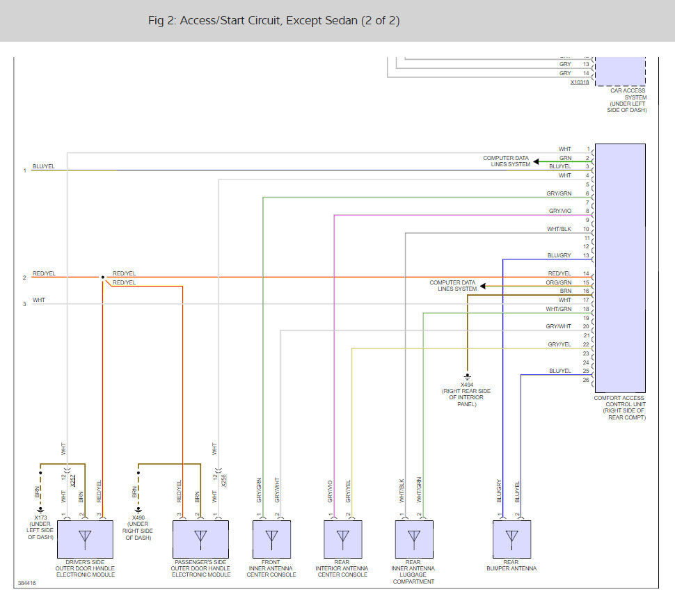

It sounds like to me the comfort access control module is going out and needs to be replaced. Here is a wiring diagram so you can see how the system works.

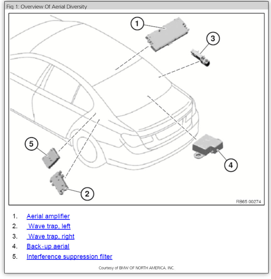

Here is the location as well, you will need to have the dealer program it for you.
