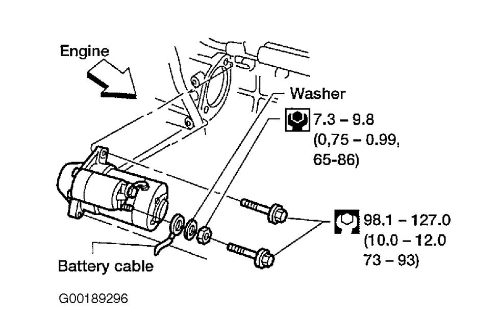

how many hours to replace a starter motor in a 2002 nissan almera is it difficult to get at,do i need to remove the exuast pipe to get at it.do i need special tools.would it bee better to get a mechanic to do the job and how many hours would he take. i cant stretch this question any further. ratface

sounds like the starter is bad. Here is a guide to help you step by step with instructions in the diagrams below to show you how on your car.
