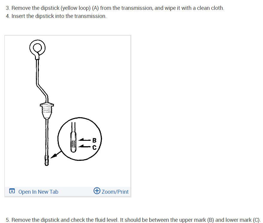

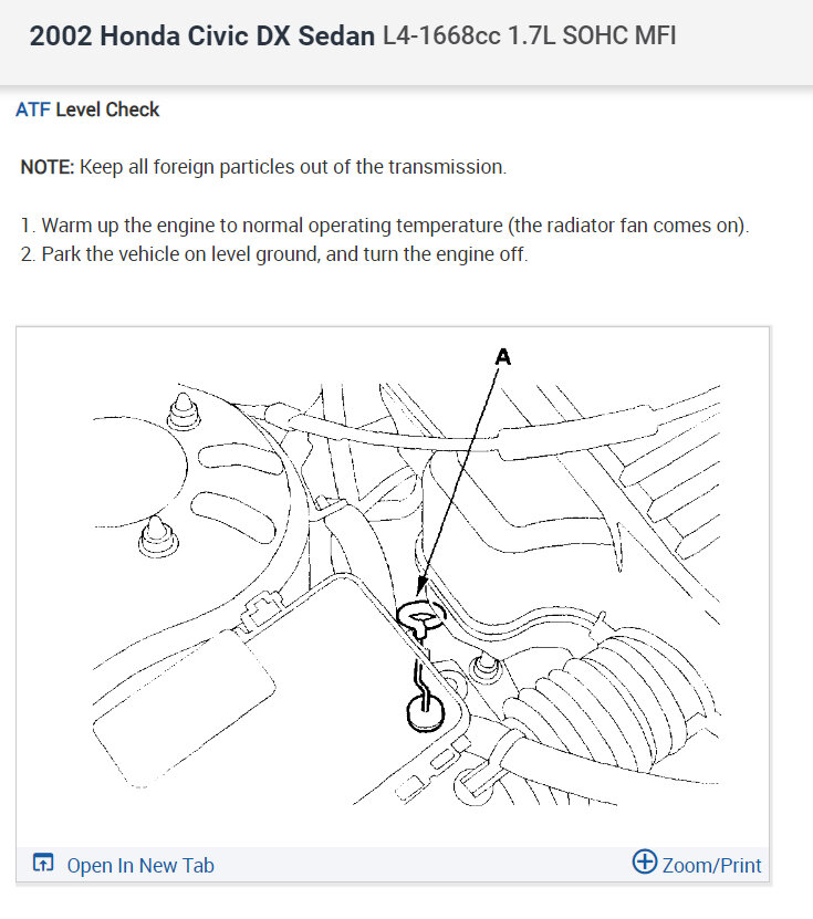

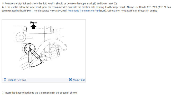

I would start by checking the transmission fluid level and if that is okay, I would check the CV axles because if one breaks the car will go into neutral. When the car is in gear look under to see if one of the axles is spinning, if so, that is the one that needs to be replaced. Here is how to check the fluid level.
A/T Fluid
Type .................... Honda ATF-Z1
Honda Service News Notice:
If you're replacing transmission fluid in a CVT-equipped vehicle, or just topping it off, make sure you're using the new CVT fluid (P/N 08200-9006). From here on, DON'T put ATF-Z1 in a CVT. If you're topping off a CVT that's already got ATF-Z1, there's no need for concern; this fluid is compatible with ATF-Z1. All CVT-equipped Hondas starting with the 2006 models and onward will be factory-filled with the new CVT fluid.

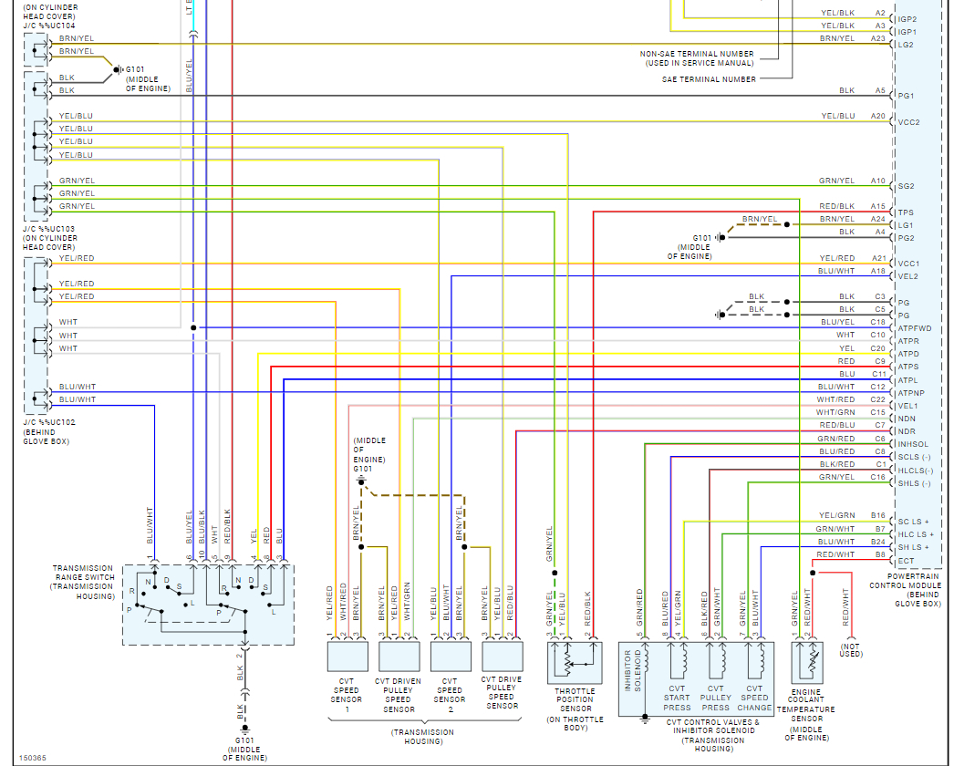

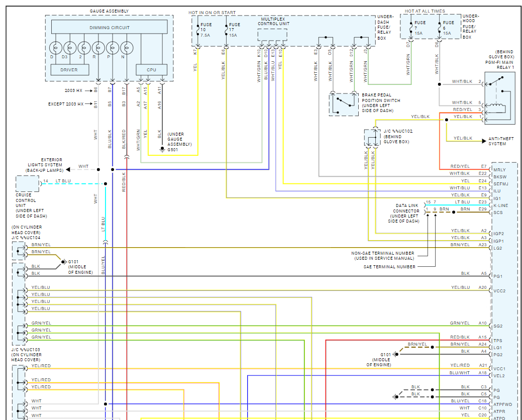

Now that it is out, I would do a test on all control solenoids to make sure they are all operating as intended. Also, make sure all of the shuttle valves slide smoothly and that there are no broken return or pressure springs. Here is the wiring diagrams for the transmission so you can see how the system works and which circuit to test.
