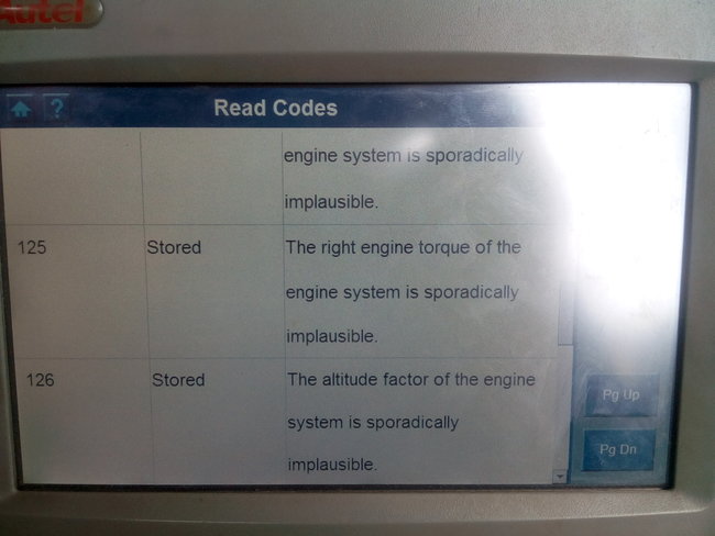

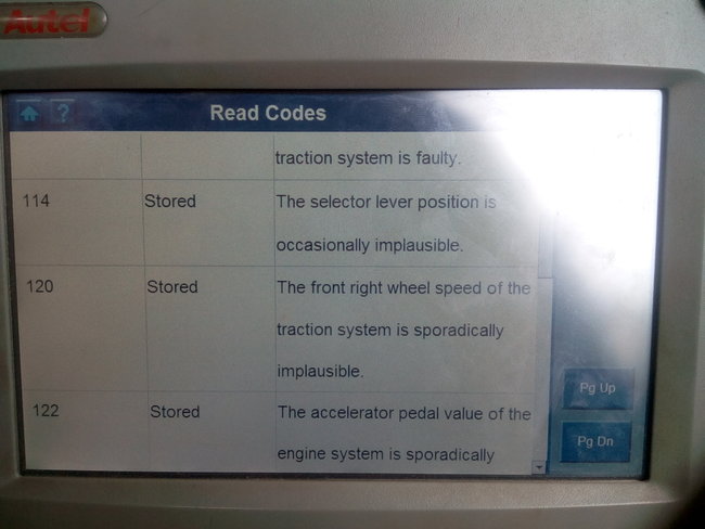

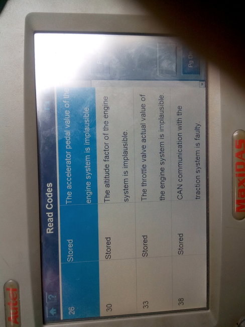

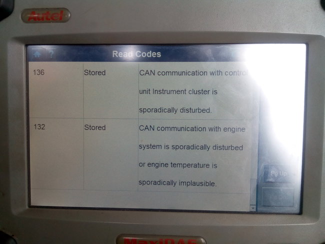

BLESSING EWOBOR
  • 753 POSTS
I finally found the DLC, it was squeeze somewhere.these are some codes I found in the ETC.

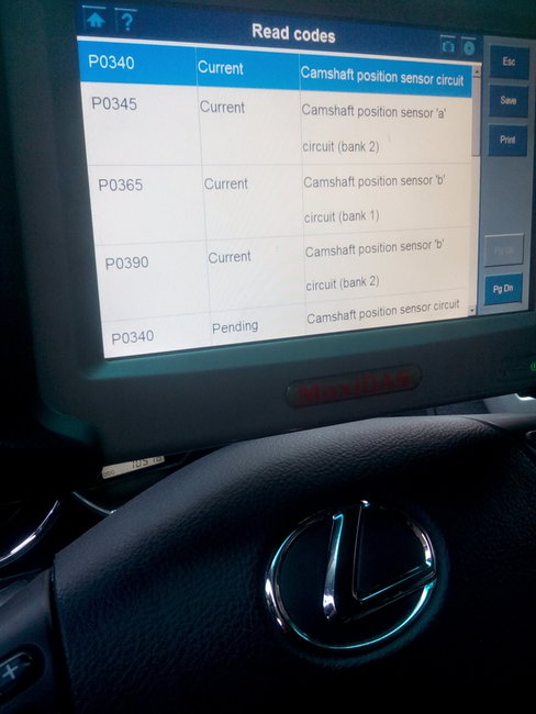

What brand car is this? The heading says Mercedes and the logo on the steering wheel is a Lexus.
Aug 29, 2020 at 2:27 PM
BLESSING EWOBOR
  • 753 POSTS
It is Mercedes Benz, all the pictures is for the Mercedes Benz except that one with the Lexus logo. if you notice the codes starts from alphabet "P" is for the Lexus while the Mercedes Benz starts with numbers. Please ignore the Lexus, I am still working on that. I really apologise for the inconveniences I have caused you.

You have a ton of different issues. Please keep in mind, I don't have the specifics on the C200. I am using info from a C230.
Since there are several codes indicating implasable readings, it doesn't seem like a sensor issue but instead either a break down in the CAN bus or a connection at the ECM. That is where I would start. I attached what I have. I hope it is the same or similar to what you are working with.
The first pic shows the CAN system schematic. The remaining pics are from the power-train control schematics.
Check for loose connections at the ECM first.
