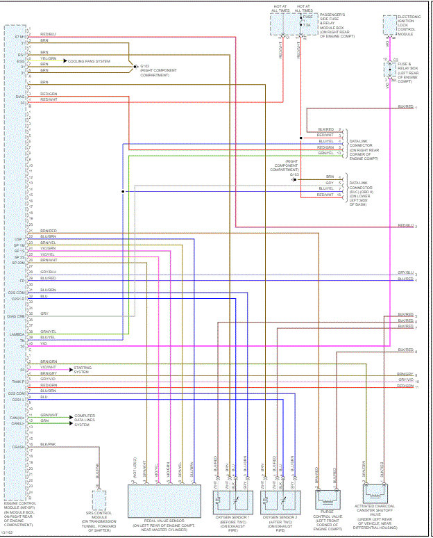

I'm not showing a C200. The closest thing I can find is a C230 with the 2.3L.

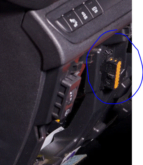

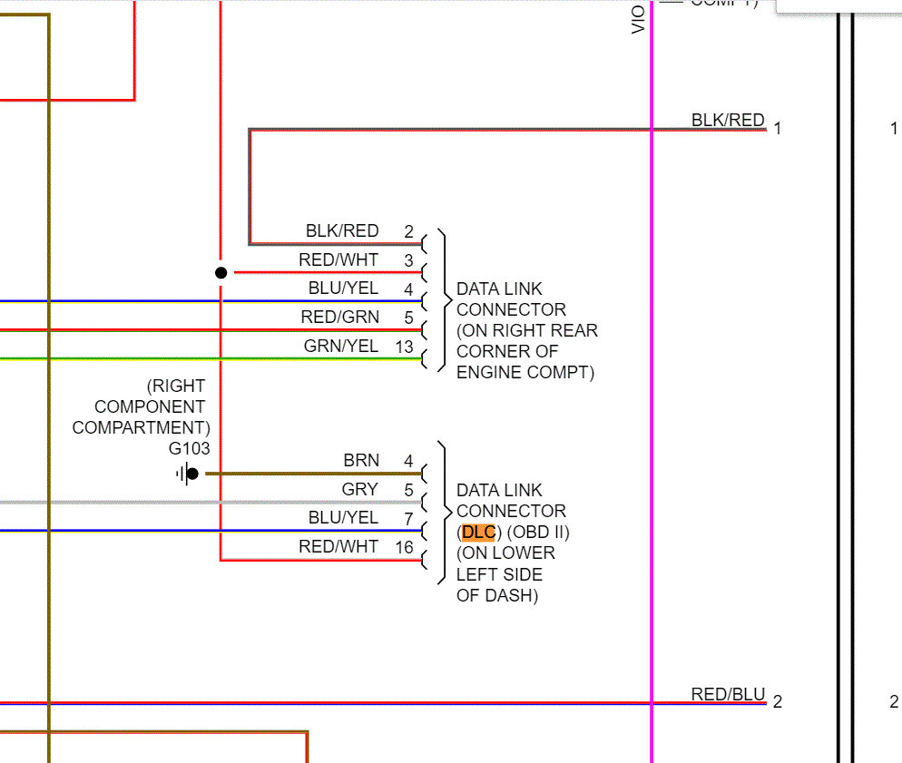

As far as the DLC, I attached a pic below that shows two locations. Take a look at it and see if it helps. Keep in mind it is from the wiring schematic of a C230.

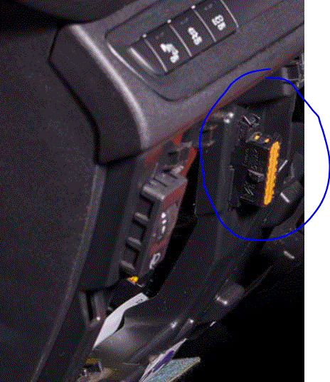

Chances are it is related to a crank or cam sensor. We need to locate the DLC. I found a pic of where the C class DLCs are located. See if you can locate this on your vehicle.
See pic 1.

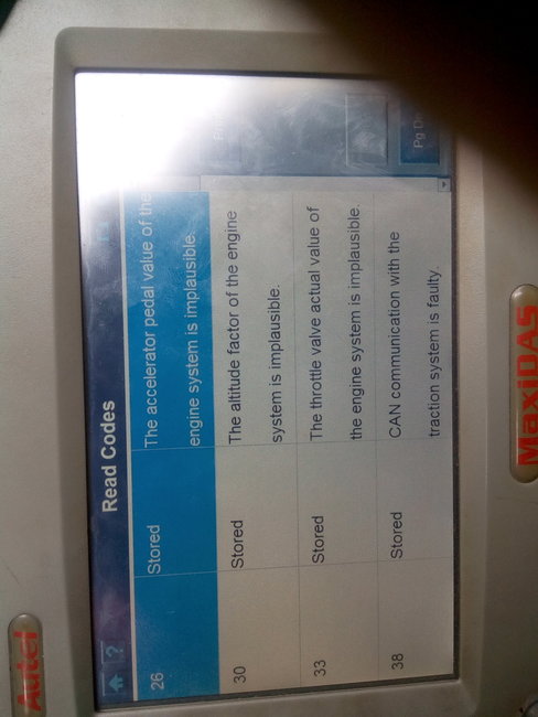

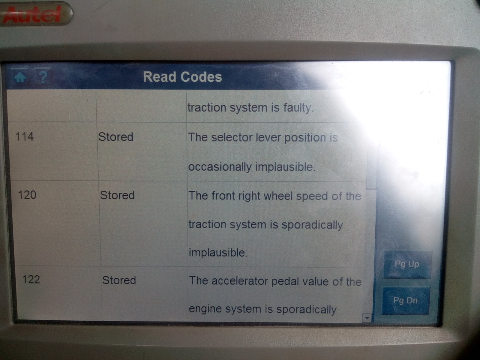

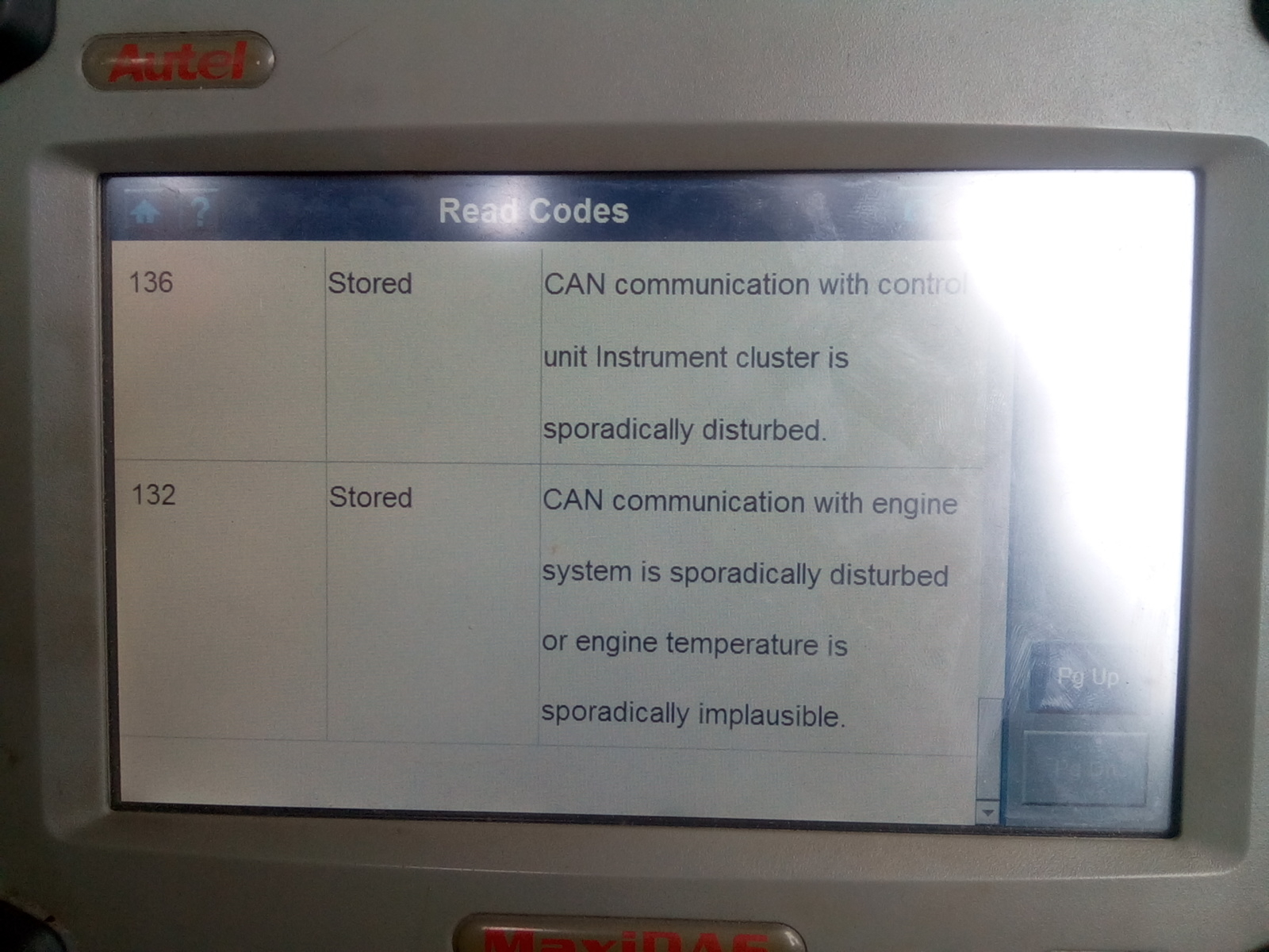

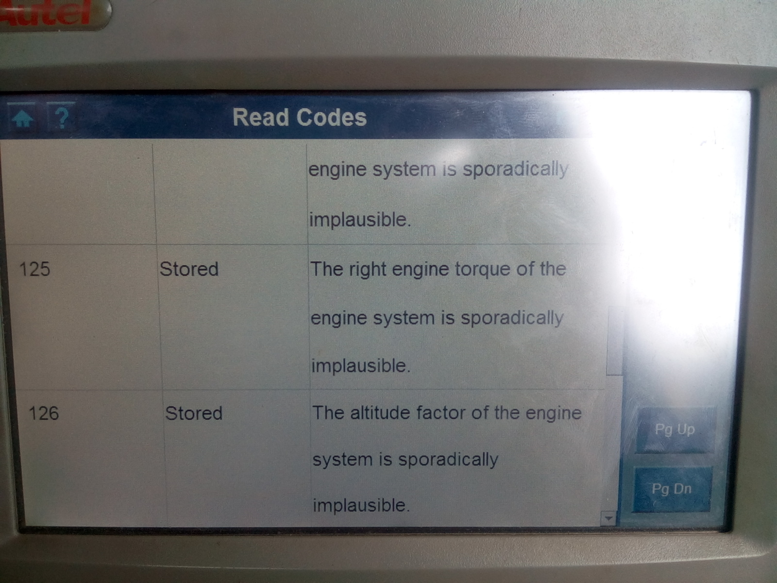

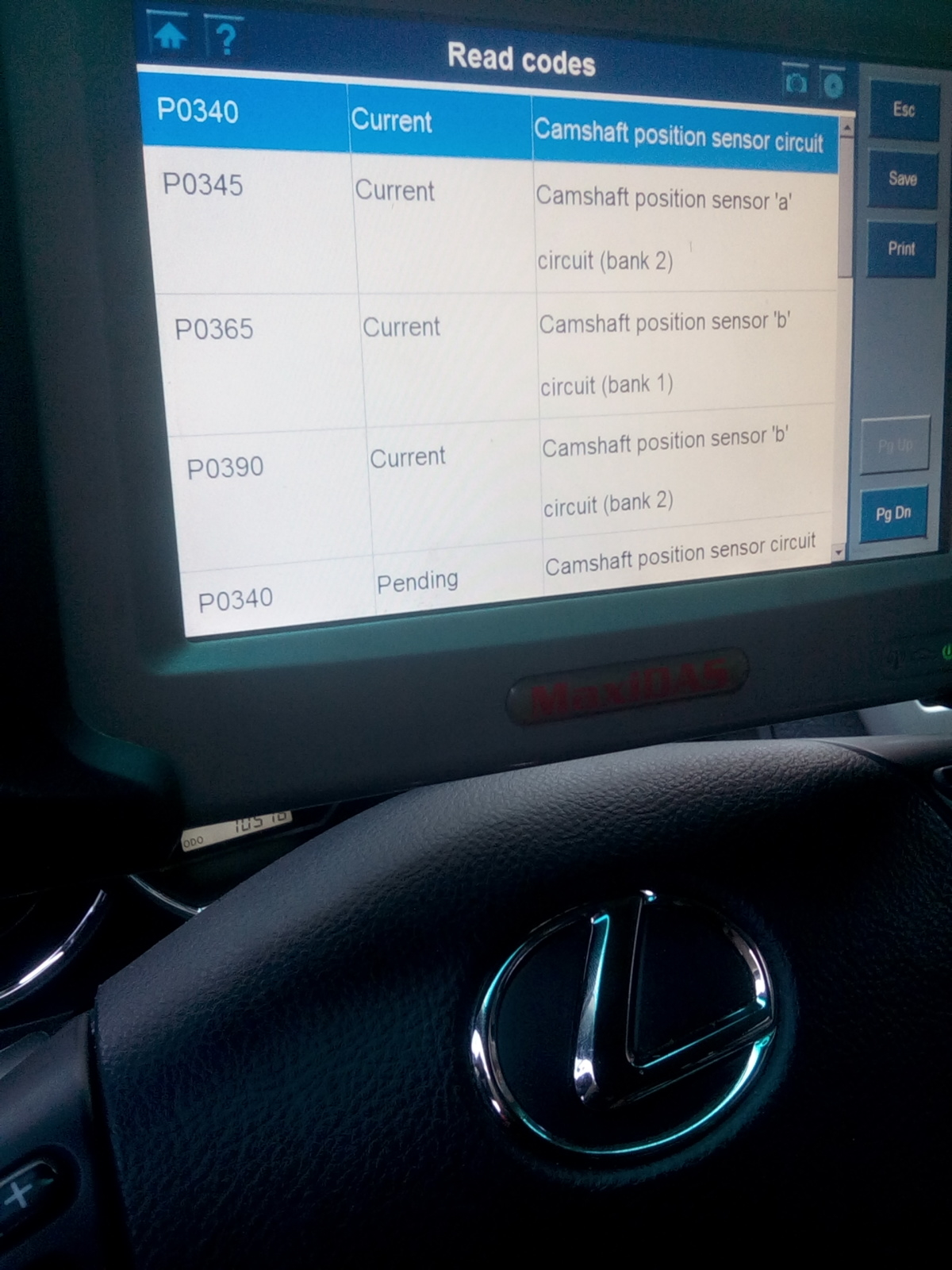

I finally found the DLC, it was squeeze somewhere.these are some codes I found in the ETC.

What brand car is this? The heading says Mercedes and the logo on the steering wheel is a Lexus.

It is Mercedes Benz, all the pictures is for the Mercedes Benz except that one with the Lexus logo. if you notice the codes starts from alphabet "P" is for the Lexus while the Mercedes Benz starts with numbers. Please ignore the Lexus, I am still working on that. I really apologise for the inconveniences I have caused you.

You have a ton of different issues. Please keep in mind, I don't have the specifics on the C200. I am using info from a C230.

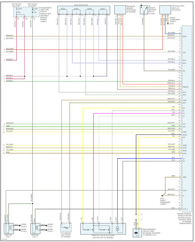

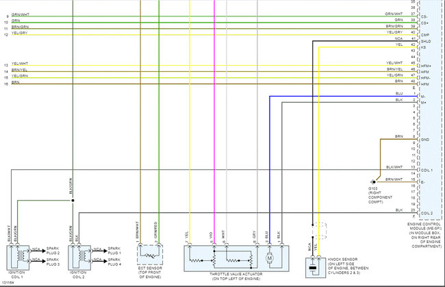

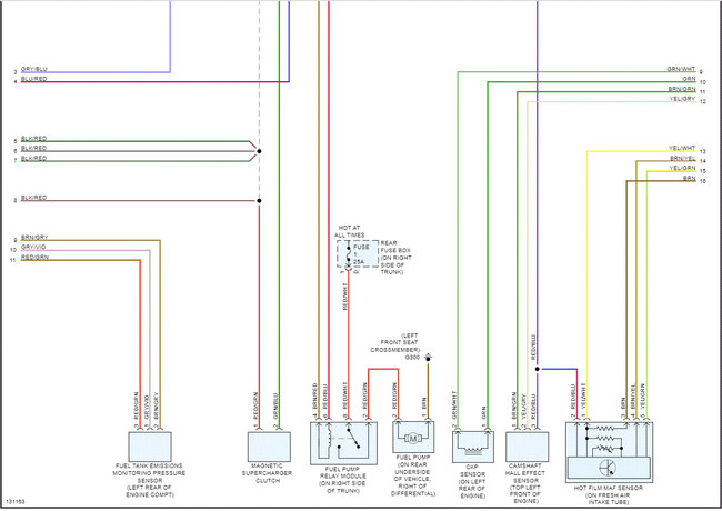

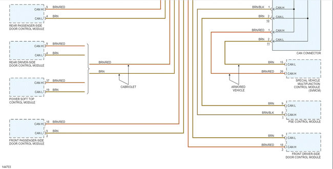

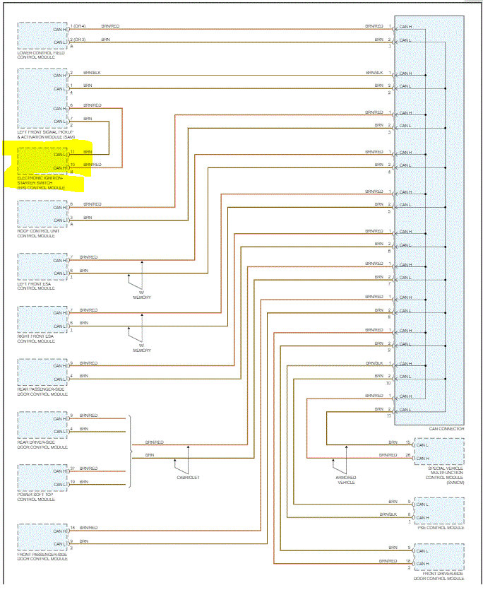

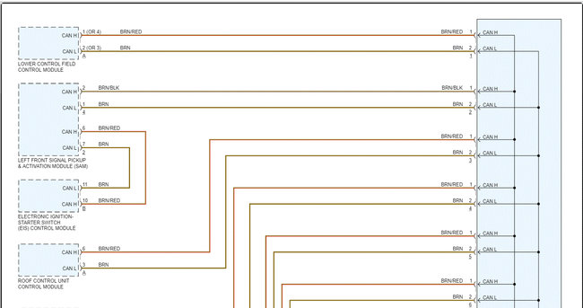

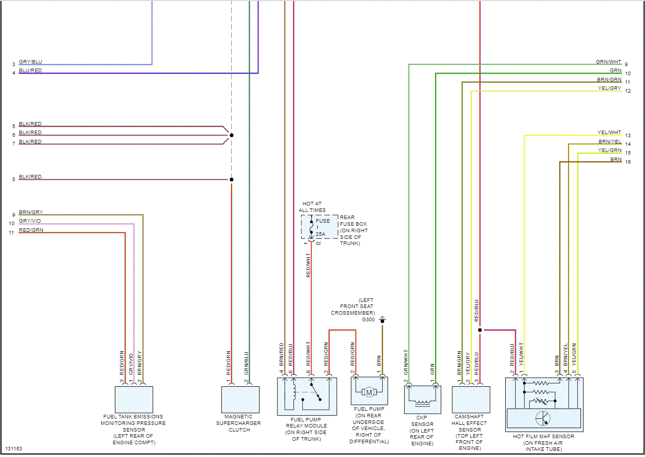

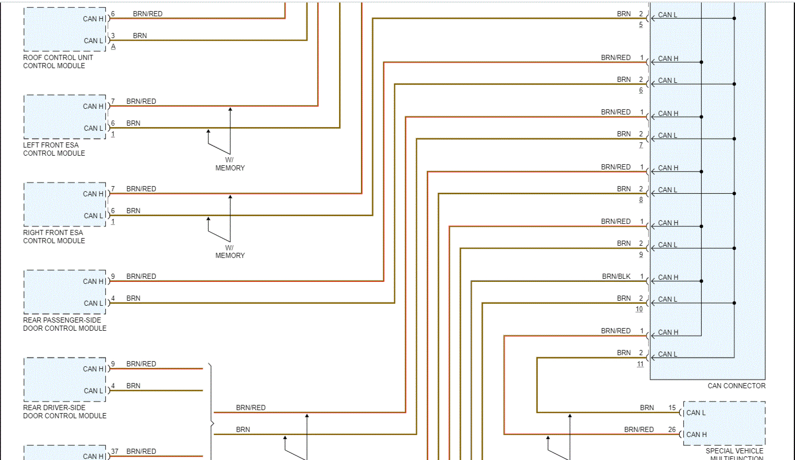

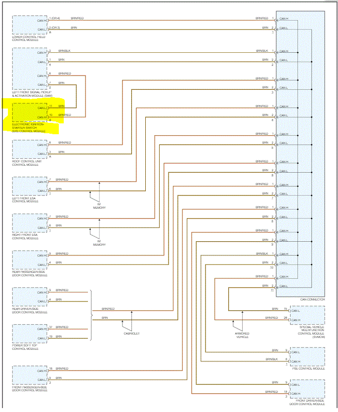

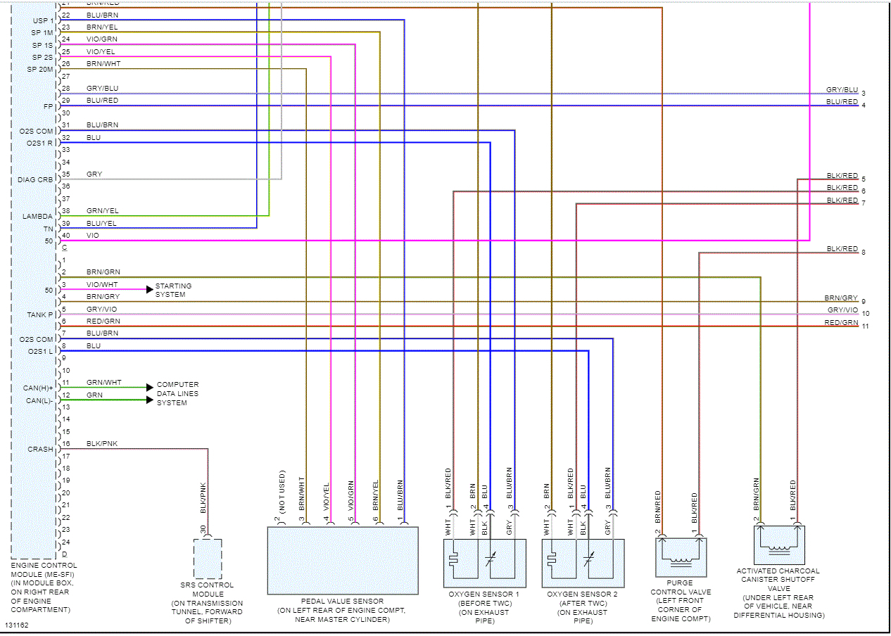

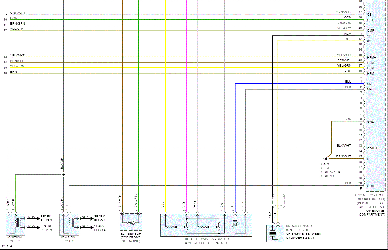

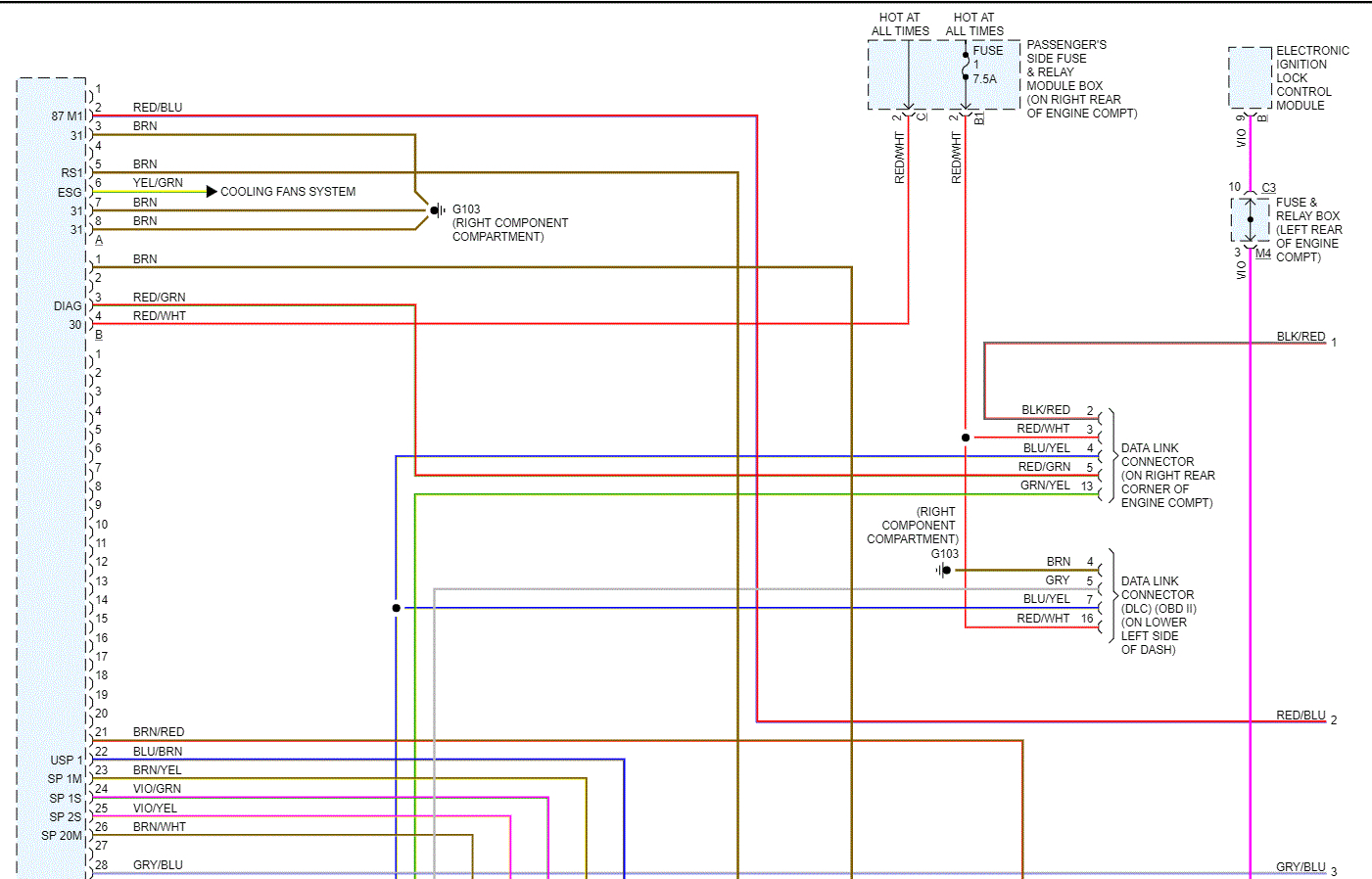

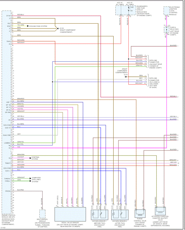

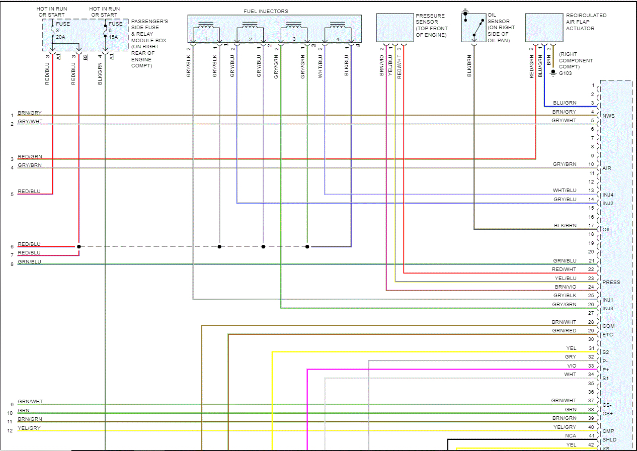

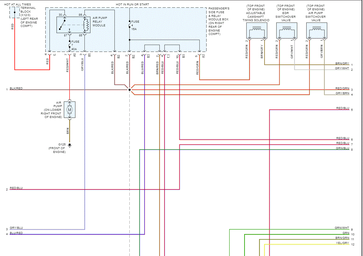

Since there are several codes indicating implasable readings, it doesn't seem like a sensor issue but instead either a break down in the CAN bus or a connection at the ECM. That is where I would start. I attached what I have. I hope it is the same or similar to what you are working with.
The first pic shows the CAN system schematic. The remaining pics are from the power-train control schematics.
Check for loose connections at the ECM first.
I hope this helps.
Aug 30, 2020 at 2:24 PM

Thank you very much, but the pics you sent are blur. I don't know if I can get clearer ones.
Sep 1, 2020 at 4:09 PM
  • 110,244 POSTS
Take look at the attached and let me know if you can read them. It is one pic that I broke into 3 parts. Please let me know if that helps. I did overlap them so you can follow it.
Sep 2, 2020 at 11:29 AM
BLESSING EWOBOR
  • 753 POSTS

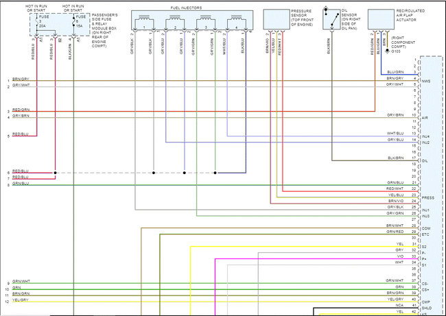

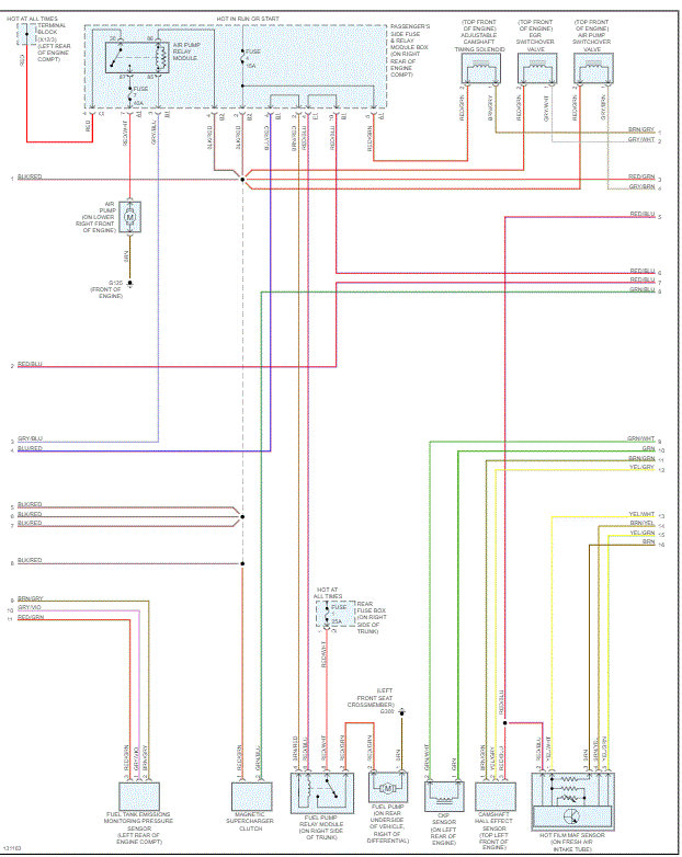

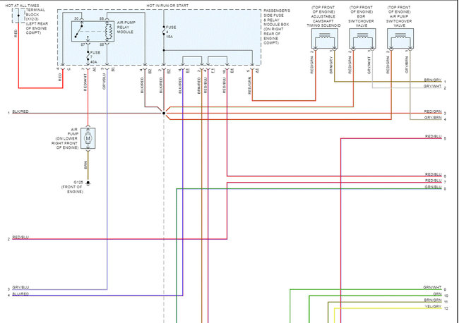

I can see it clearly but that is for the CAN system schematic, what about the power-train control schematic?
Sep 2, 2020 at 1:53 PM

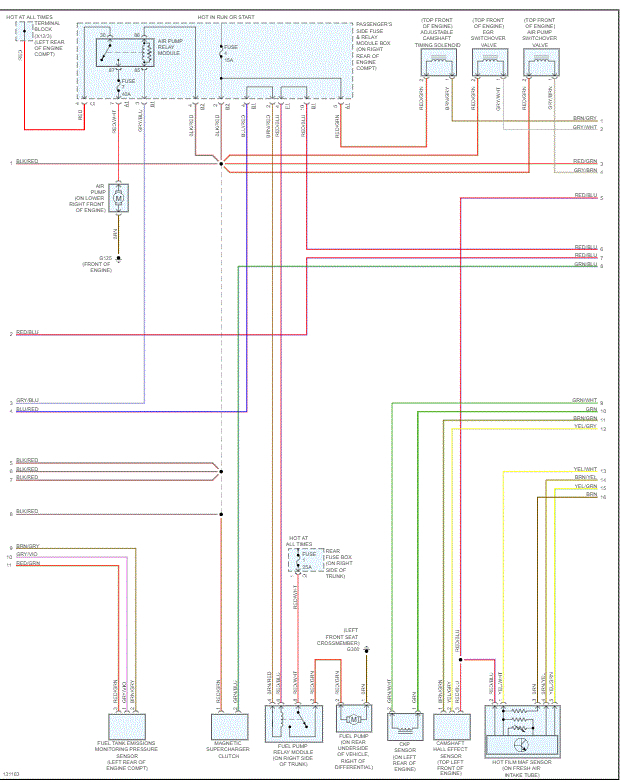

  • 110,244 POSTS
I thought that is what was needed. LoL
Here are the power-train control schematics. Let me know if this helps. Please remember, these are from a C230.
