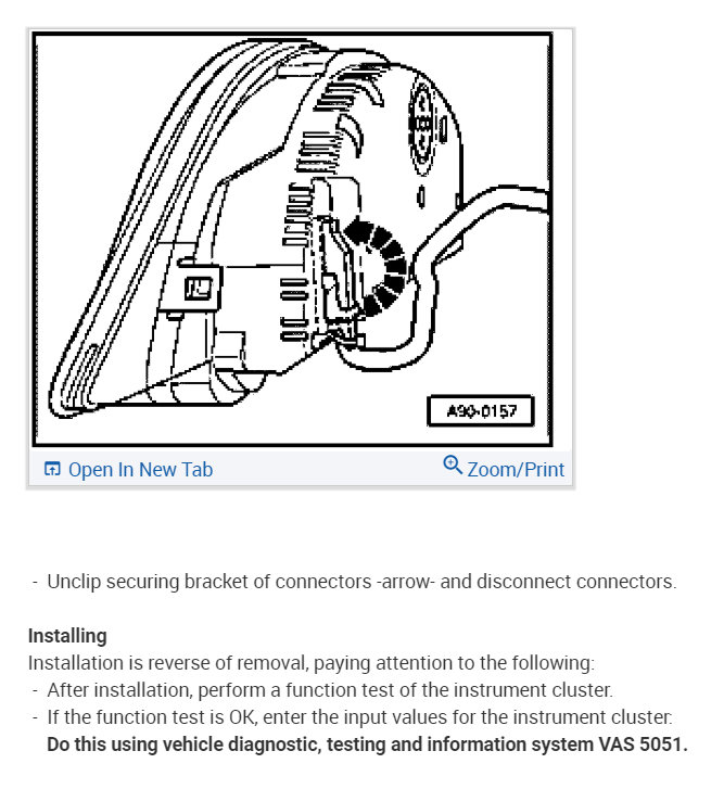

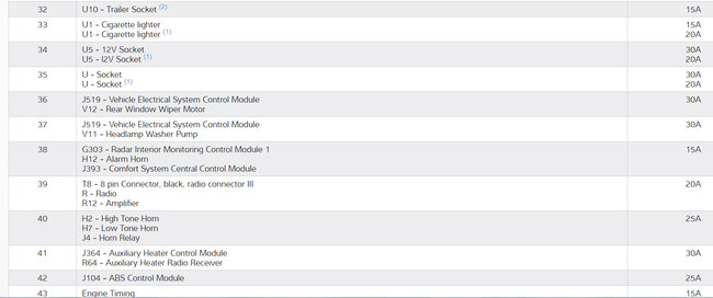

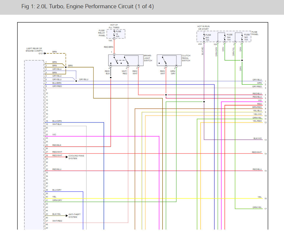

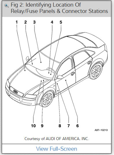

It cranks,no spark, no fuel spraying on injectors.it cannot read while using a diagnostic machine but the cluster has all light.no engine light only. I took the computer box to the dealership they said the computer box is okay, but the code was no communication with cluster.
Nov 12, 2019 at 11:07 PM
  • 55,851 POSTS

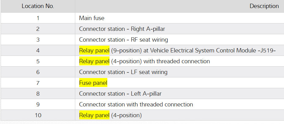

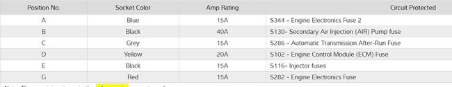

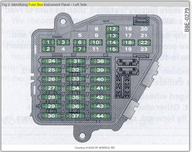

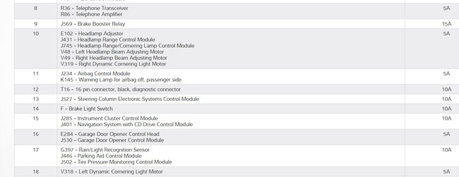

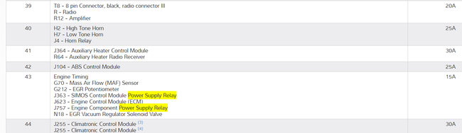

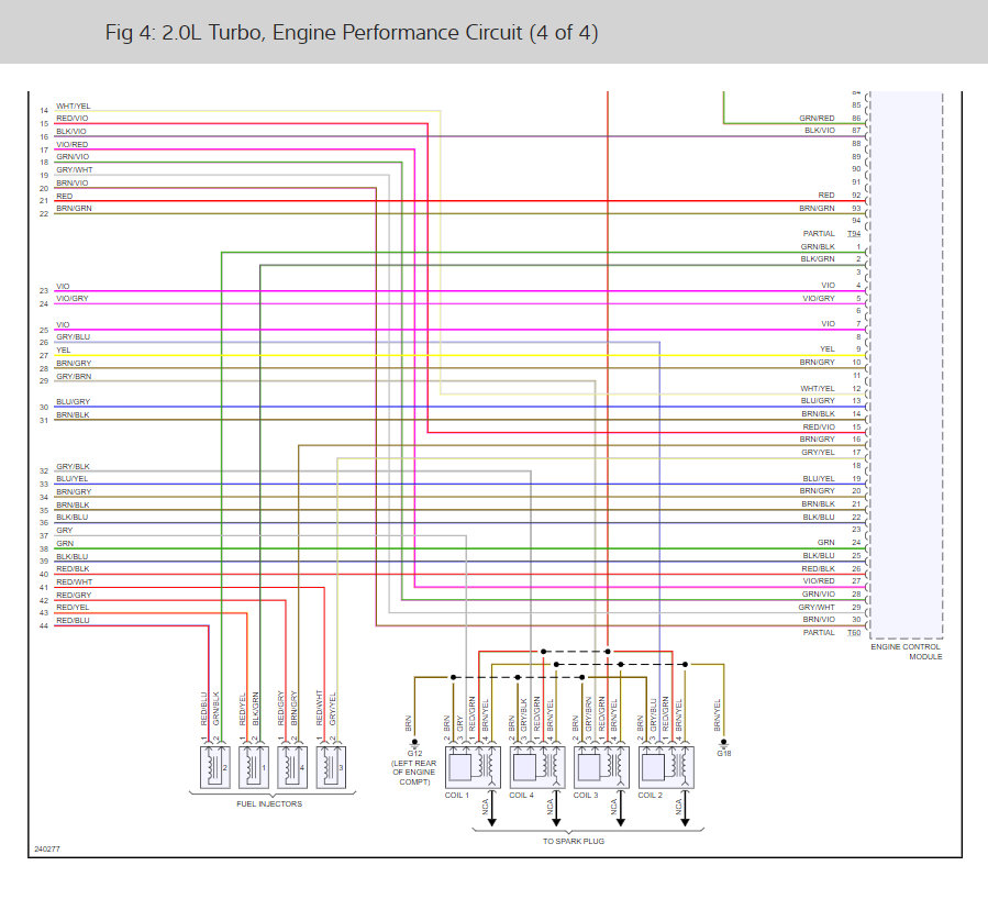

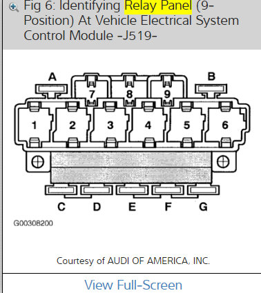

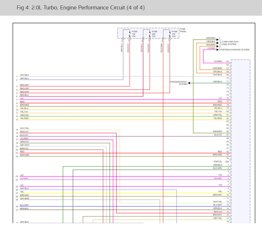

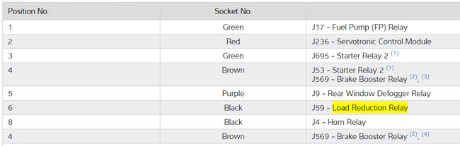

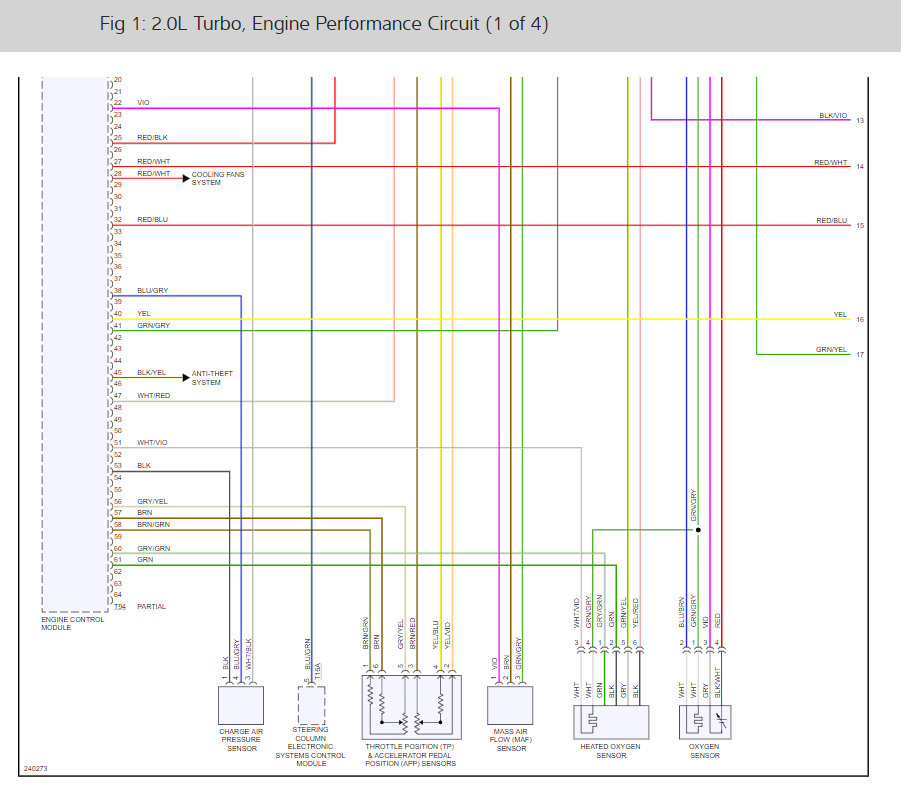

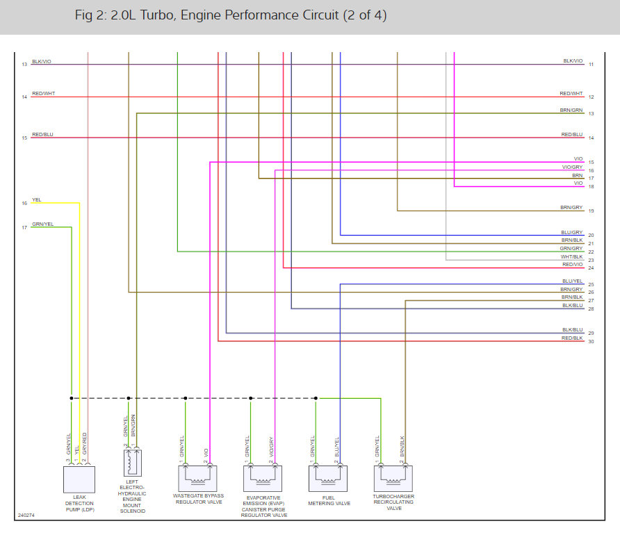

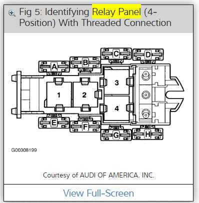

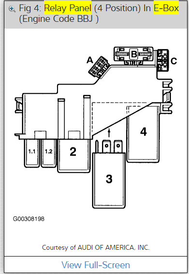

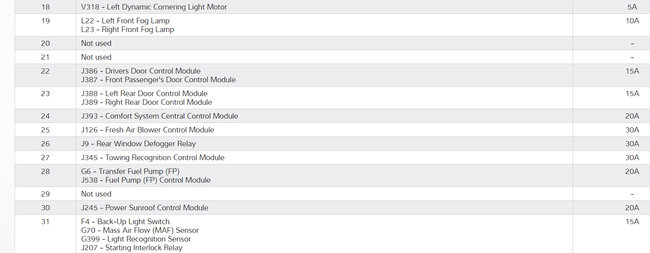

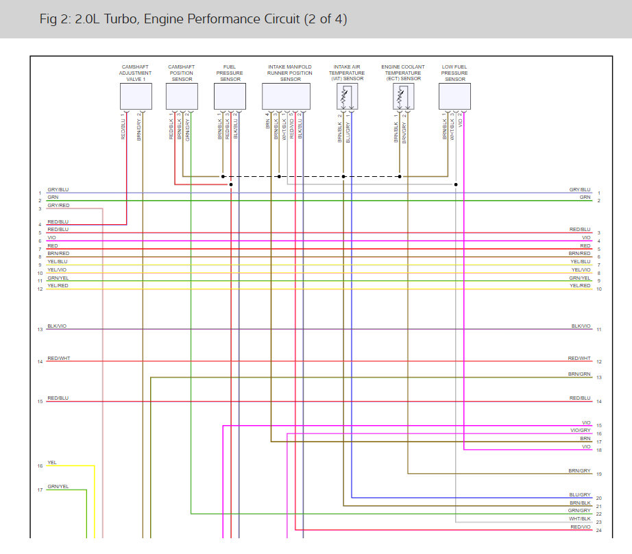

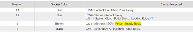

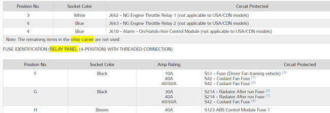

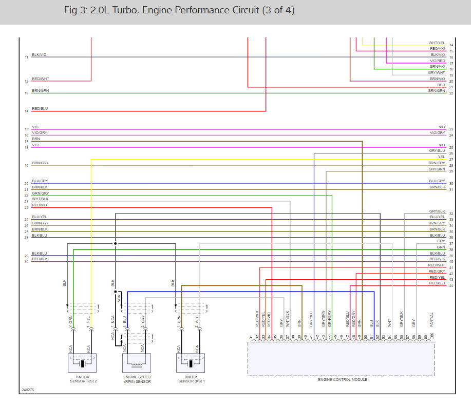

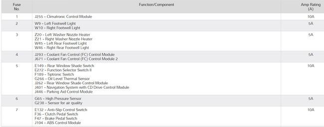

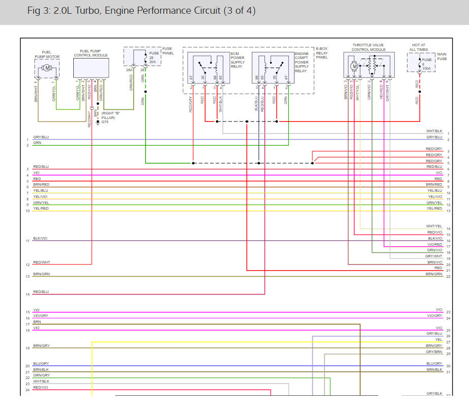

There are 6 fuses and two relays that need to be checked for power here are the engine wiring diagrams so you can see how the system works and which fuses to check. Also we need to check the ECM and engine compartment power relays. Here are two guides and the fuse and relay locations as well:
and

Alright thank you sir. the fault code that I got when I was trying to test if the computer box is still working was no communication with cluster,electric position sensor drive and fuel pressure regulator valve.it has no engine light when I put the key 'on' position. The cranks only no start ,no fuel no spark. it can't read my diagnostic.
Nov 14, 2019 at 4:14 AM
MAKHELE5
  • 5 POSTS
The car is Audi A3 2005 Automatic ..engine code BLR.
Nov 14, 2019 at 4:18 AM
  • 55,851 POSTS

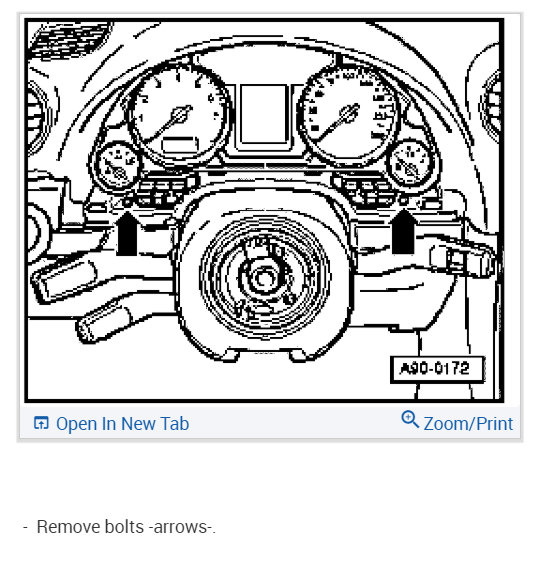

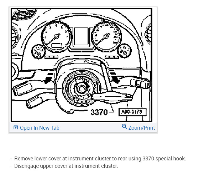

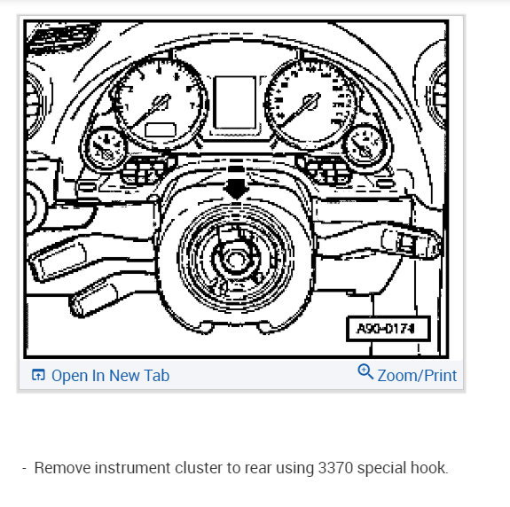

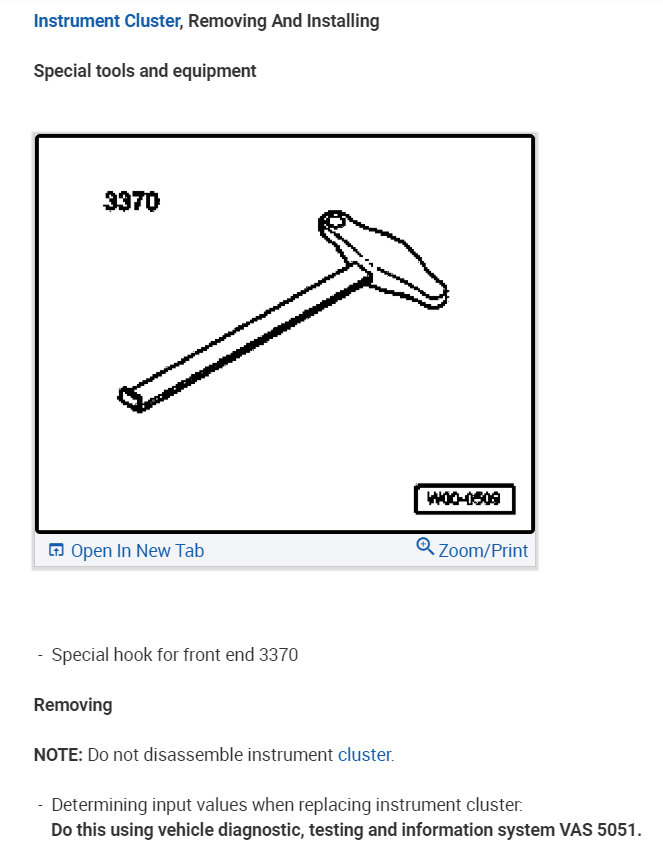

Yep it sounds like the cluster has gone out if all fuses and grounds are good. Here is a video of the job being done on similar car (steps and the same) with instructions in the diagrams below to show you how on your car:
https://youtu.be/_HEC44xENxw
