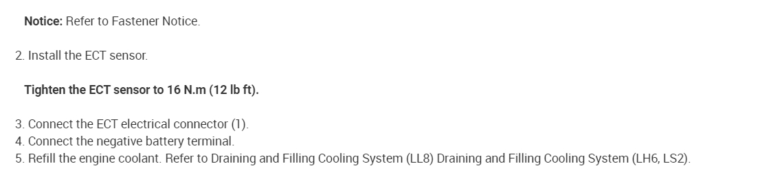

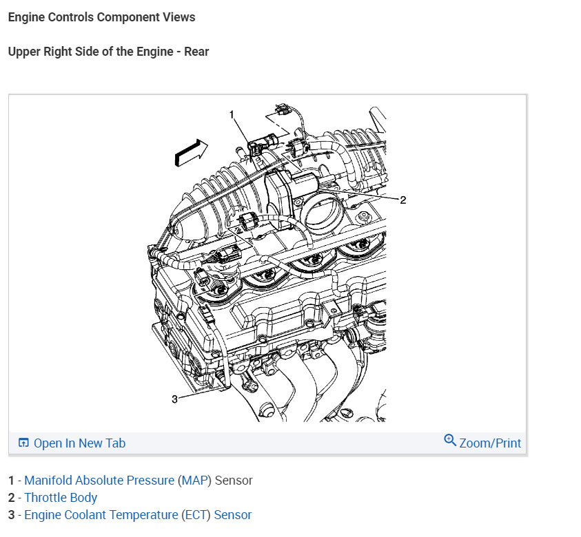

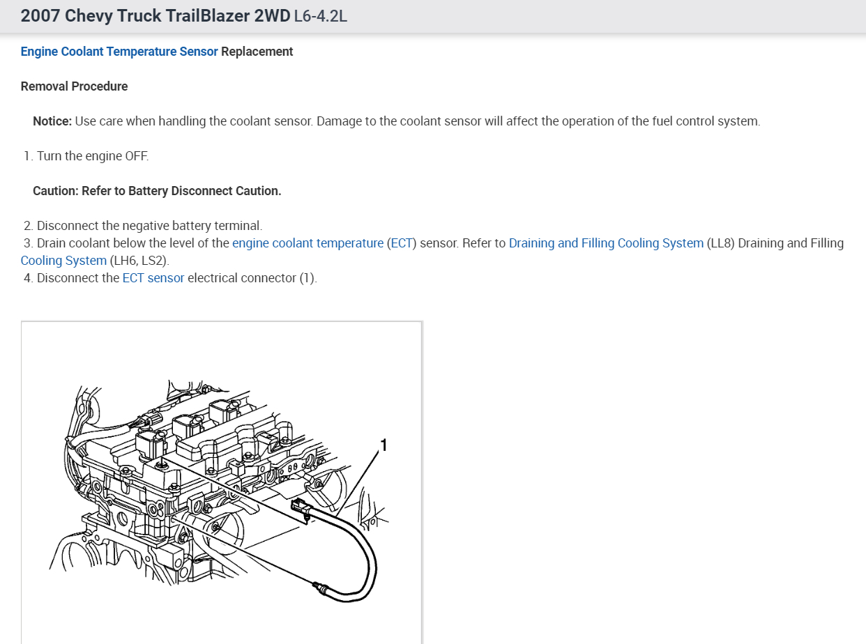

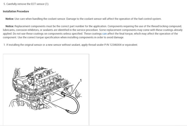

This happens when the engine coolant temperature sensor goes out, but we should run the codes first. here is the location of the sensor just in case you want to change it out. You can get a code scanner from Amazon for about $20.00.
Here is a guide/video to show you how:
Here is a scanner link:
https://amzn.to/3Qi1SS6
