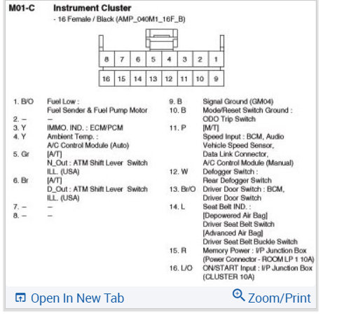

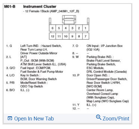

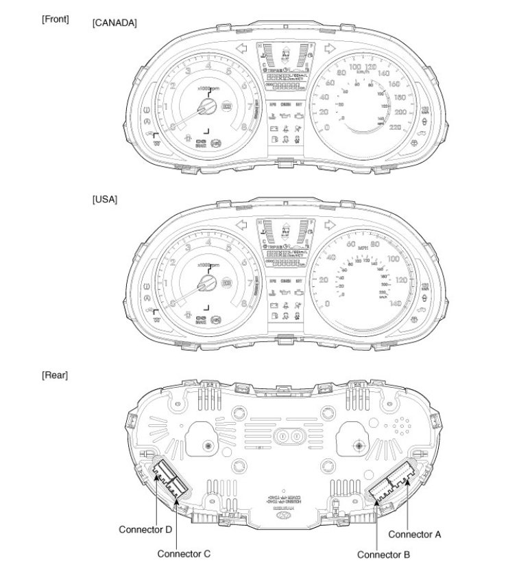

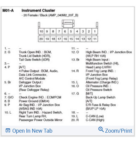

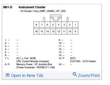

Can I modify my car listed above and put a bubble like speedometer from a 2013 Hyundai Elantra on the Hyundai accent?
I don't like the flat surface of the speedometer I love that cat I just wish to make the speedometer raised, bubble like like the Mazda 3 2013 or Kia Rio 2014.
Jan 6, 2020 at 9:44 PM
  • 55,433 POSTS
Chances are you cannot interchange these clusters. To be sure check the wiring connector at the rear of each cluster. If the same the new cluster may need to be programmed by a shop to work should cost about $130.00. Check out the diagrams (below). Please let us know what you find. We are interested to see what it is.
