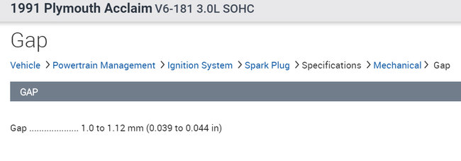

Put new plugs wires, cap, rotor button. car still has bad miss but have went to Indiana to Florida in last eight months. but hard to get up speeds good and hills.

This could possibly be a spark plug issue. Have you checked the gap on the spark plugs? I have included the gap information down below in thew diagrams.
