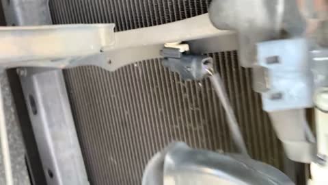

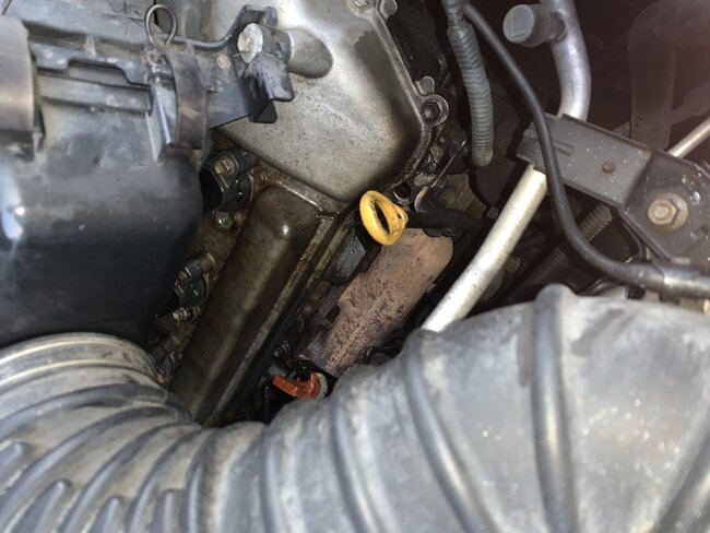

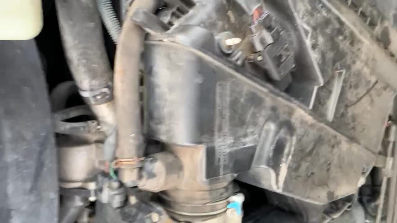

When I start my car, it makes a weird sound, and I cannot tell if it’s the engine or not. There is also oil on the passenger side of the engine where the ignition coils are located.
Jan 6, 2023 at 5:58 AM
ACRAWFORD2023
Forgot to say that the sound also increases while driving.

The oil leak looks like a possible valve cover gasket leaking.
Gasket replacement:
https://www.2carpros.com/articles/replace-valve-cover-gasket
