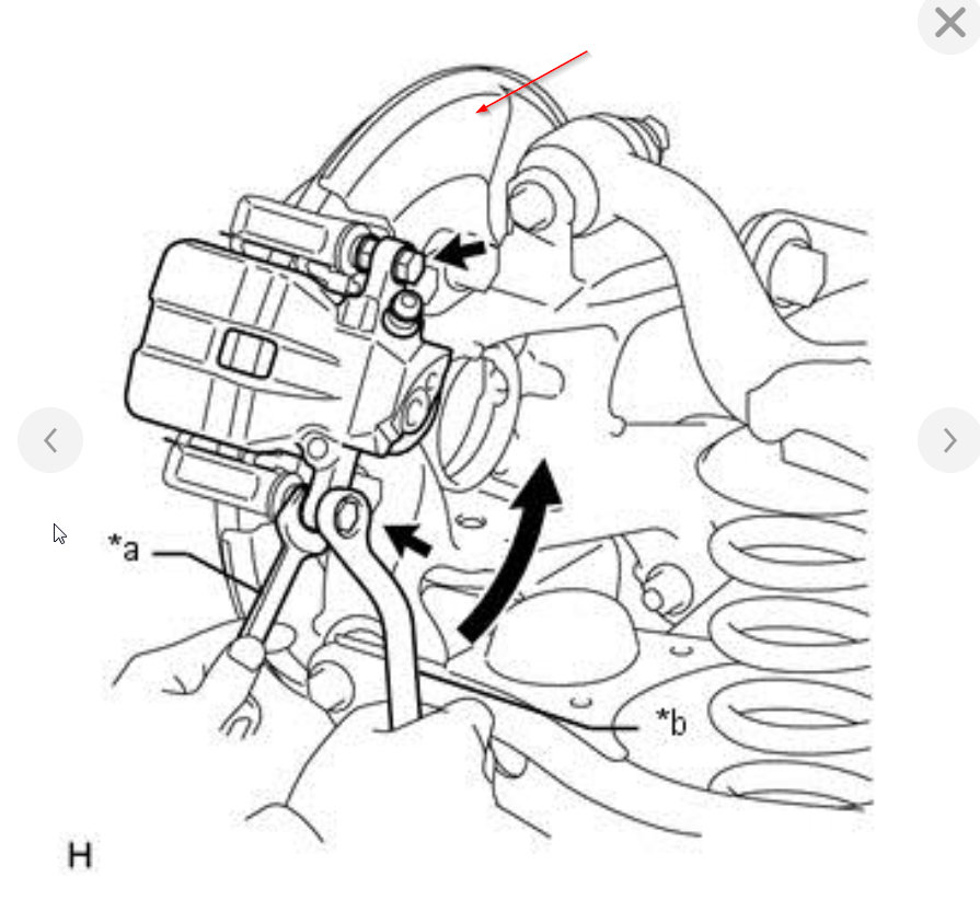

Hi, thank you for your help. I tried tapping everywhere and I don't hear the rattle. I've realized the rattling/clanking gets louder when I'm steering/turning to the left and it is much quieter when steering/turning towards the right. Would that change your guess for the cause?
Jun 13, 2020 at 11:01 PM
It doesn't change what I think it is in that it is a loose piece of metal rattling on anther piece of metal. It may not be an actual heat shield on the exhaust but this would be the most likely and most common cause of this noise.
So if there are no heat shields rattling then we need to try and use this same technique on as many components we can find. Starting with the backing plates or dust shields that are part of the braking system. This would fit with the idea that it makes more noise when turning.
These dust shields are basically there to protect the brake rotor from things kicking up from the road and try to limit the brake dust from getting on the suspension components. If they are loose or bent they will make contact with the rotor and cause this noise. Normally they make a scarping noise but we need to check them.
