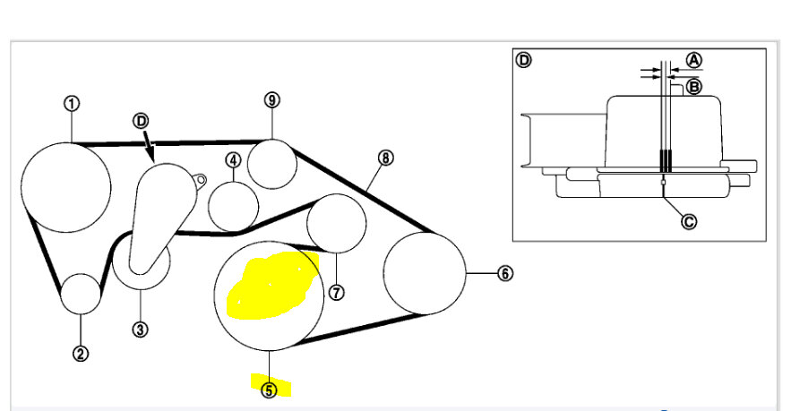

No problem. If the starter is clicking, it usually indicates a weak battery. However, you indicated a new battery made no difference.
If the battery is new, the alternator, and the starter, my concern is the engine may have locked. The only way to check this is by turning the crankshaft to see if it moves.
If you look below, I attached the serpentine belt routing diagram. I highlighted the crankshaft pulley. There will be a bolt centered in that pulley. You need to place a socket on it and using a breaker bar, see if you are able to turn the engine by hand. It will be tight, but you should be able to turn it.
If you can, record the clicking and upload it for me to hear. It may help me determine what is happening.
Take care and let me know what you find.
See pic below.

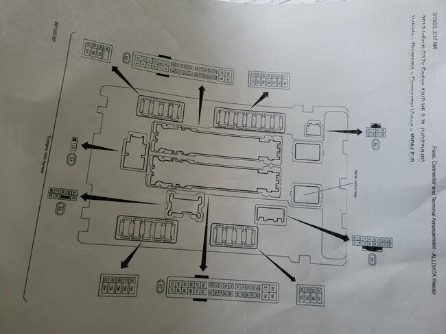

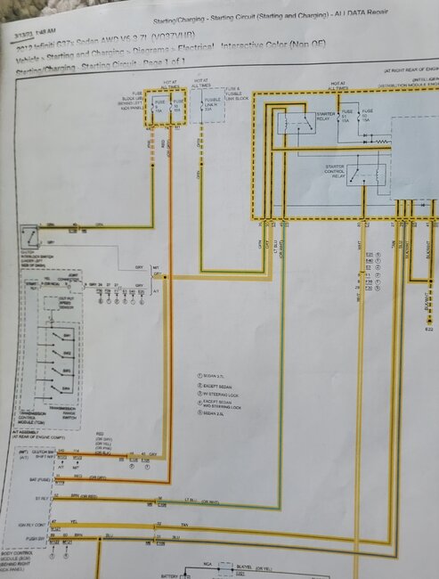

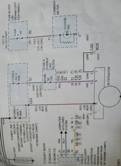

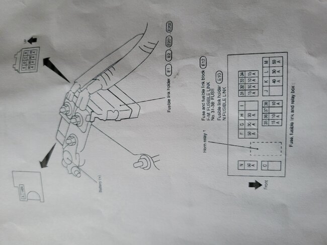

I know it took him 3 hours he printed out the diagram to the wiring system then hooked up some type of computer and when by down each module he said and it was giving error codes that he had to clear.
Mar 15, 2023 at 9:36 PM
KENDIBELL1
  • 14 POSTS
These are the diagrams he printed out and followed he told me to get up to see if it cranked right up and it did seems like it has more of a kick to it now when it cranks.

Thanks for the update. I suspect it was either related to a fusible link or one of the relays. I can't read what is highlighted in pic 1, so I can't be sure.
Regardless, I'm glad to know it's fixed.
