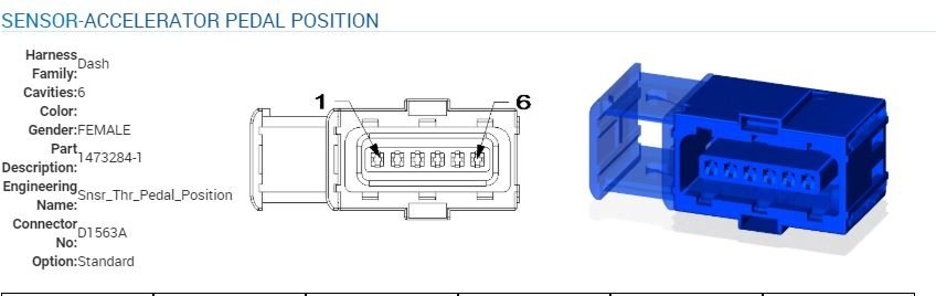

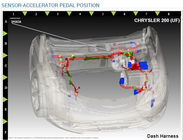

Okay, then that is related to the throttle control system. In the old days, there was a cable which attached the throttle pedal in the vehicle with the throttle body. However, that has all changed. New vehicles use a accelerator pedal position sensor and other sensors to tell the engine how much power is required.
On this vehicle, the accelerator pedal positions sensor sends a signal to the power-train control module (PCM), and then the PCM tells the throttle body how to respond. If you have no codes, I would be totally guessing if I recommend replacing components. That, and the car being so new and with such fuel miles, I would almost suggest debating the repair of the problem with Chrysler.
The testing (since there are no codes) will need to be done via a live data scanner. The technician can tell if the pedal sensor is working, if the throttle body isn't receiving information and so on.
Let me know your thoughts. If you can, at least confirm the connection at the throttle pedal sensor is tight and not corroded where it connects. I attached two pics. The first shows location (which is under the dash on the inside of the car. The second shows the connector.
Let me know. Also, and please understand this is an educated guess, my first suspect is the switch shown in the picture. I have a strong feeling that if it simply doesn't send a signal to accelerate, the PCM may not realize there is even an issue.
