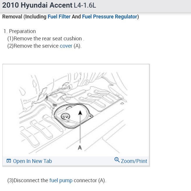

I bought the car a month ago. I changed the oil filter, spark plugs and air filter, but couldn't get the fuel filter off.
The car doesn't smoke. It doesn't leak oil, although I haven't checked again if it uses oil.
It starts fine. Reverses fine and accelerates well for the most part. It struggles terribly uphill if I don't have forward momentum.
It sometimes struggles with power in the lower gears when accelerating as well.
What could the cause be for the lack of power?

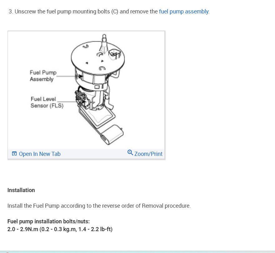

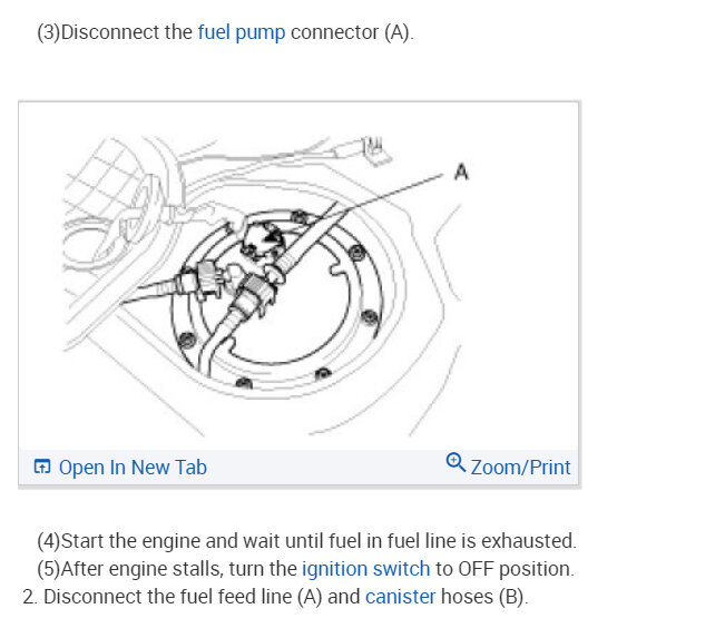

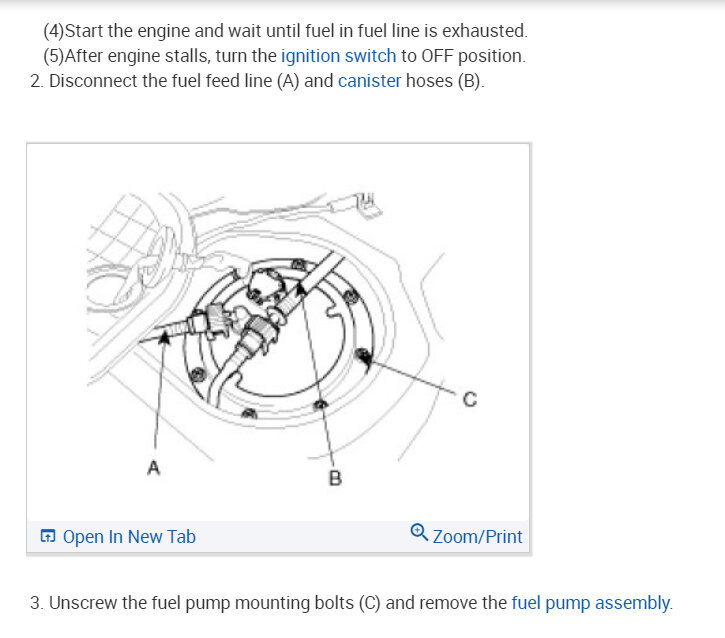

I clogged fuel filter would be #1 thing I would try first, here are the instructions on how to change it out and I have included a guide you can go over as well. Please check the air filter as well.
https://www.2carpros.com/articles/engine-has-low-power-output
Check out the images (below). Please let us know how it goes.
