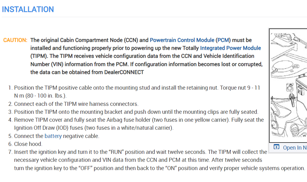

My car has been locking and unlocking itself back-to-back when shut off causing my headlights to stay on.

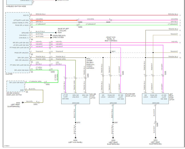

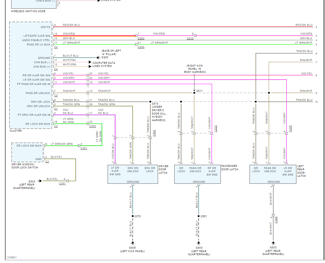

This could be one of the door latches is bad which I would guess will be the driver's door if that is the problem, we should run a can to see if any codes show up. You can get a CAN scanner (Controller Area Network) which will work on most cars from Amazon.
https://youtu.be/u-4syLc-ifQ

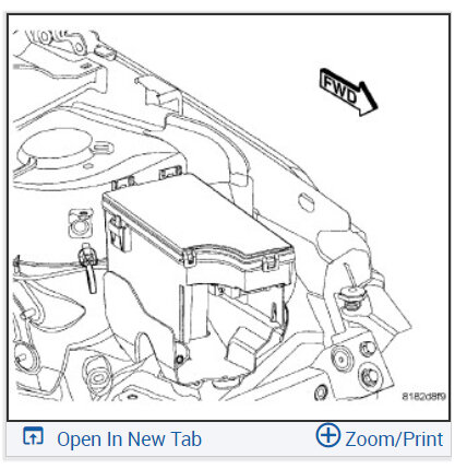

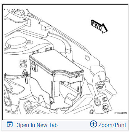

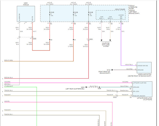

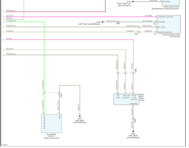

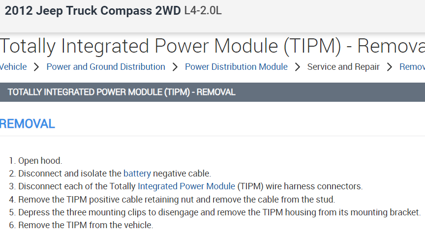

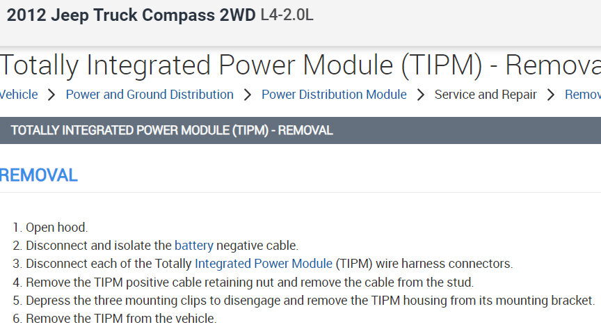

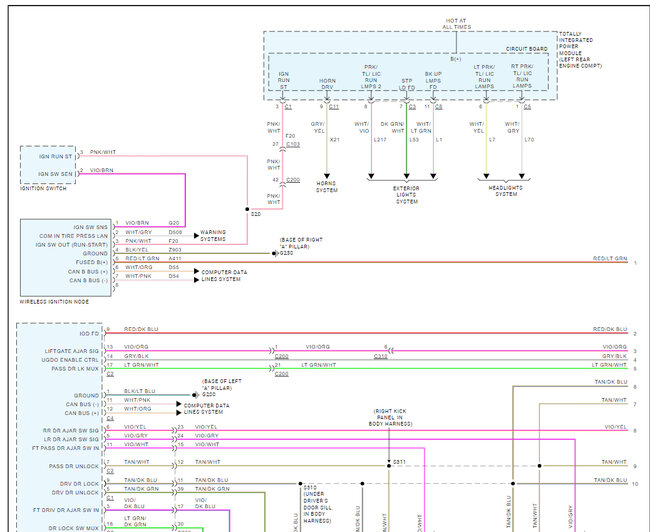

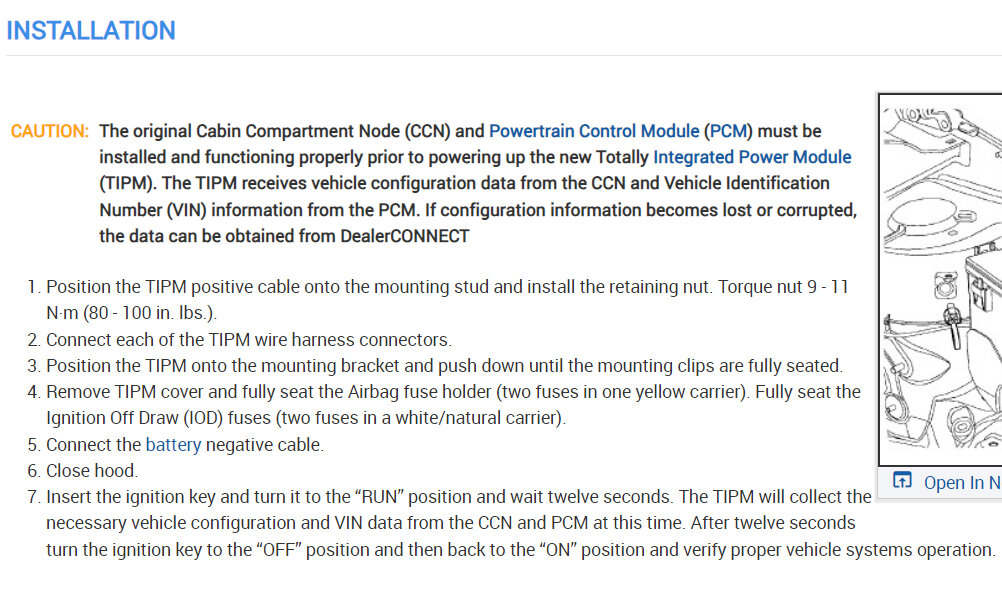

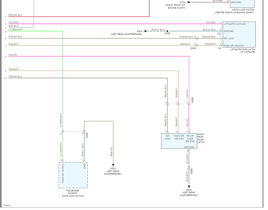

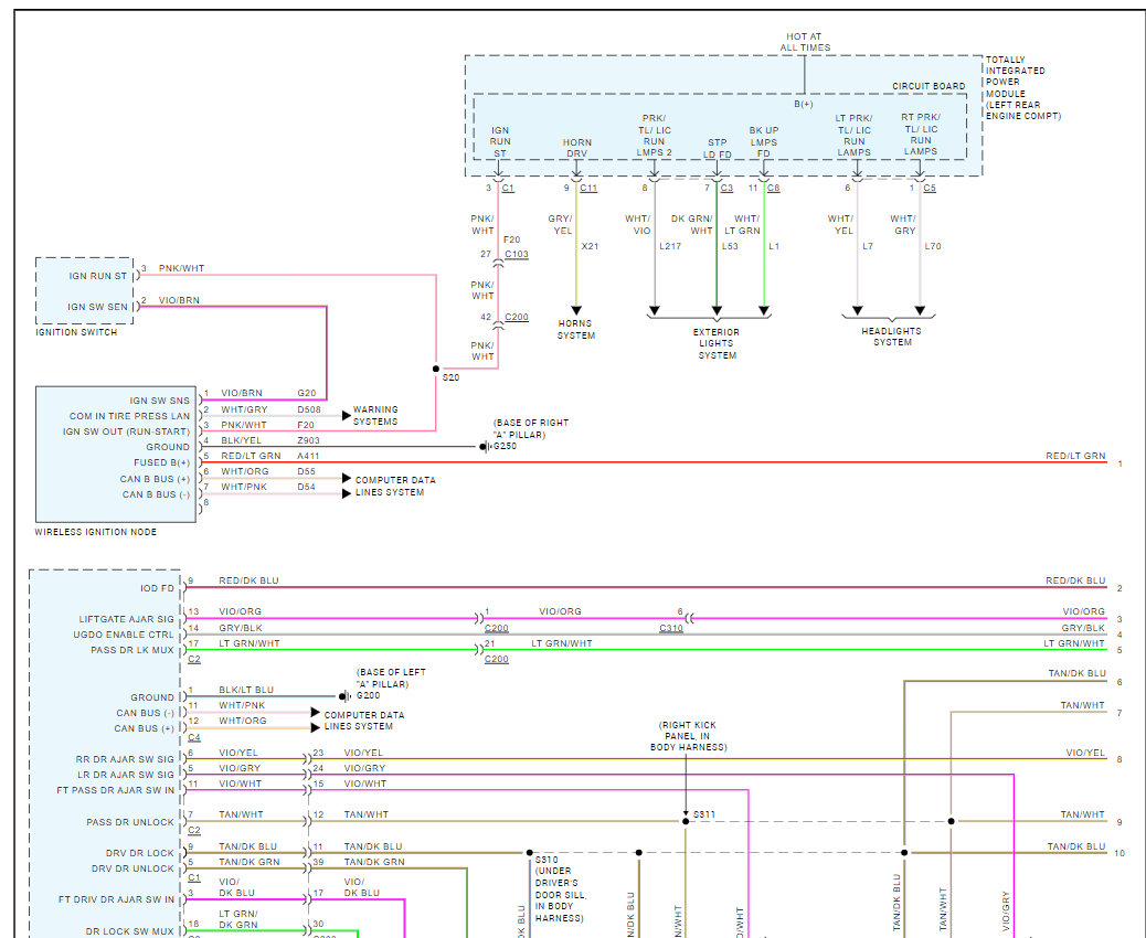

I can tell you that the TIPM in the these cars go out all the time, here are the door wiring diagrams so you can see how the system works, and I have included how to change the TIPM out which is easy to change because it self learns so there is no programming required. Check out the images (below). Please upload pictures or videos in your response to any problems so we can see what to help you with.
