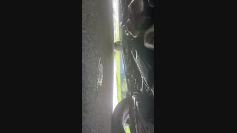

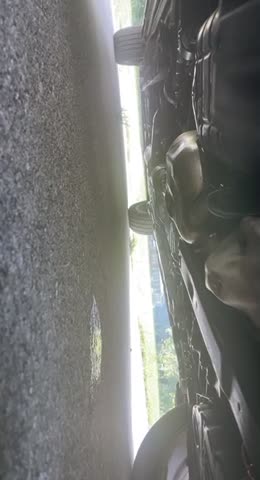

My car turns over properly but takes about three seconds to start. The starter, camshaft sensor, spark plugs and coils are all new.
It has an oil leak coming dripping from the bottom. It smokes but not a lot. I can see the leak when it’s parked.

I watched the video. Is that coming from the engine or the transmission? Toward the end of the video, you show the bottom of the transmission and oil dripping off it.

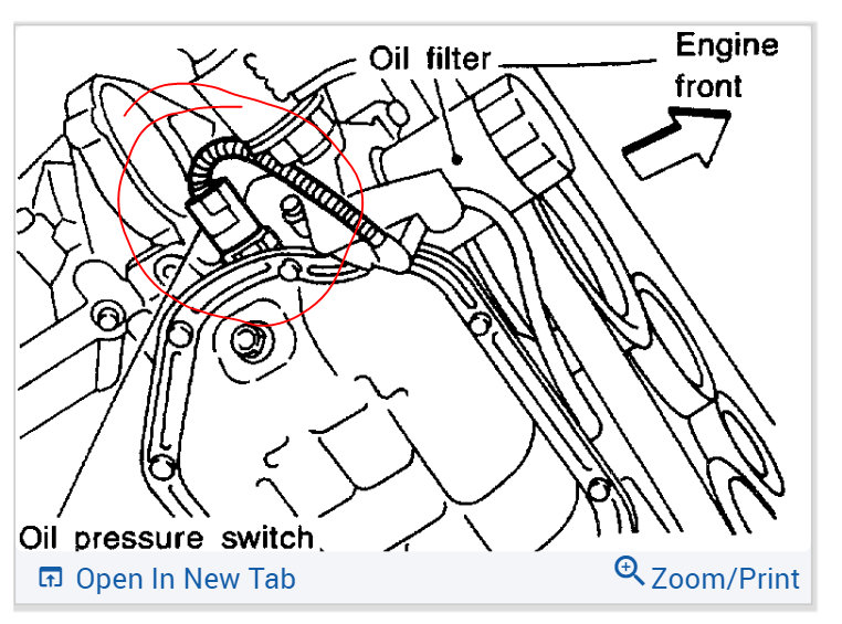

If it is motor oil, the first thing to check is the oil filter. Make sure it's tight and inspect if it is wet where it mounts. If that appears okay, the next thing to check is the oil pressure switch. They can fail and oil comes right through them. If you remove the connector, check to see if there is oil where the connector goes. See pic below
Also, if possible, see if you can check if it is running down from something like the valve cover. If there is no evidence of any of these things, suspect the rear main is leaking into the transmission bell housing and dripping out where the engine/transmission meets.
joe
See pic below.

Checked everything you said and it’s the rear main seal. Thank you
