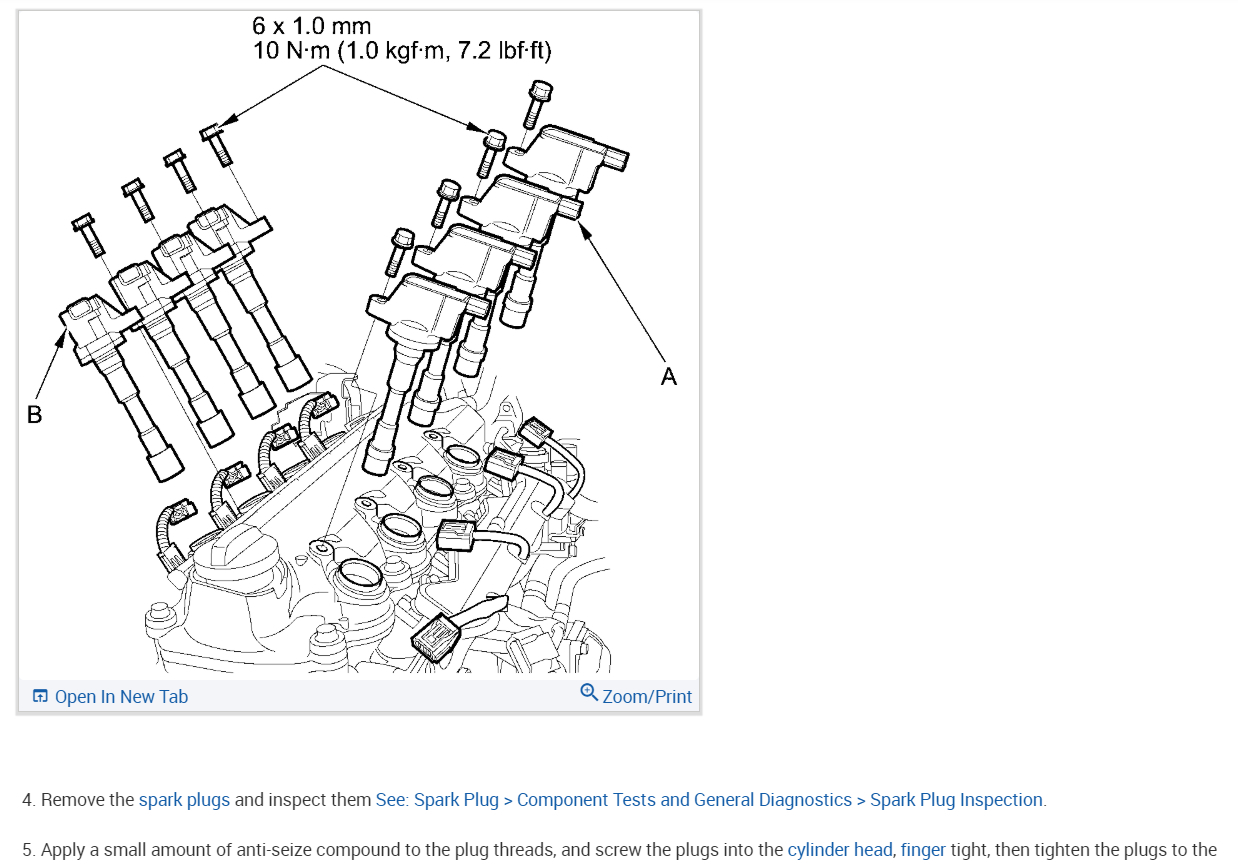

Hi
I am using honda insight 2010 japan domestic model. I am using it in sri lanka. It has all options including navigation. The engine is missing with a code p0302 ?
please give me a solution if possible. ..
thank you
chpika piyarathna
Feb 9, 2015 at 12:16 AM
KHLOW2008
  • 41,814 POSTS

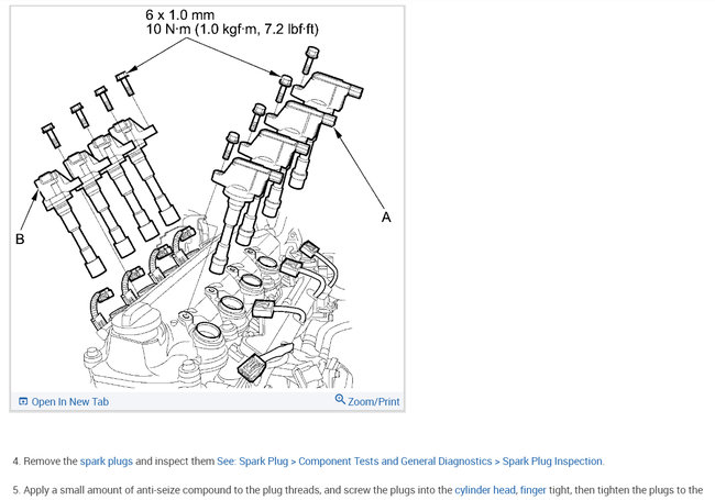

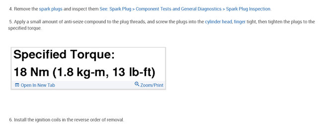

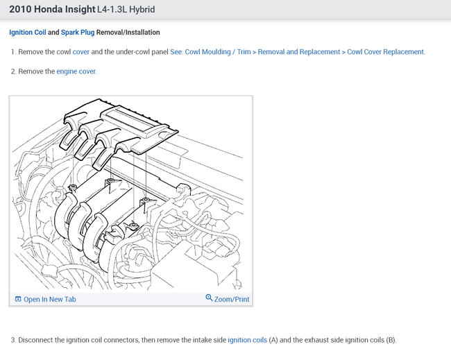

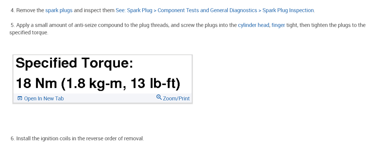

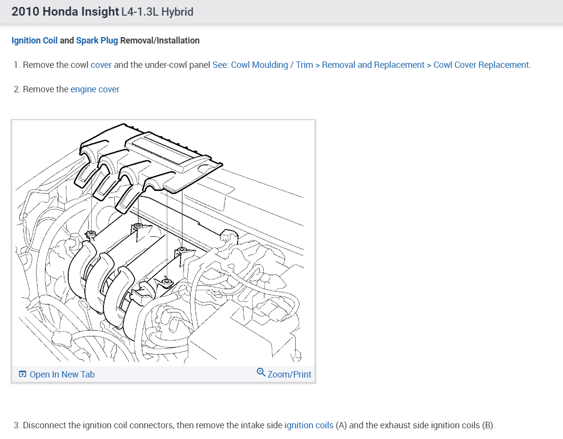

I would start with an engine tune up here is a guide to help walk you through the repair with instructions in the diagrams below to show you how to fix it on your car.
https://youtu.be/k1KGussrTJA
