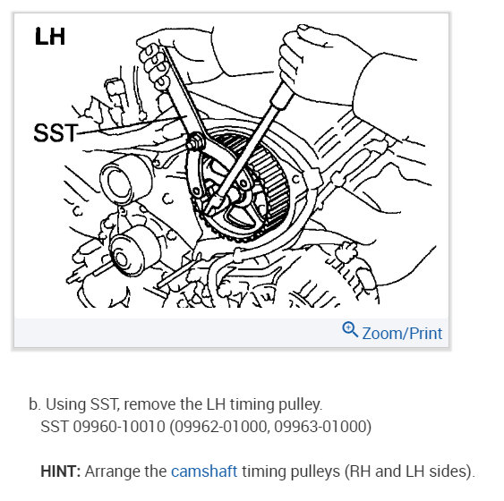

After a major engine dissembling and fix, the camshaft position sensor p0340 code came up, meanwhile the engine had difficulty in starting to confirm the failed sensor at bank 1. Please note during this period once started, it idle's real good."no knock noise" at the bank 2 top. After linking the sensor back to ECU, the engine starts without difficulty but after three to five minutes, knocking sound is heard from bank 2 top. If the sensor is disconnected everything runs without noise. What could be the problem?

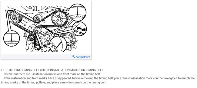

The engine will need to come back apart sometime is wrong inside. It sounds like the timing belt is too tight. I would remove the serpentine belt and start the engine again, if the noise is still there get started taking the engine back apart. Thanks for the video please upload more videos once it is apart so I can see what is going on.

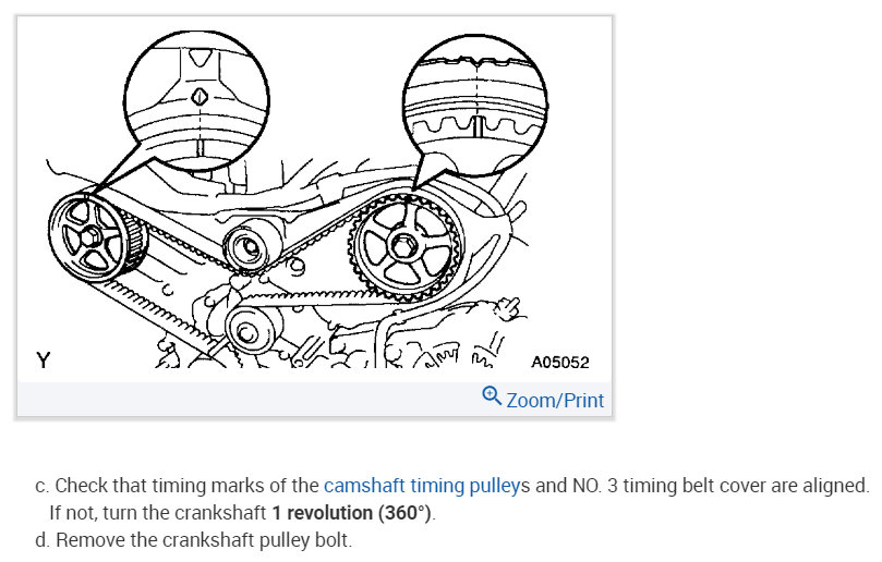

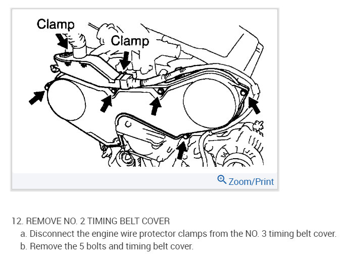

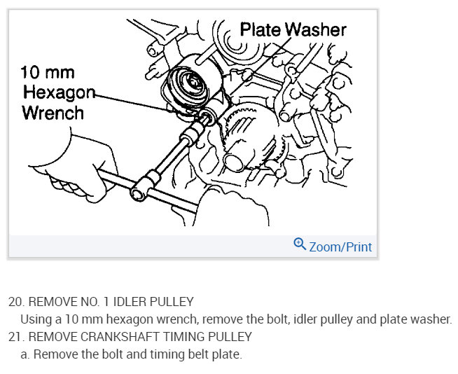

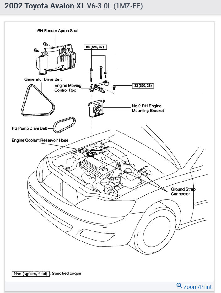

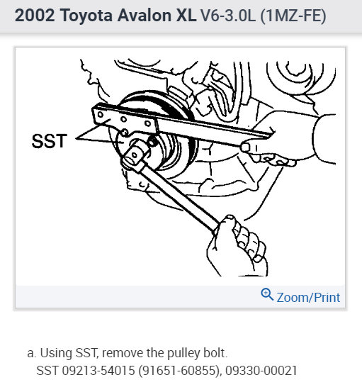

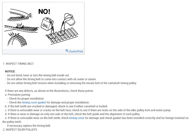

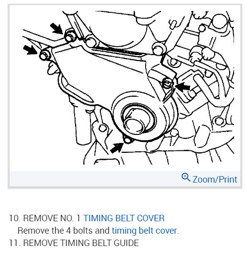

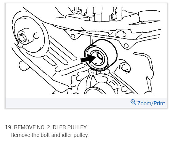

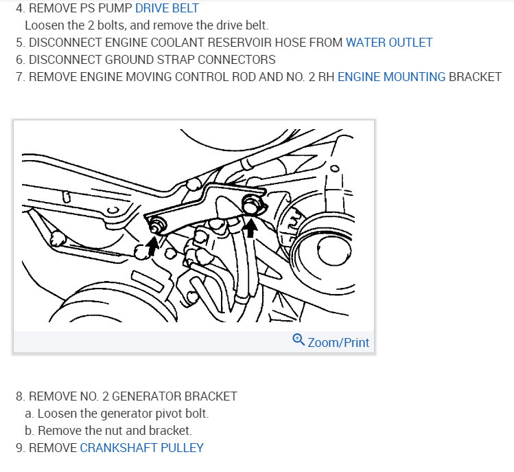

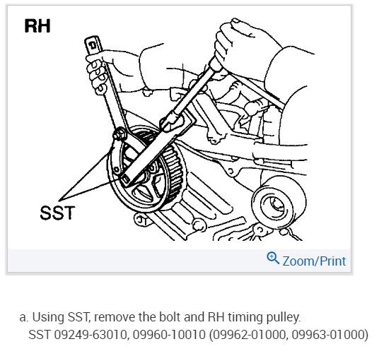

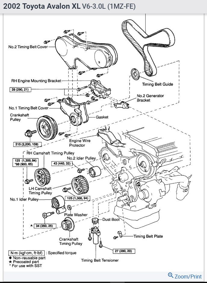

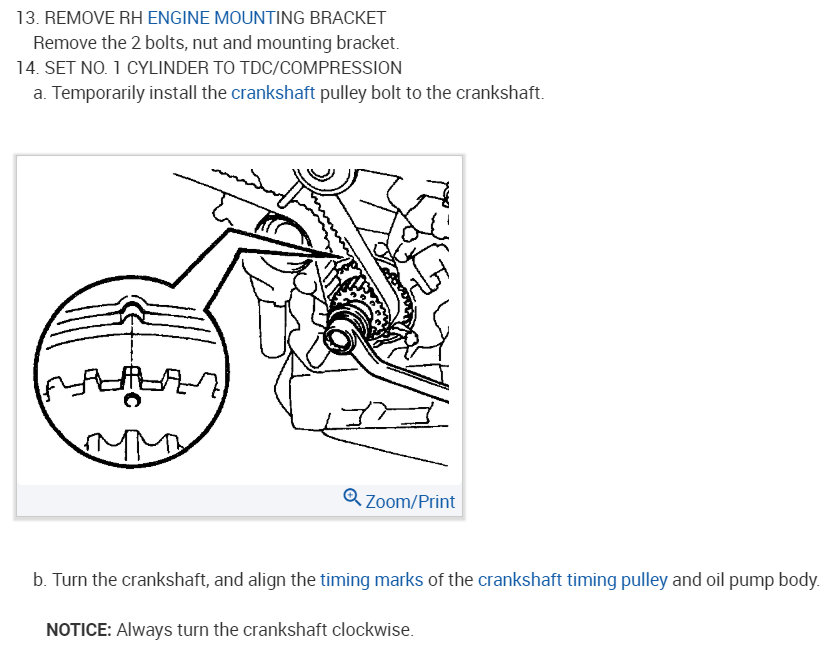

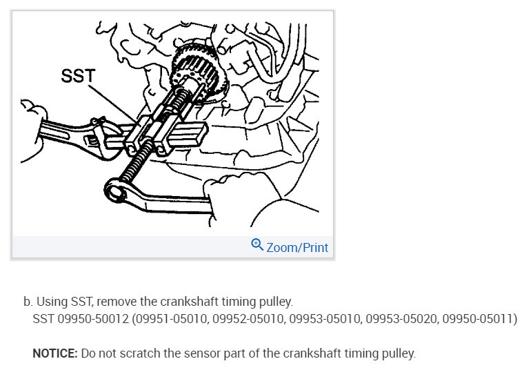

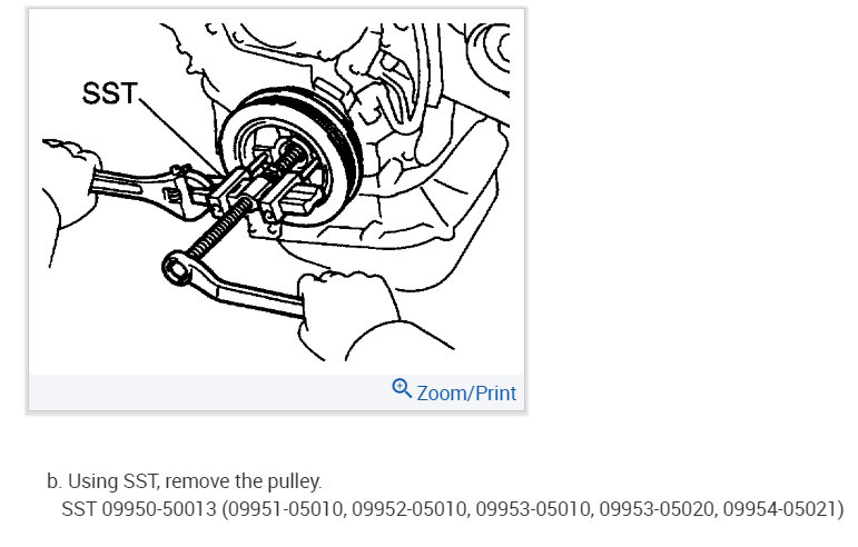

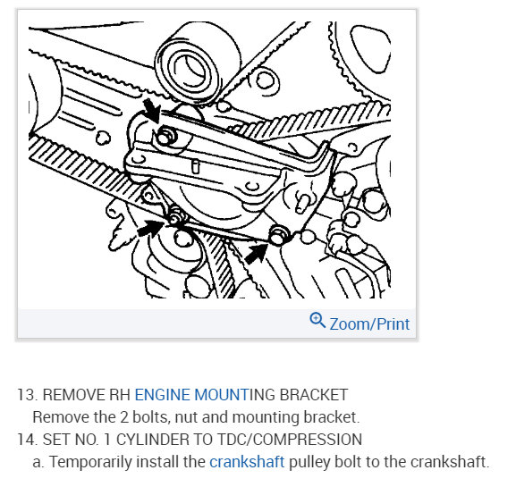

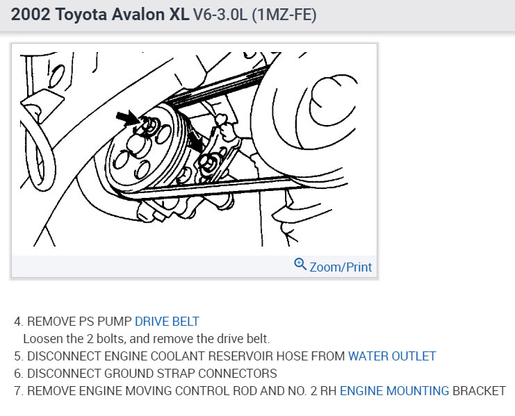

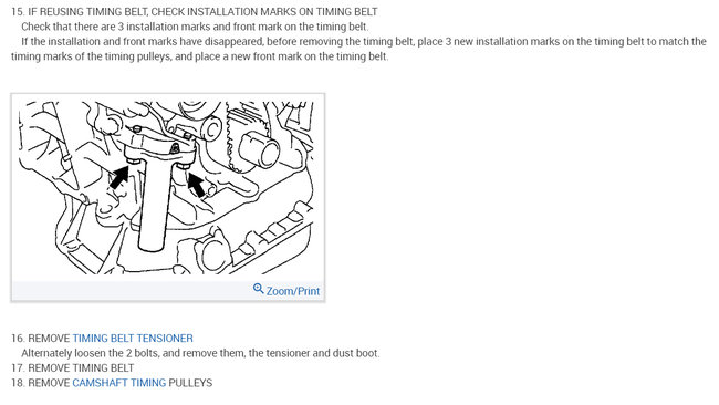

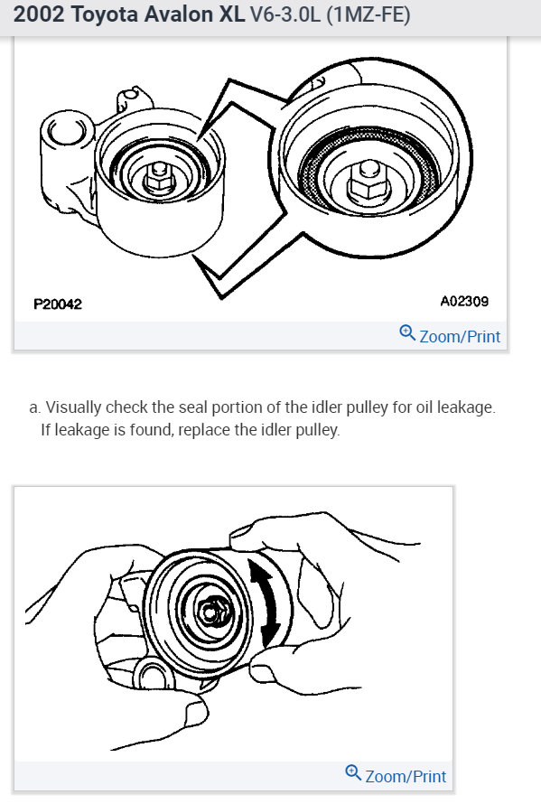

Yes, it is time to take the front back apart. It sounds like the timing belt is too tight. Here is a guide that will help and diagrams below to help get the job done. Check the idler pulleys as well.
https://www.2carpros.com/diagrams/toyota/avalon/2002
