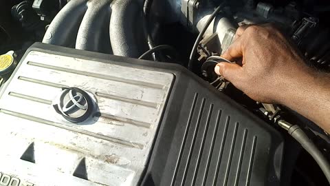

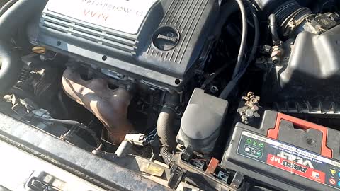

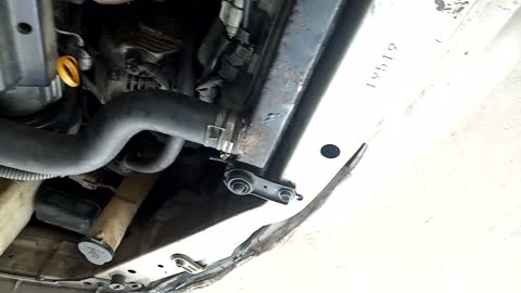

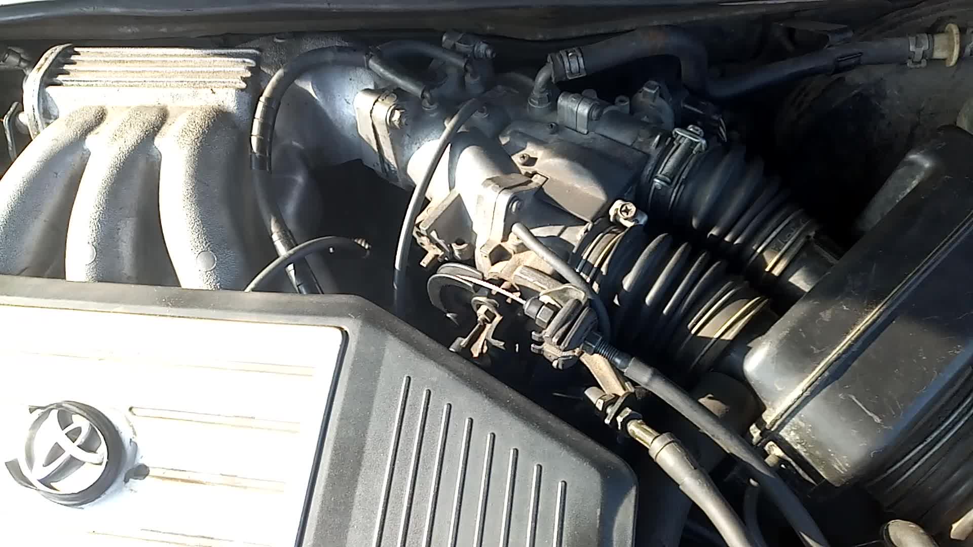

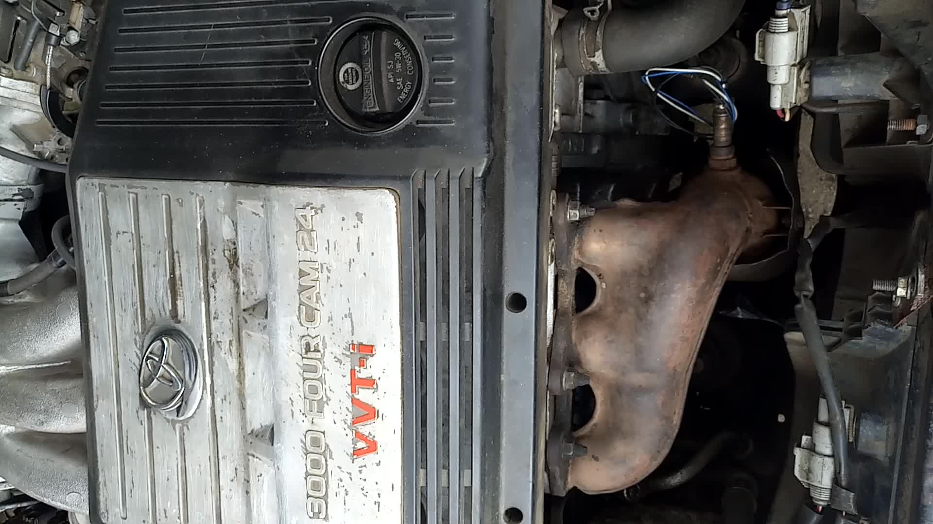

This video shows starting the engine with temperature above 80 degrees, sensor at bank 1 not connected but bank 2 sensor active as at this time. Though failed sensor reacted.
Video1===Firing without the sensor at bank 1
Video2 === Delayed engine starting
Video3 === All sensors connected

The engine will need to come back apart sometime is wrong inside. It sounds like the timing belt is too tight. I would remove the serpentine belt and start the engine again, if the noise is still there get started taking the engine back apart. Thanks for the video please upload more videos once it is apart so I can see what is going on.

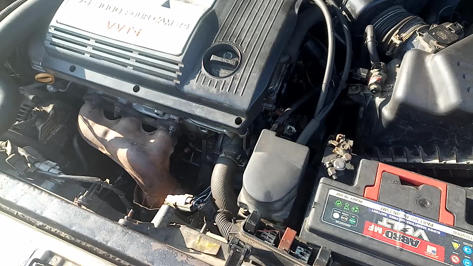

You are welcome. Though my engine runs with timing belt. Are you not suspecting something within the camshaft? Sending video three now. I will send video two later.

Video two, confirming the failed bank 1 CPM sensor. Meanwhile in the previous video three uploaded. The sensor broken wire was fixed. Check this one out.

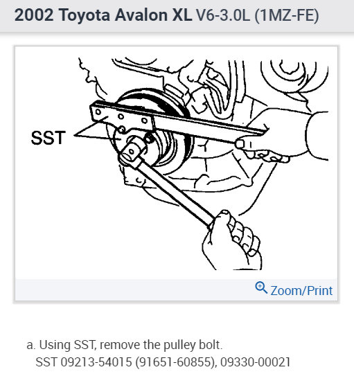

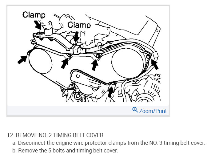

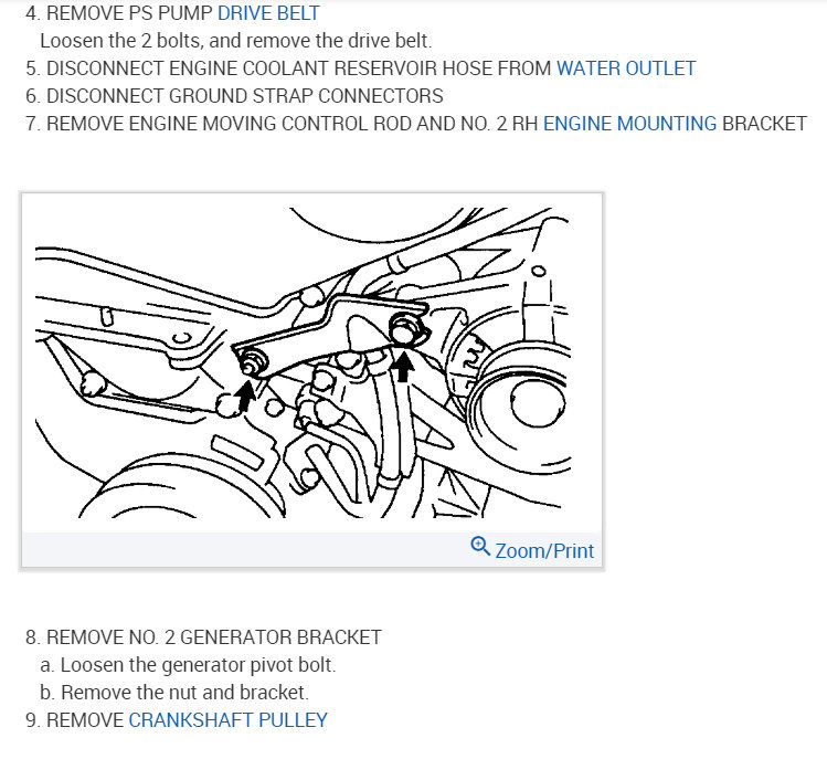

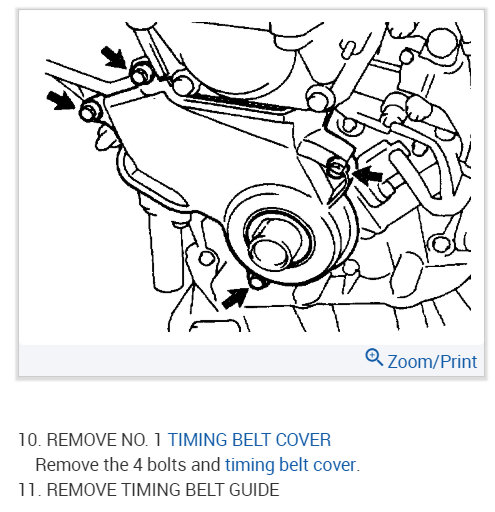

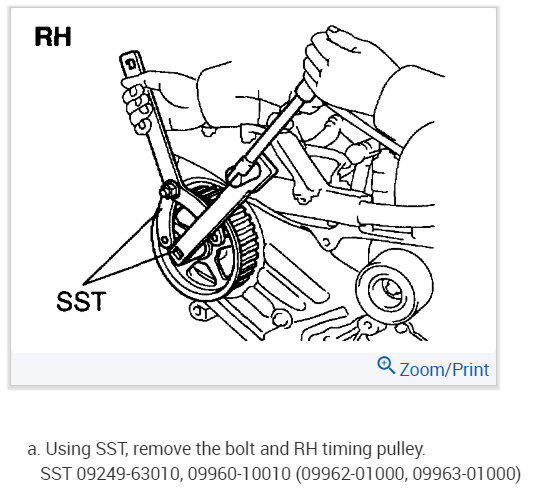

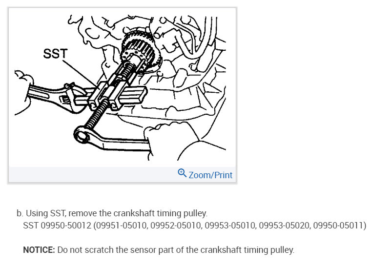

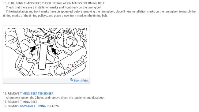

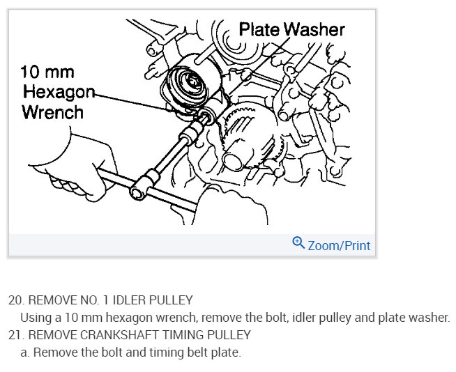

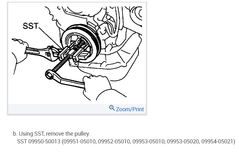

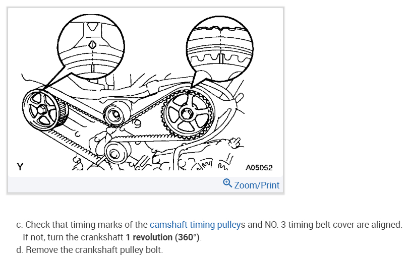

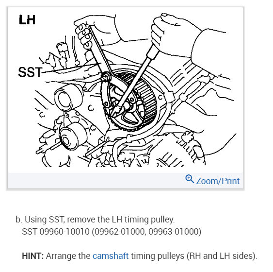

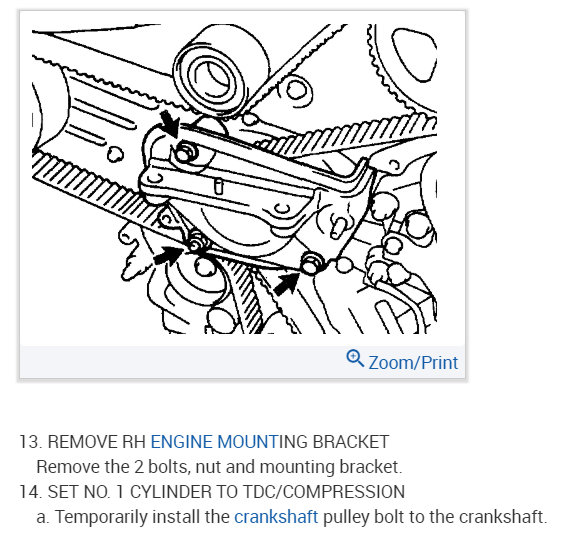

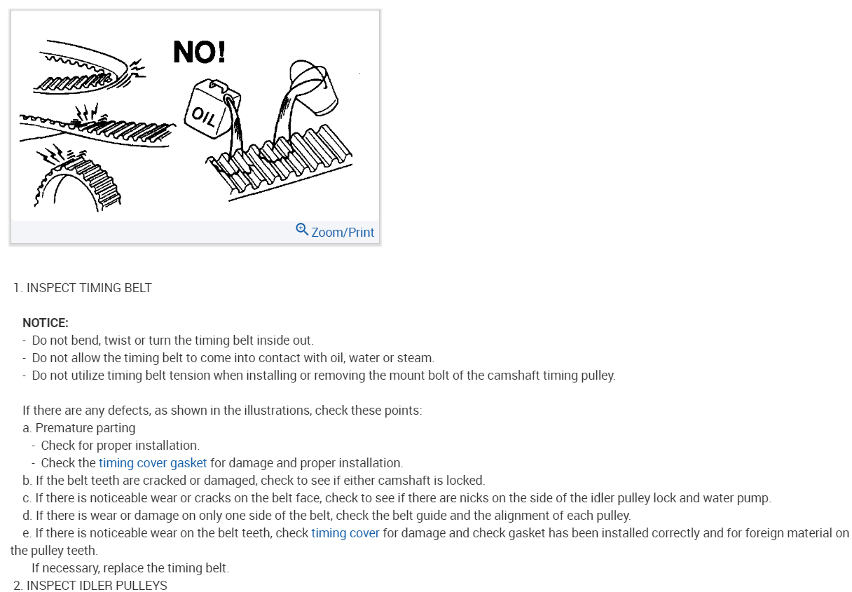

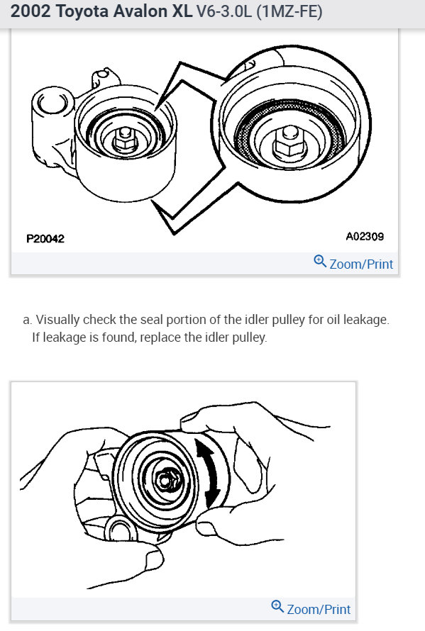

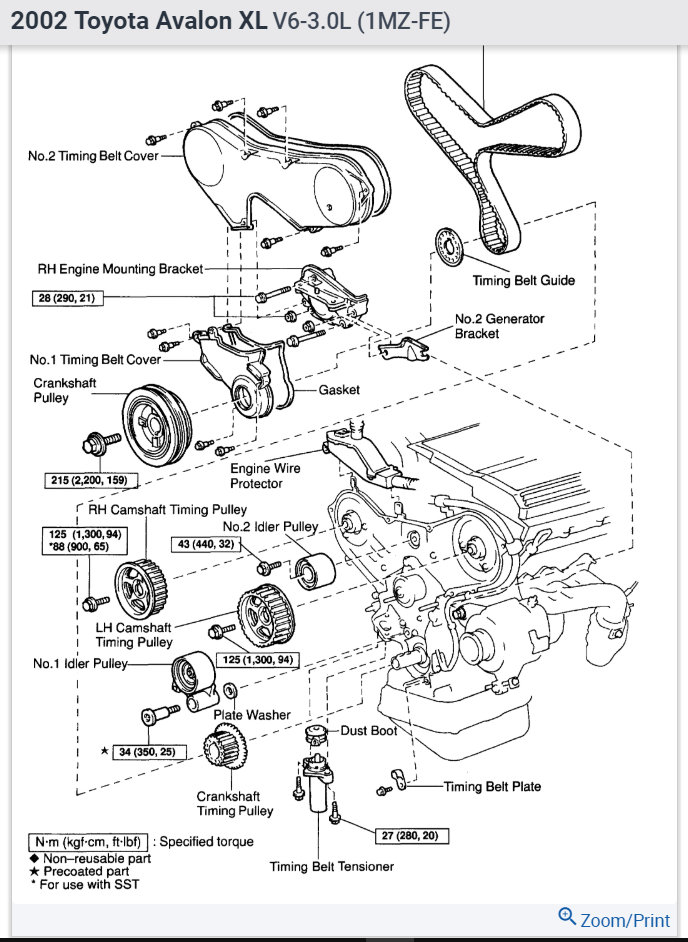

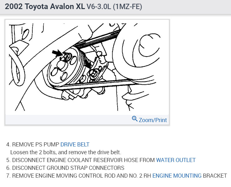

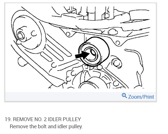

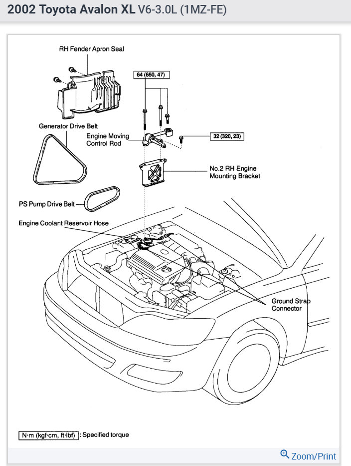

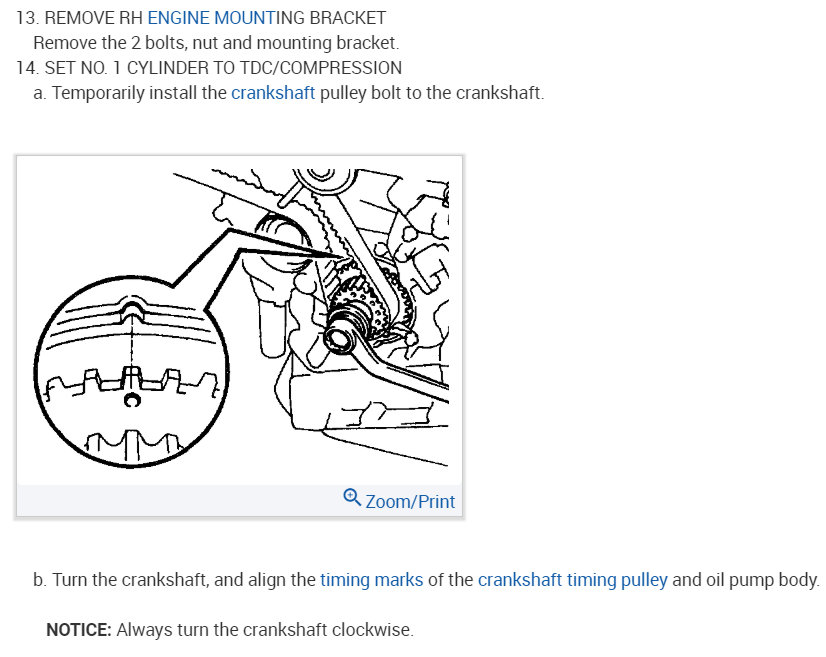

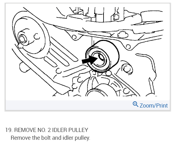

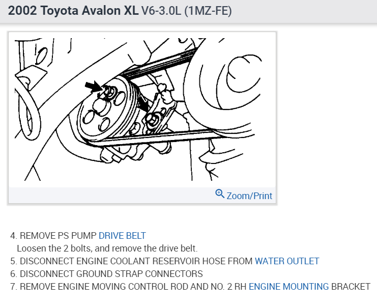

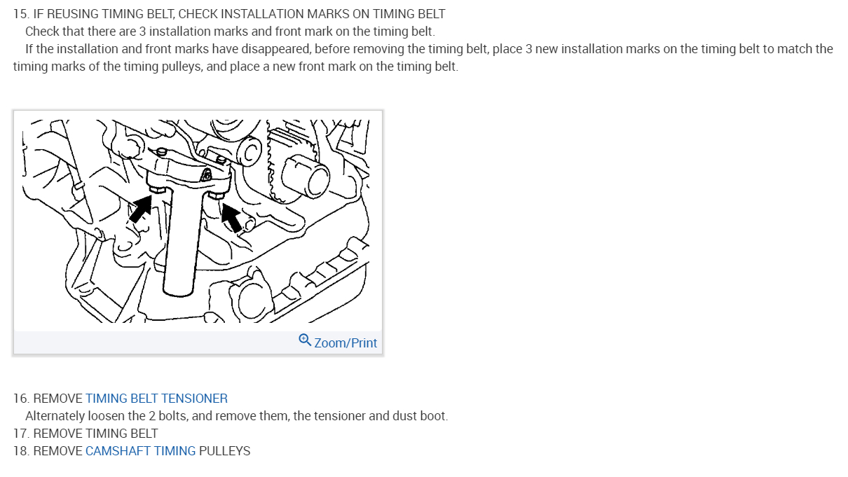

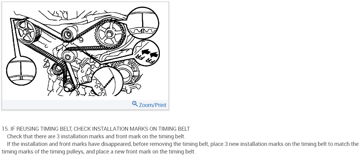

Yes, it is time to take the front back apart. It sounds like the timing belt is too tight. Here is a guide that will help and diagrams below to help get the job done. Check the idler pulleys as well.
https://www.2carpros.com/diagrams/toyota/avalon/2002
