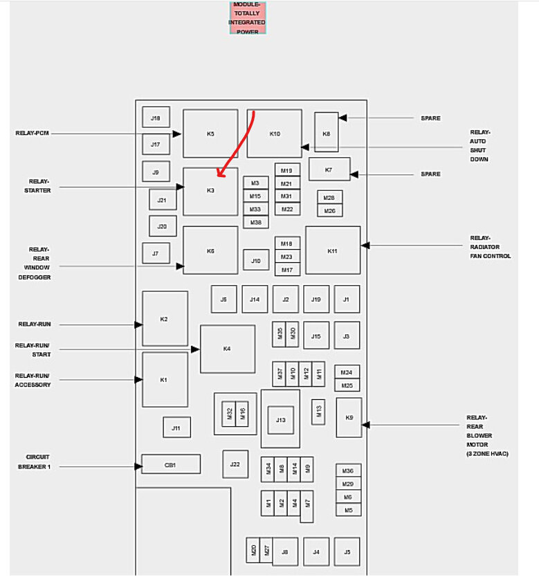

Car key does not engage the starter solenoid?
117,225 MILES • 3.8L • 6 CYL • 2WD • AUTOMATIC
MIKEYJ RANCOUR
I Have to jump start the starter motor to run vehicle.
Feb 4, 2025 at 2:22 AM
  • 55,748 POSTS
Can you try cranking the engine over in neutral? Do you have a security light flashing? We need more information on the problem, please go over this video to start us off:
https://youtu.be/6YRW8fyNudY?si=t6tTTAu07W2I3xwl

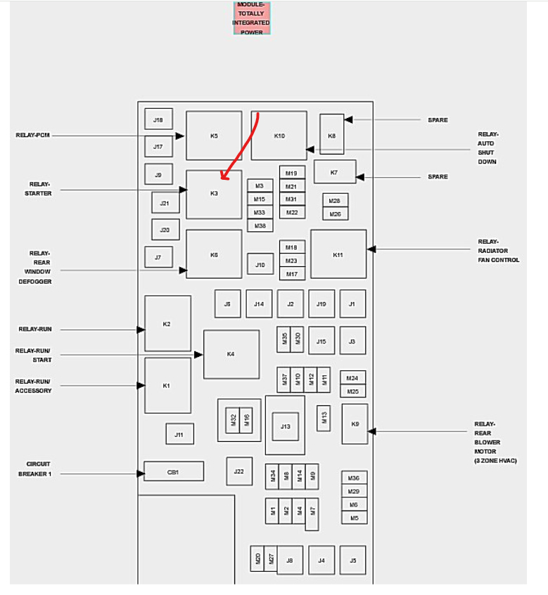

Here is the starter relay if you want to try swapping it out. Check out the images (below). Please let us know what happens.
Feb 4, 2025 at 9:24 AM
