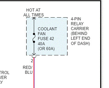

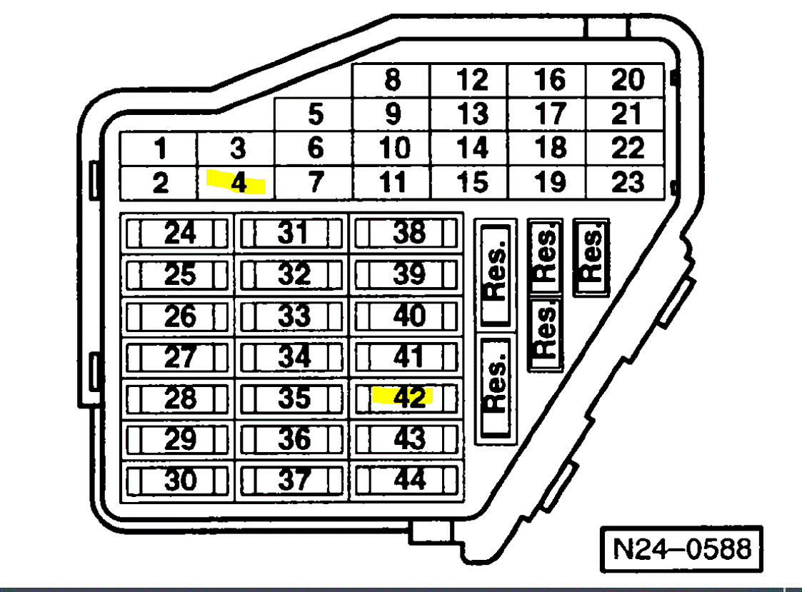

My car keeps shutting off and overheating. The car shuts off even when it's not overheating. Fuel pump and thermostat just replaced about a month ago. Also my fans don't seem to be working. I believe I checked the right fuse it's not broken heater and A/C are working fine.

As far as the cooling fan, when you turn the A/C on, it should turn on as well. Is that happening?
As far as the fuses, I need you to check two of them in the vehicle's fuse box behind the left side of the dash. See pic 2 for fuse and location. In addition to just checking the fuse condition, confirm there is power to it. Follow this link if needed.
Note: Pic 1 is from the wiring schematic showing one of the fuses for the cooling fan. IF you find a bad fuse, make sure to only replace it with the same amperage fuse that is in the vehicle now.
