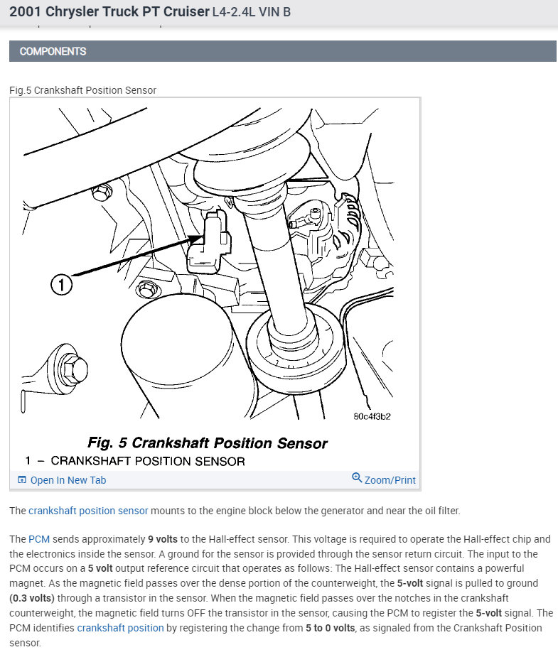

Car runs fine no check engine light. After just turning on the car and letting it run I turn on my AC and after about thirty seconds my car just turns off. I replaced fuel pump fans are working, put new cam shaft sensor. I just cannot figure out problem. Can you help?
Oct 6, 2018 at 1:56 PM
SQM
  • 6,383 POSTS

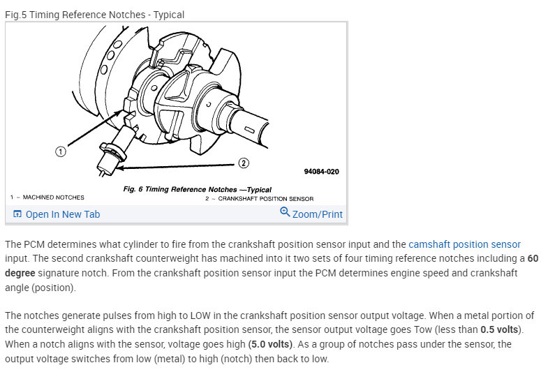

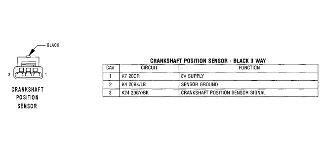

This sounds like the issue is a faulty crankshaft position sensor. A failing crank sensor can trigger the engine to shut down.
Over time all the heat and vibration from the engine and cause the crank sensor to lose calibration. This will make the sensor send error code to the ECM. Which can trigger the engine to shut down. It can happen at any random times.

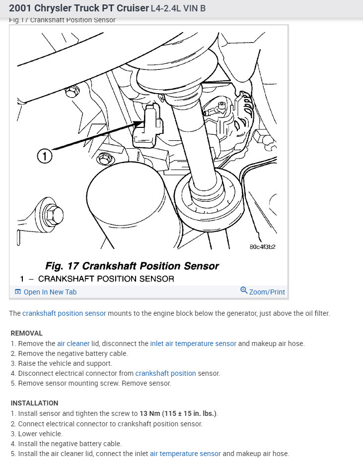

The crankshaft position sensor mounts to the engine block below the generator, just above the oil filter.
Here are couple of helpful articles:
