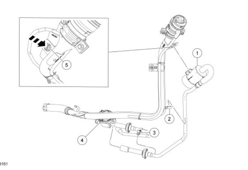

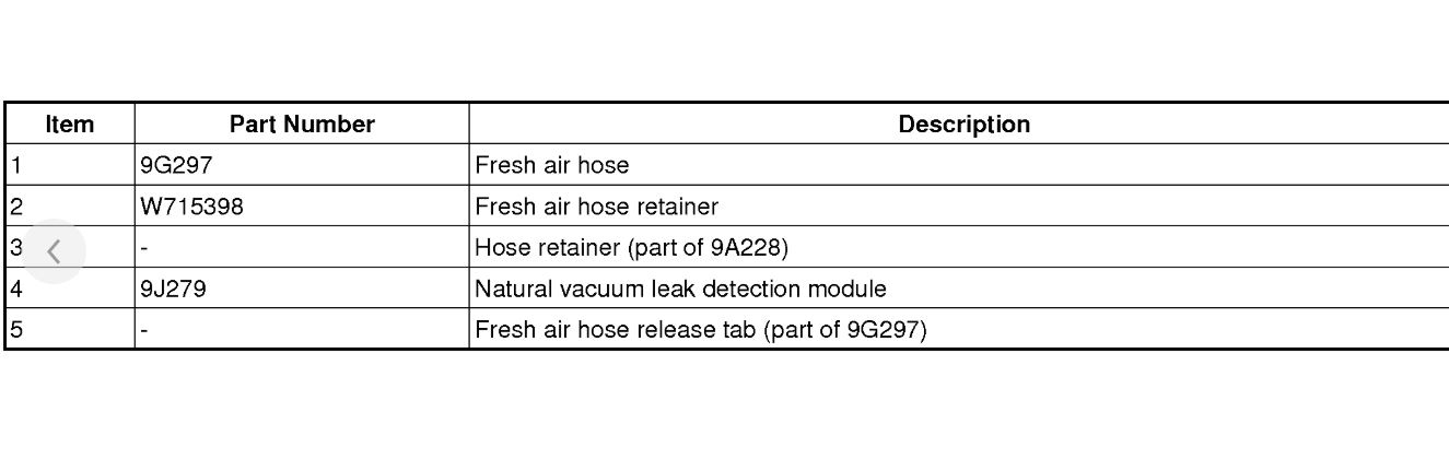

Every dollar something the car kicks the pump off. It takes forever to fill it up. it has the big black box behind tank don’t know if it’s it or something else tank has never been dropped.

This is an issue with the vent in the fuel tank. When the vent is stuck closed, it will not vent air to the atmosphere for fueling.
https://www.2carpros.com/articles/how-emission-control-systems-work
Are there any codes stored? If there is, I need the codes. You can have them read for free at a parts store.

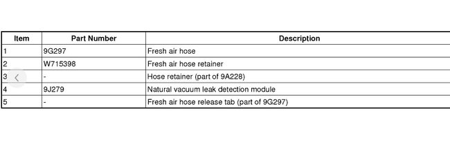

Okay, make sure the filler neck is clear and there are no obstructions in the line down to the tank.
Make sure the vent line in the diagram I sent you is clear as well.

Where’s the vent valve or vent solenoid at could it possibly be it or would it be the box?
May 31, 2020 at 12:11 AM
It is attached to the filler neck as in the diagram I sent you.
It may be stuck closed. It s a normally open valve and is only commanded closed when the system is doing its internal leak test.
