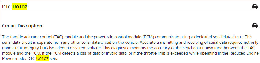

BRYANSWILIK SWILIK
Car will stall while driving, engine light not on, will re-start after several attempts, after I turn key and get nothing it always starts on next try? Cleaned ECM connections, throttle act control module connections, new battery (connections good). Cleaned throttle body, ran scan after it stalled, p0601, p0606, and u0107? I read the codes but, I know what they mean but I do not know where to go from here. Took it to two mechanics both said it would not give them any codes Cost me money for nothing. I would highly appreciate any help I can get, Thanks!
Aug 6, 2020 at 2:21 AM (Merged)
DANNY L
  • 5,648 POSTS
Hello, I'm Danny.
You might want to check PCM connections as well. The codes you provided are for the PCM losing communication between itself and the throttle actuator control. I've attached two pictures below.Hope this helps and thanks for using 2CarPros.
Danny-
BRYANSWILIK SWILIK
I completely removed the PCM and cleaned the connections with electrical cleaner. My problem is I can not afford to take my car to a garage and just give them a blank check. I know what the codes are, I am attempting to narrow it down by checking one thing at a time. Do I replace the PCM ? Is that the issue ? What made it go bad? When I purchased the car it only had 38,000 miles and is still under 75,000 and I always keep in garage. What do you suggest?
DANNY L
  • 5,648 POSTS
Hello again.
Were you able to check the wiring/communication from the PCM to the throttle actuator control using freeze frame data while driving the car or check the throttle actuator control data outputs? If you have access to a professional scanner you can check all parameters and data.As I stated before check communication from the PCM to the throttle actuator control using driveability/data.Hope this helps and thanks again for using 2CarPros.
Danny-
BRYANSWILIK SWILIK
No, I have not. In the past I replaced a few starters, alternator, brake pads, etc. I have zero experience with electrical issues in fact a few weeks ago was the first time I even held a scan tool and it was borrowed from a friend and it was a very inexpensive one. (Although it did pull up those codes I gave you.) Want I need is some educated guesses, some people say it might be a crankshaft position sensor, mass air flow sensor, fuel actuator sensor, bad PCM, and on and on! I am very poor and I don't have the cash to have a mechanic just start replacing parts. So far I mentioned what I did but I am going to try to explain exactly what it is doing : 1) It stalls, mostly when low idle. 2) Turn key several times but just cranks. 3) When I turn key and get nothing, no click, no sound, it always starts on next turn of key? I understand mechanics don't like to guess, please make acception.
BRYANSWILIK SWILIK
I had a used PCM installed it fixed it!
