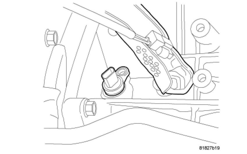

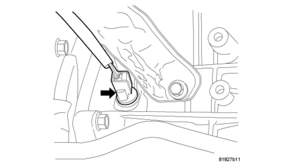

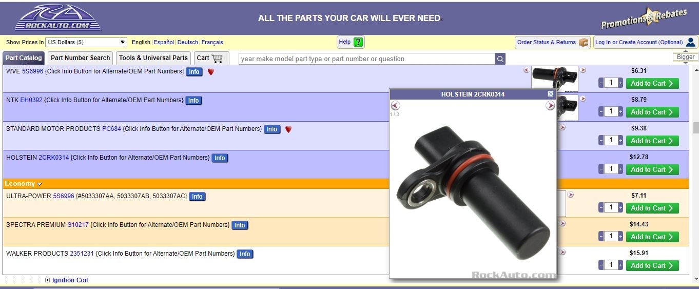

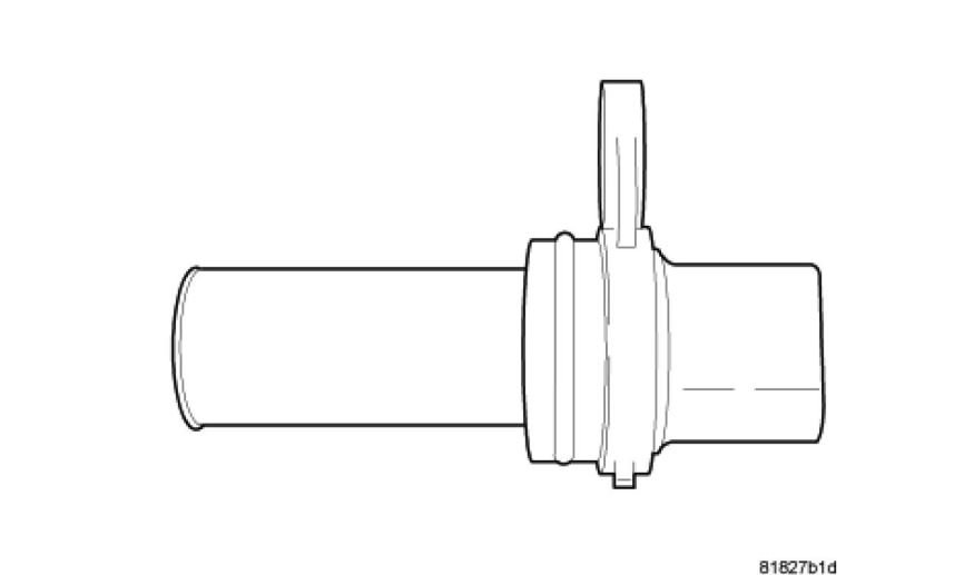

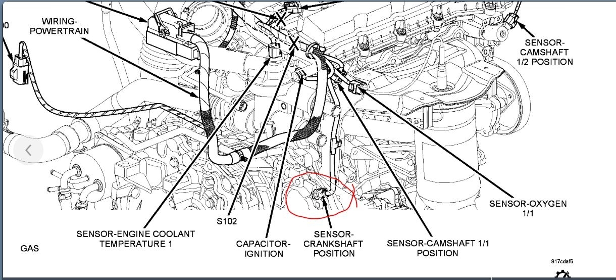

The crank sensor is a common failure for this issue but should be checked with a scan tool for the proper signal.
2.0/2.4L
The Crankshaft Position Sensor is in the rear of the engine block near the transmission.
If vehicle is All Wheel Drive the Power Transfer Unit must be removed.
1. Disconnect the negative battery cable.
2. Raise vehicle and support.
3. Remove heat shield retaining bolt.
4. Remove heat shield.
5. Unlock and disconnect the electrical connector to the crankshaft position sensor.
6. Remove the crankshaft position sensor bolt.
7. Remove the sensor.
