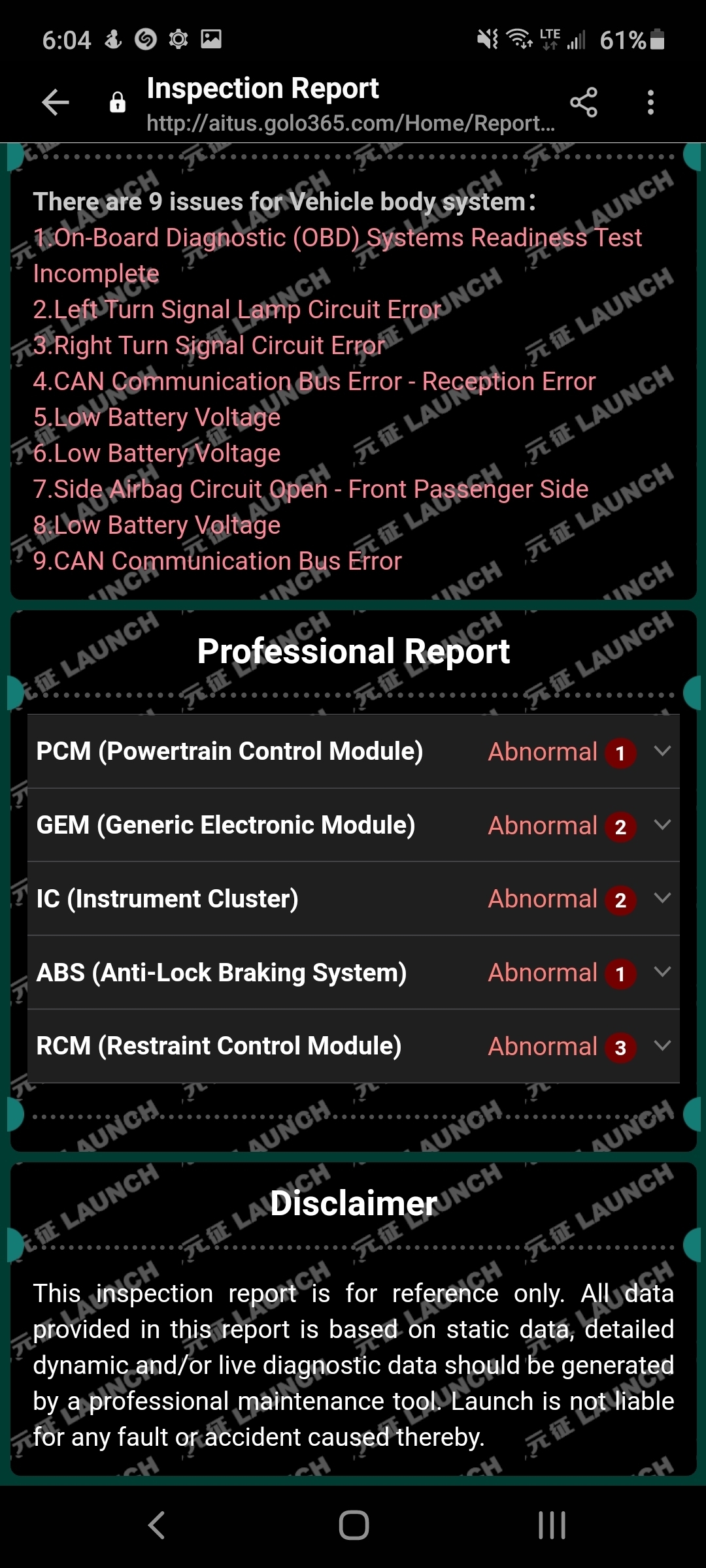

The battery in my car listed above is new and charged. when I get in it to drive it it drives just fine for a while and then the ABS light comes on the emission light comes on and the brake light comes on and all of a sudden the radio shuts off. I lose my speedometer goes to zero, my gas gauge goes to zero, my lights get dim and then the car just shuts off. But the very first thing it does is the radio will shut off and when I go to turn the radio back on it says low voltage then all of a sudden the radio will come back on and then everything happens.

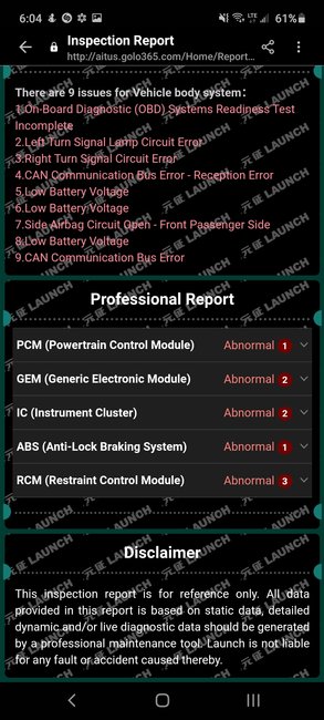

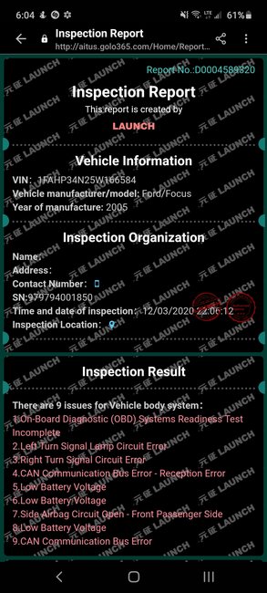

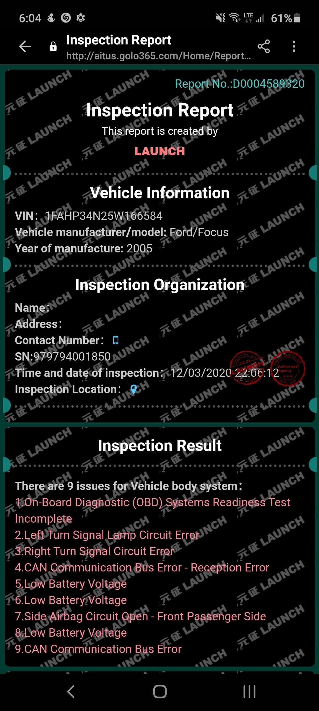

I read that over with my fiancé and he asked me to send this to you . this is what the diagnostic launch report said.

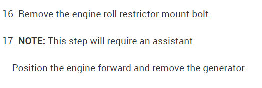

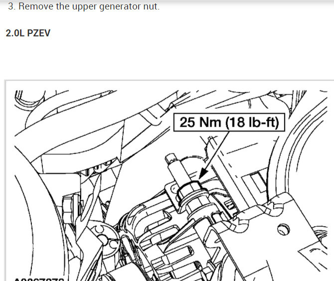

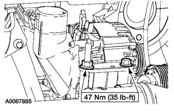

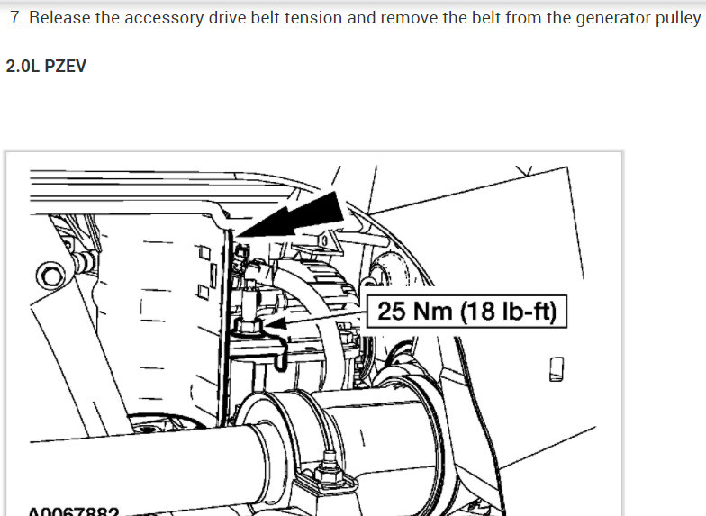

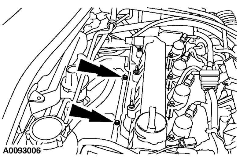

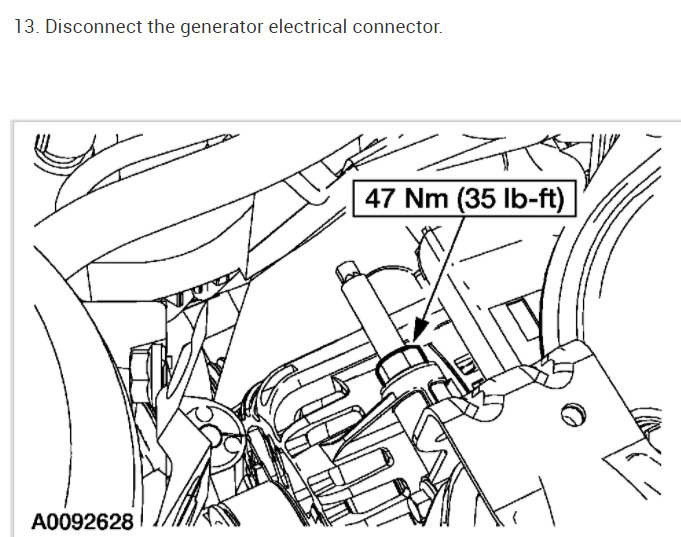

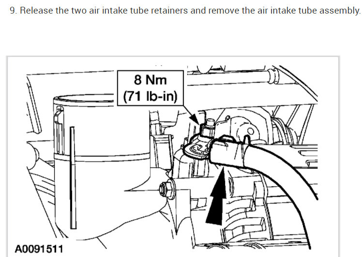

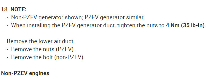

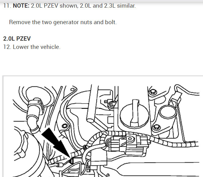

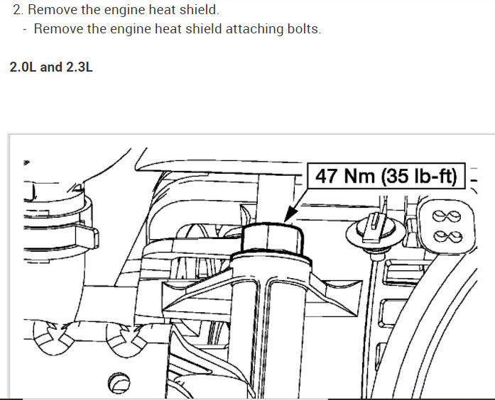

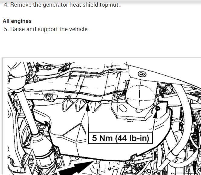

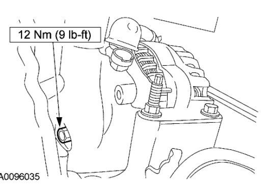

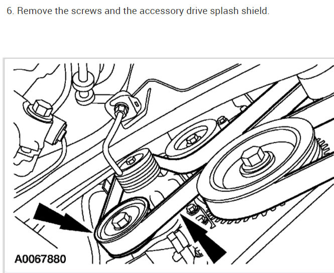

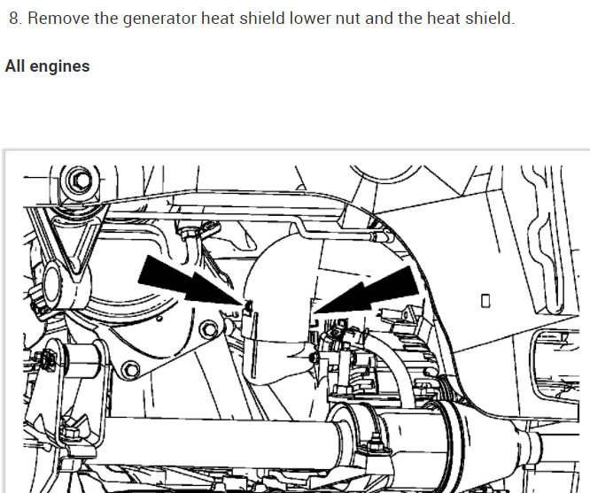

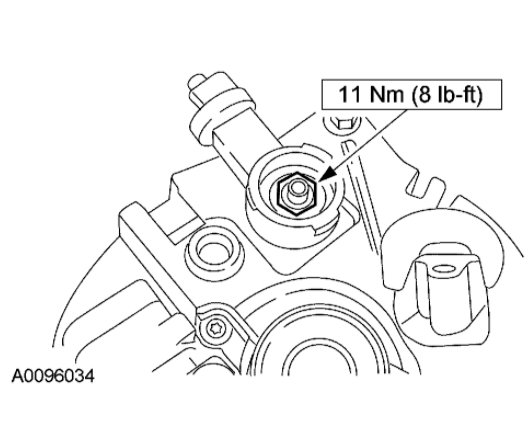

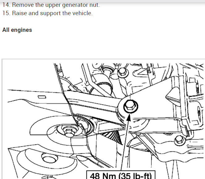

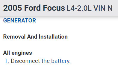

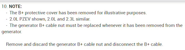

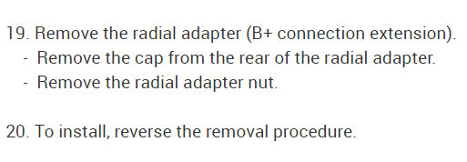

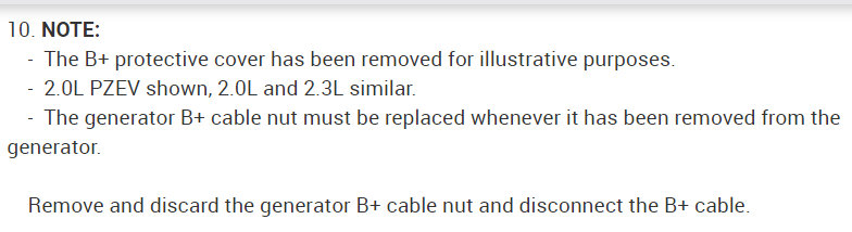

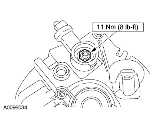

Just to jump in here. The first thing you need to do is have the alternator tested. It sounds like the alternator is weak or failing and not properly charging the battery. The other small issues can wait but you need to have a reliable car that won't leave you stranded. Auto parts stores will test your alternator for free when you bring it to them. I've attached picture steps below on how to remove and replace the alternator on your Focus. Hope this helps and thanks for using 2CarPros.

You can have the charging system tested without removing the alternator if you can get it to a nearby shop or parts store that has a VAT-40 or 45 preferably. All of the codes you presented can be generated by a low voltage condition, but needs to be verified by a qualified technician before you go and spend money on parts, just my opinion because I have had customers that finally bring me their vehicles after they have spent too much money on an un-repaired vehicle.

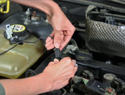

One more question. would a radio suppression capacitor have anything to do with it?

The radio suppression capacitor that I think you are talking about can and will cause a no start condition, but will not cause a loss of voltage and the symptoms that you have had. The ground wire will pull right out of the capacitor. bad design for sure!
