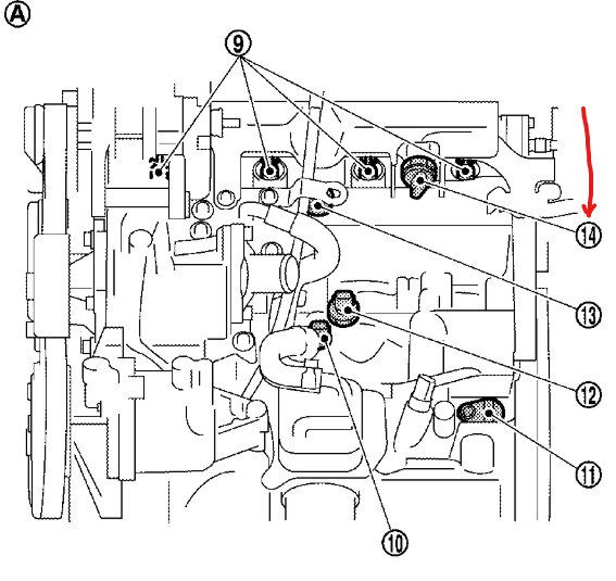

Hello there, any help would be great. my car just lost power last Friday then just wouldn’t start again was stranded for 5 hours until aa turned up I put my OBD scanner on it while I was waiting and had code P0087 Code: Fuel Rail/System Pressure Too Low tried starting it multiple times but no joy and also AA tried as well still no joy so I was recovered to my home address. Now my friends garage come and took it yesterday and I’ve spoken to him this morning and he started it first time and also said it didn’t need towing as it started for him but I also tried every day until Wednesday as it wouldn’t start and I have also tried it up his garage this morning and it starts first time so I baffled as to what it could be and to honest so was he so I’m just wondering if anyone has any idea what could be causing this please.

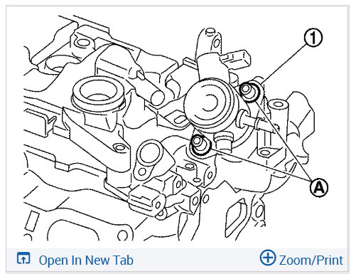

The P0087 Code is the clue, I have seen the high-pressure fuel pump go out as well as the low-pressure lift pump inside the tank, when you turn the system on (not cranking) do you hear both the fuel pump come on for about five seconds? If so, I would lean towards the high-pressure fuel pump or the fuel pressure sensor in the fuel rail. I have seen both can cause this problem, this is why the dealer will replace both when having this issue. Check out the images (below). Let us know how it goes.

Oh ya, my bad, I deal with so many questions. It is the fuel issue. I would try the sensor first and then if you hear the fuel pump run in the tank it is pointing towards the high-pressure pump.

Yep, lean towards the sensor or pump. That is what I would do.
