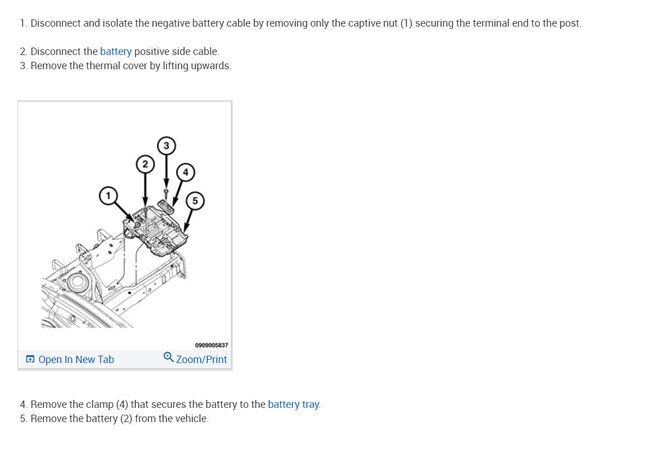

car just shut off, lost power to dash and fuse box?
Dec 14, 2022 at 5:17 PM
  • 55,694 POSTS

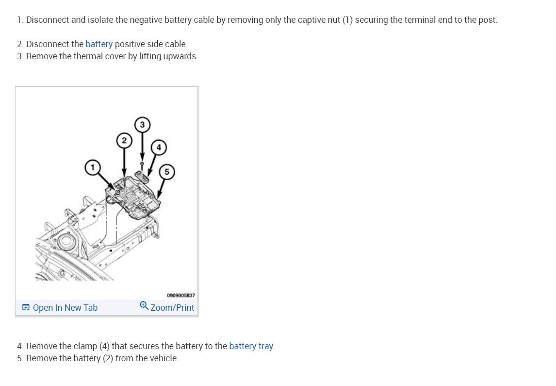

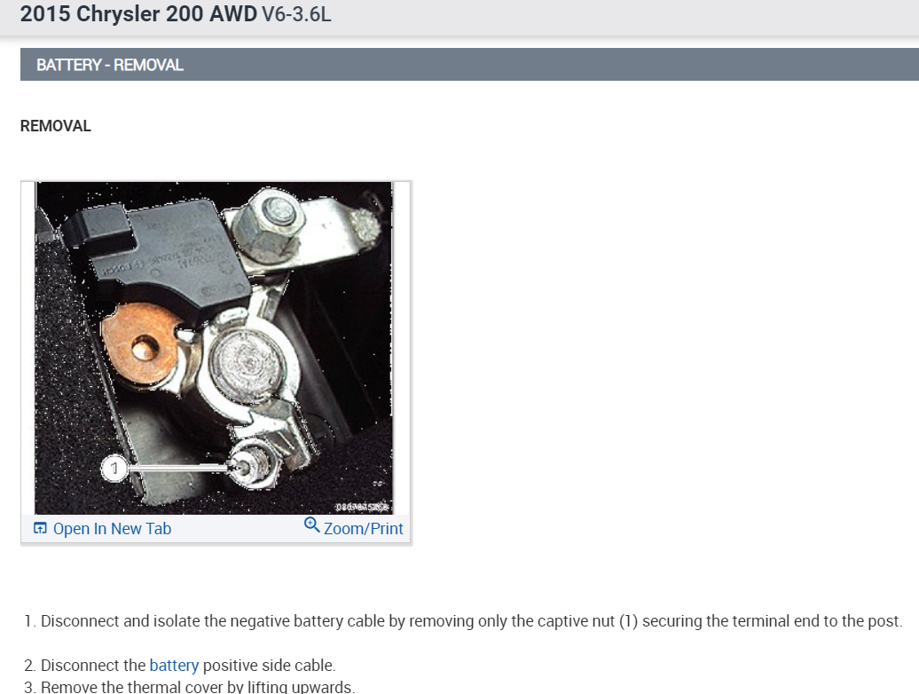

It sounds like the battery shorted internally, I would try to turn the headlight on if they don't come on or are very dim replace the battery with a new unit. This guide will help you step by step with instructions in the diagrams below to show you how on your car:
https://www.2carpros.com/articles/how-to-replace-a-car-battery
