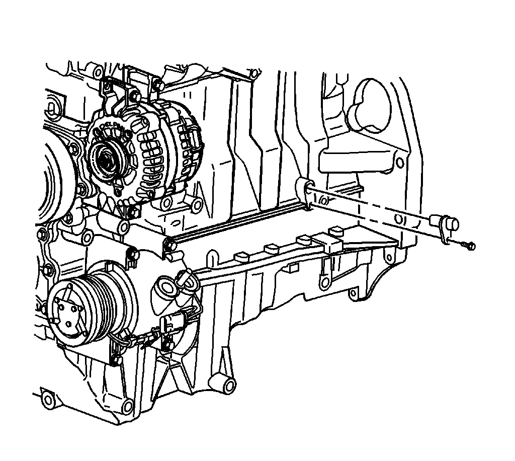

This car has been a great vehicle, virtually no problems outside oil changes and brake changes, and tune ups. Lately while driving the engine will "cut off" and sometimes I can catch it and stomp the gas pedal and it'll revive itself. At idle, it will just shut off, randomly. Oil level is good, no engine light.
I have a hunch it has something to do with the throttle position sensor.
Any ideas?

When this happens, do you ever have to wait for the engine to cool a bit before it will restart? If so, my first suspect is the crankshaft position sensor. When they start going bad, they are affected by heat, which causes them to fail until they have a chance to cool a bit. Interestingly, often times, they will not set a code which in turn, doesn't set the check engine light to come on. On the other hand, a throttle position sensor usually will set the check engine light to come on.
Take a look through these links and let me know if anything mirrors what you experience. The second link will discuss symptoms.
https://www.2carpros.com/articles/how-a-crank-shaft-angle-sensor-works

If you find the sensor is the issue, here are the directions specific to your vehicle for replacement. The attached pictures correlate with the directions.
CRANKSHAFT POSITION (CKP) SENSOR REPLACEMENT
REMOVAL PROCEDURE
1. Raise and support the vehicle. Refer to Vehicle Lifting.
pic 1
2. Disconnect the crankshaft position (CKP) sensor harness connector.
3. Remove the CKP sensor retaining bolt.
4. Remove the CKP sensor from the engine block.
INSTALLATION PROCEDURE
IMPORTANT: Inspect the sensor O-ring for the following conditions:
- Any wear
- Any cracks
- Any leakage
Replace the O-ring if necessary. Lubricate the new 0-ring with engine oil before installation.
pic 1
1. Install the CKP sensor into the engine block.
NOTE: Refer to Fastener Notice in Service Precautions.
Tighten the bolt to 10 N.m (89 lb in).
2. Install the CKP sensor retaining bolt.
3. Connect the CKP sensor harness connector.
4. Lower the vehicle.
5. Perform the CKP System Variation Learn Procedure. See: Vehicle > Programming and Relearning

It sounds like it regarding stalling at idle, but also I felt it while driving. And usually it starts right back up. Sometimes, the car will lock the key in the ignition and i'll have to jiggle the steering wheel to let me start it again

Chances are it is related to the sensor. The only way to be sure is by using what is called a live data scanner. With that, you can see if spark is lost as a result of a bad sensor or what is called freeze frame data can be reviewed to see what happened.
I have a feeling that is the issue, but can't be 100% sure without testing with the scanner.
