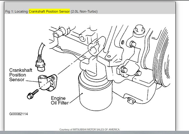

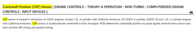

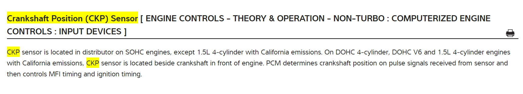

SCGRANTURISMO
  • 4,897 POSTS
Hello again,
Okay, this could be a problem with your vehicle's Crankshaft Position Sensor (CKP). It makes pulse signals from reading a wheel on your vehicle's crankshaft and sends this information to your vehicle's Power-train Control Module (PCM), which in turn, uses this information for turning on your vehicle's fuel injectors and spark plugs. Without the signal from the CKP your engine will not run. In the diagrams down below I have included your vehicle's CKP operation explanation and location. Please go through these guides and get back to us with what you are able to find out.
Thanks,
Alex
2CarPros
Jul 12, 2019 at 7:52 AM
BRAZOS SMITH
Okay, I have now replaced the crankshaft sensor and the fuel pressure regulator and it is still not starting. Also have replaced battery along with plugs and wires. Really at a loss at this point. Any help would be greatly appreciated.

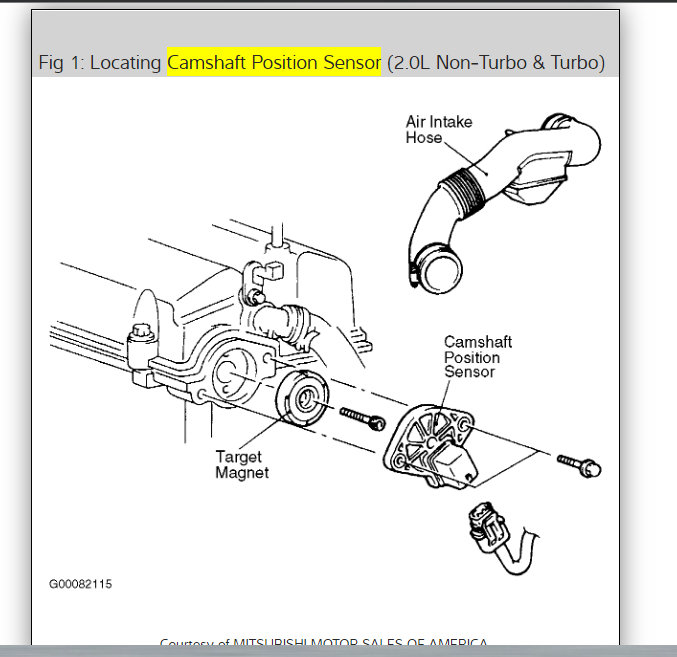

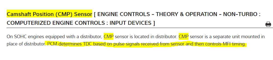

SCGRANTURISMO
  • 4,897 POSTS
Hello again,
Okay, in the diagrams down below I have included the description of what your vehicle's Camshaft Position does. Let's try replacing this sensor and get back to us with how it turns out, please.
Thanks,
Alex
