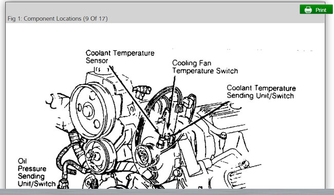

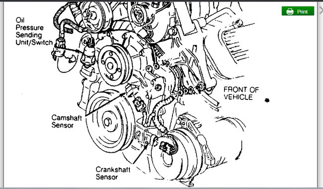

This could be a problem with your vehicle's Crankshaft Position Sensor (CKP) having failed. Your vehicle's Power-train Control Module (PCM) uses the signal from the CKP to determine if the crankshaft is rotating, how fast it is rotating and uses this information for crankshaft rpm's and for misfire monitoring. If it is not getting a signal from the CKP it won't know that your engine is turning over and wont start it.
I have included a diagram of the CKP location in the diagrams down below. Also, I have included a few links below for you to go to below.
